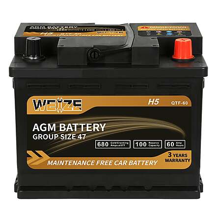

Speaking of the Weize batteries.. even cheaper direct:
Thanks for your post. I bought one of their Group 47 size AGM, and it fit in the space of the 80UD battery something or other in my MX5200. I had to relocate the ground cable from one side of the battery to the other side, but it was a pretty easy swap.
   / "AGM Car" batteries for less used tractors? #104
Ya, like I said, I bought an H8 for the F150 in Dec last year and so far, so good..Thing sat for like 6 weeks or so after the install and still started up faster than ever even though the temps were close to zero.

I have a pair of Kubota tractors that don't get frequent use so, now that their batteries are at the "end of life", I am thinking about replacements. I know vibration from the motor and field can knock the plates over in car batteries and kill them, so, I was thinking about AGM options on the cheap side that don't suffer this problem and have low 'self discharge rates' as well, which is nice.
AGM batteries from Sam's Club (Duracell) or Walmart (Everstart) run ~$200 so, not necessarily the cheapest option. Local farm stores want a lot more than that, though, so, perhaps I need to shop real tractor batteries somewhere else like at a Construction Machinery dealer.
The engines in question are small Kubota options.
TIA,
Sid
I have a John Deere 620 that is basically used for a log splitter. I might run it 3 times a year. I put in an AGM battery out of my race car and it started after 6 months. The 620 originally came with 2 batteries and I previously replaced the JD generator with a one wire alternator. I know the Purists hate me for it, but I'm 70 and can't afford to change batteries all the time
