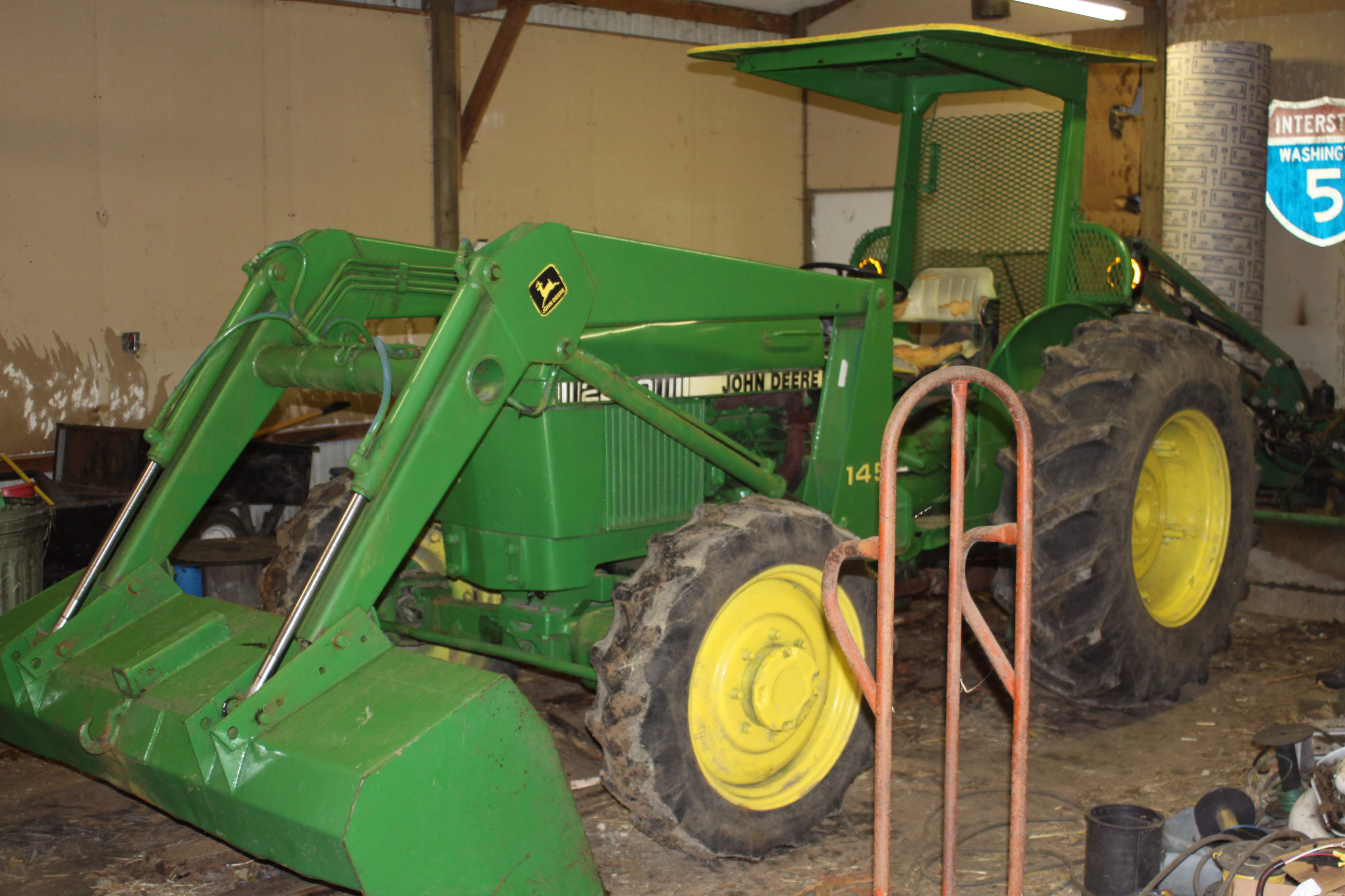

The portion of the bar in the center of the tire should contact the ground before the outer edge when going forward. Note picture. It will not hurt the tires to have them backwards, but will adversely affect traction. The easiest fix would be to swap sides with the tires... IE: take left rear and put on right rear, etc.

That's why I gave the pic of my tractor.

Those rears are on right. Looks like the fronts could go either way about the same. ;)

And was nice of you to post the pic of yours, at least.
The pic of the OP's would have been helpful too, but I suspect the OP has the info he needs to be satisfied his treads are correct (or not :) )

I started trying to explain it and then decided it would be less confusing just to post a picture. The old saying that a picture is worth a thousand words. LOL
