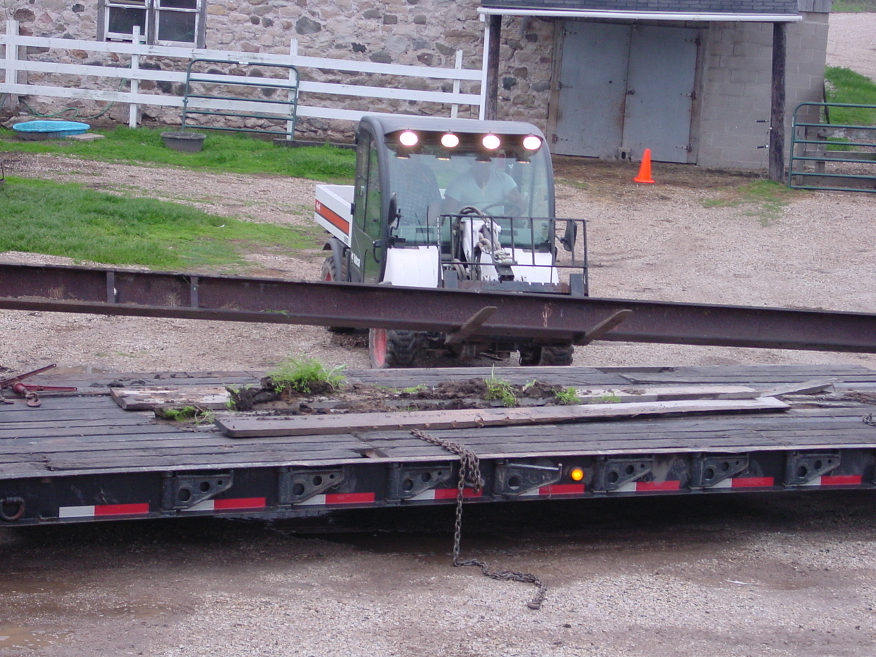

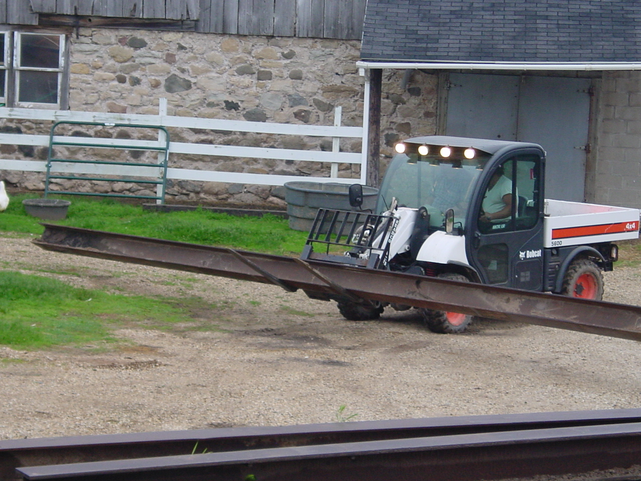

I have had my 'A' series for 3-4 years and have been seriously happy with it doing Farm related tasks.
Attached are a couple of pictures moving 30' long, 2000# steel beams. I have pictures of loading manure and moving large hay bales as well if you like.

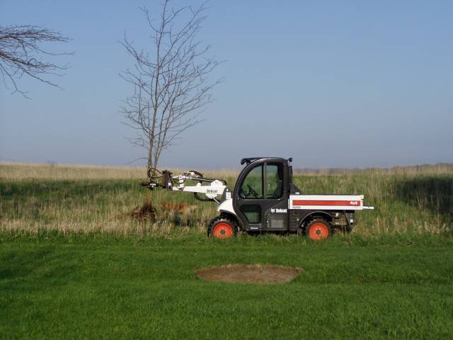

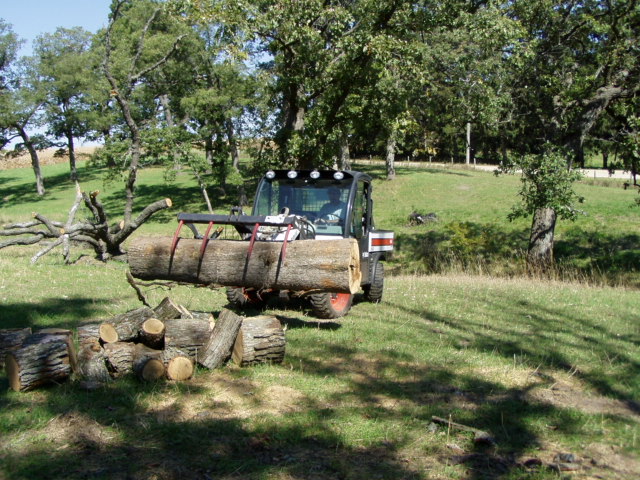

I've loaded round bales on a gooseneck with no ballast in the back. Not sure what they weighed but they were not huge. I did pick up a huge one once that was covered with snow and the rear wheels were bouncing off the ground as I moved it into the feed lot. I didn't attempt to lift that one into the feeder. I wouldn't use it to move the bales out of the field. Seems like too much stress bouncing around.
Attached is a picture loading an oak log with the grapple and one with the tree/post puller I built holding a thorny honey locust.

I need a thorny honey locust tree remover too!
