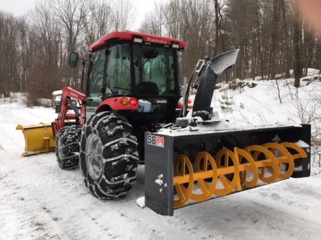

If you're looking for a good snowblower at a great price then check out WoodMaxx.com. They were among the best built when I was looking. Mine has hydraulic rotation and a hydraulic deflector but they also offer electric if you don't have the extra hydraulic remotes on the tractor.

I'm getting some rear spools so I can run hydraulics for a blower. I will check those ones out.
I have been through your plow thread and was very impressed. I can't weld though (no equipment and never tried) and am trying to figure out a way to get a set up like yours or even mounted to the tractor frame if I took off the loader. Any suggestions on where a guy like me who can't build their own might get lucky? My neighbor is a welder but I just moved in and don't really know him, he would probably do something for me if I paid I would think though.
