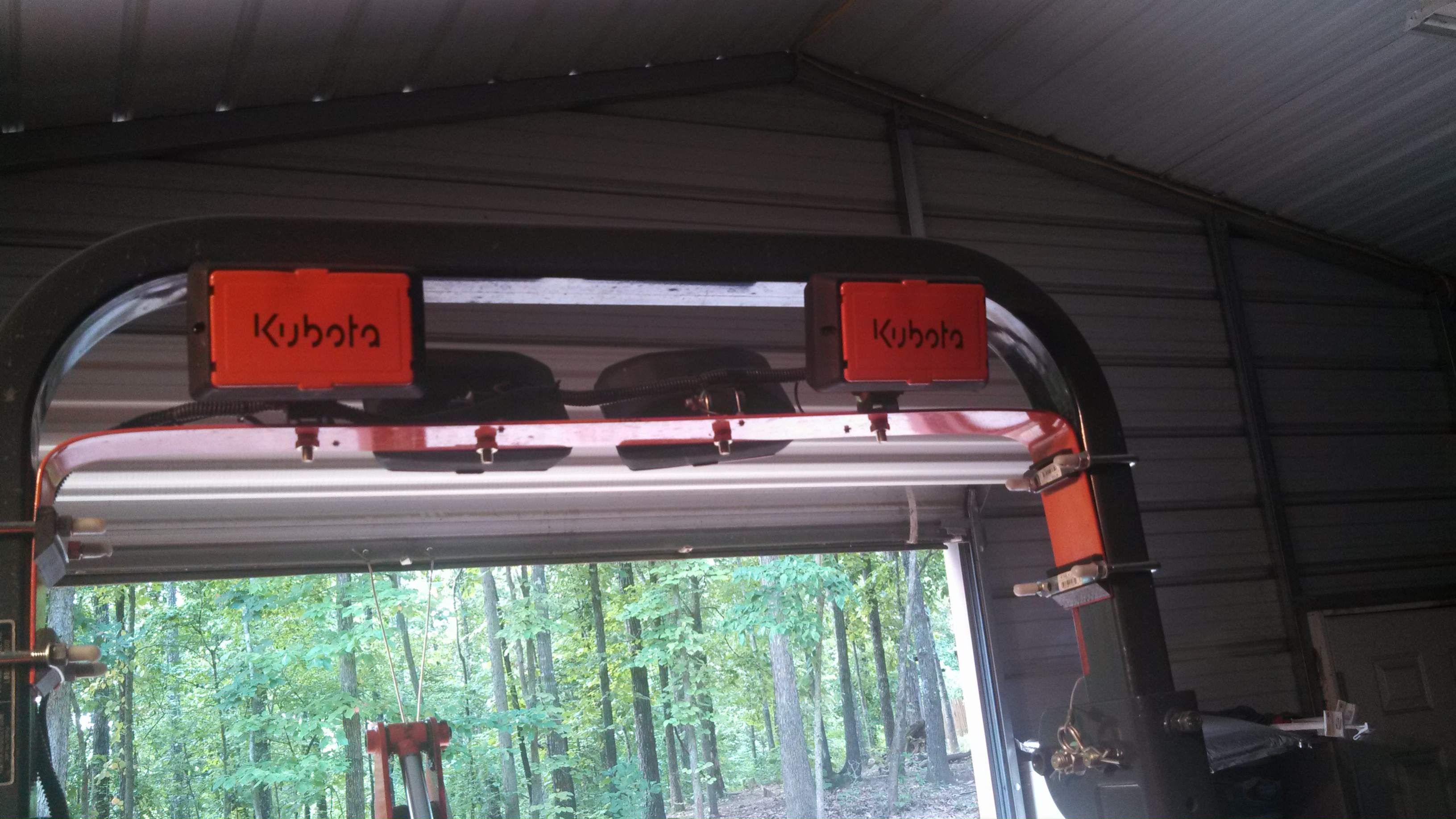

I know this isn't a BX model, but I thought you might want to see the 55 watt Halogen lights I put on my L3200 rops. I ran them on a separate circuit from the battery with in-line fuse, and have had no problems with them. There are two to the rear and two to the front. They produce plenty of light, but as mentioned by several TBN members here, if you want less power consumption go led, but for me the cost was way too high to justify that....maybe later! Just thought this might give you an Idea of what you could do on a BX rops like I did on my L3200.

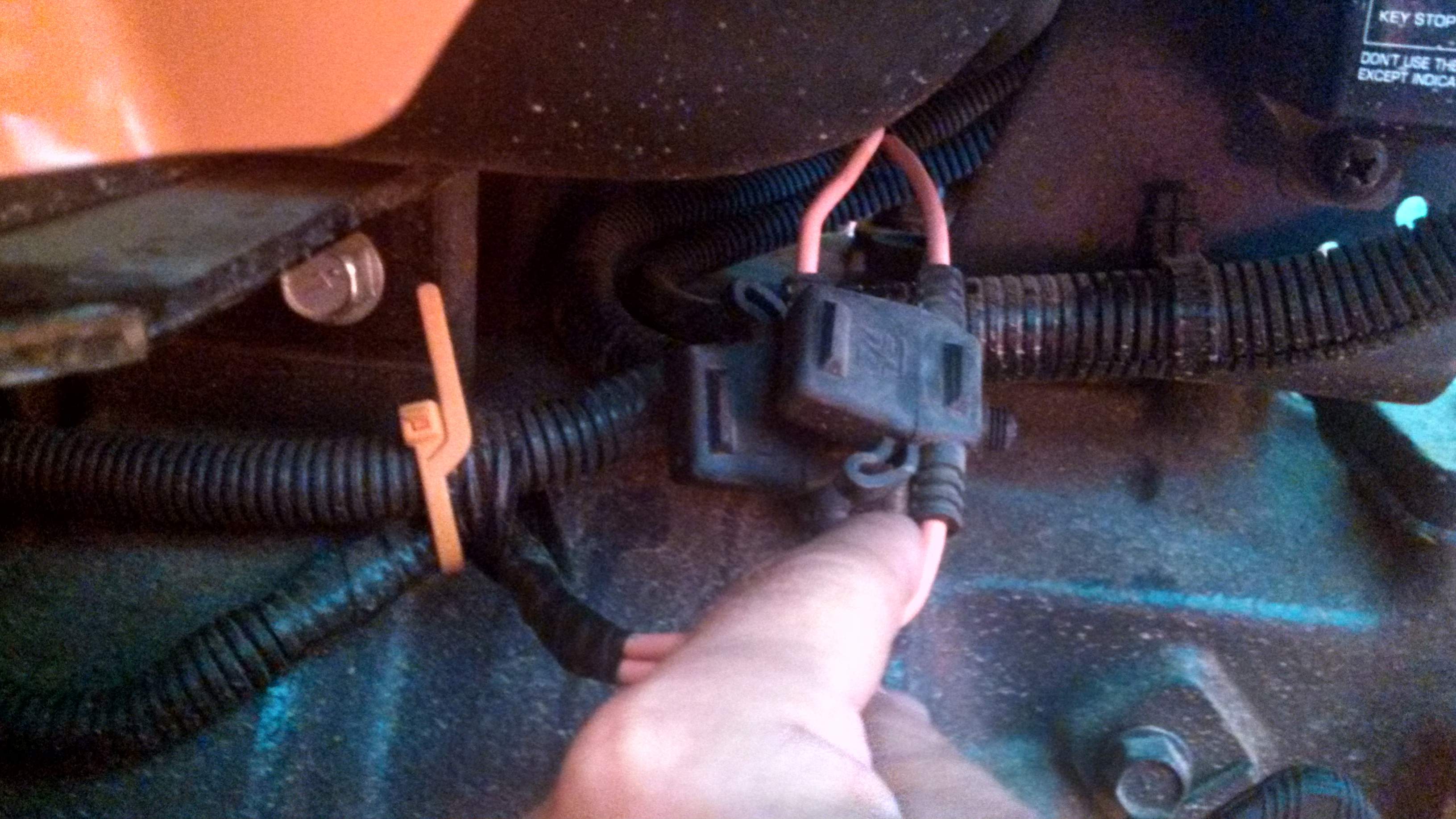

Thanks DEK.....to be honest I haven't done the math on the amps. Had a friend (electrician) advise me on how to wire the 4 Halogens. All 4 can run at the same time with no problem, however the front pair are on their own circuit, and the rear pair are on their own circuit. I have a front switch and a rear switch, both can be used at the same time. I placed an in-line fuse between the battery and the switch on both with a weather proof fuse cover. Maybe someone on here can educate me on the math for all 4 running at the same time. All I know is they work perfectly and no problems. Been running them for about 1 year now.:smurf:

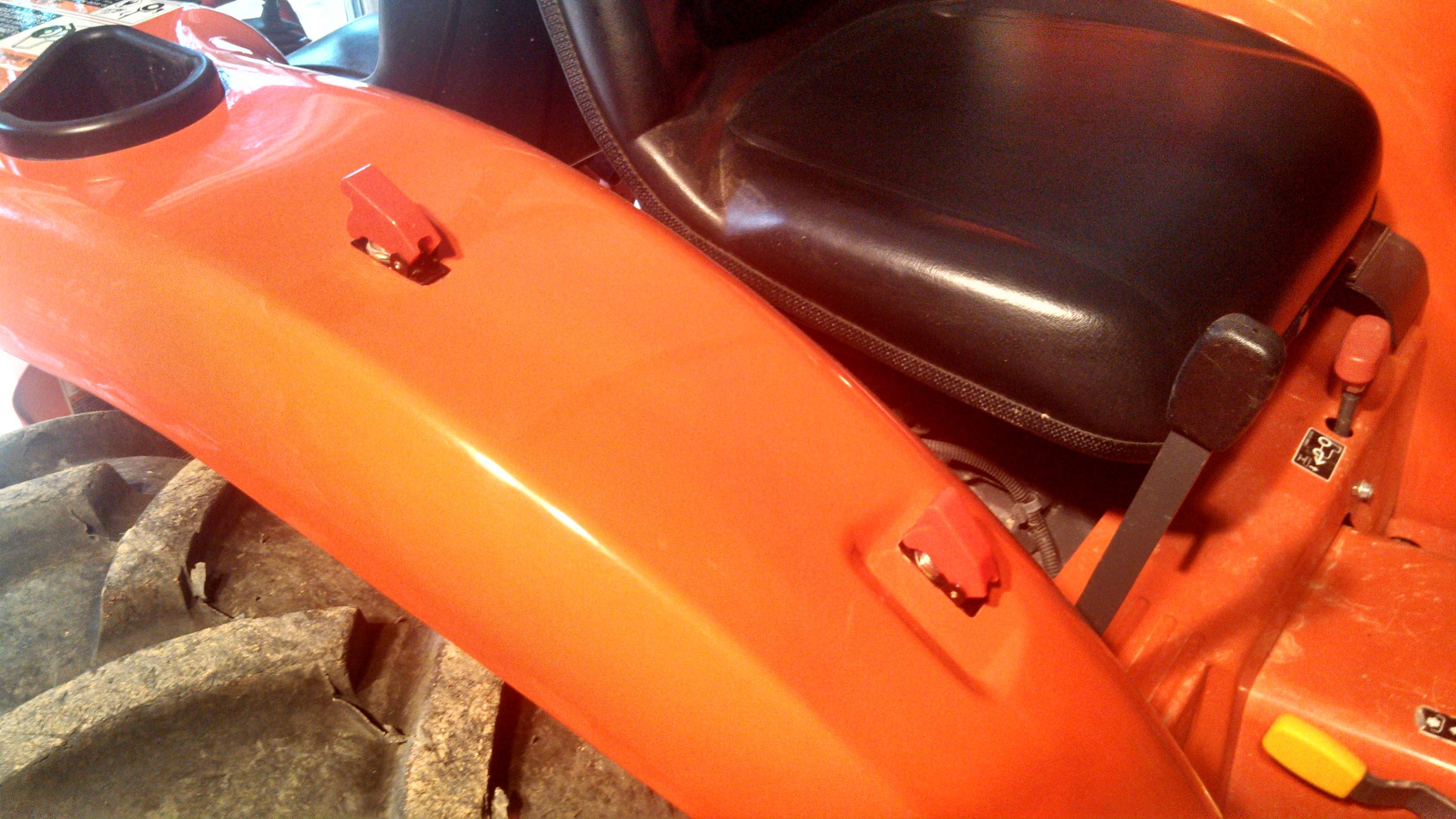

Here are pictures of what I did. The lens covers I custom made (painted Kubota orange, then had small Kubota vinyl letters made), and the switches fit perfectly in the holes already drilled by the factory for an optional right handle. Also, the bar holding the lights is NOT drilled into the ROPS (this would void the warranty)....instead, I fastened them with u-bolts to the rops, then capped the excess bolt threats with plastic caps to avoid bumping your head and cutting yourself. I also included a picture of the in line fusable links located onder the dash cluster for extra protection.:smurf:

You've done a fine job with those lights. Everything you did looks nicely done - from the painted and curved mounting bracket, to the secured and shielded wiring, and to the fuses and switches. Well done! If necessary, are you able to fold the ROPS without removing the lights? Switches look like they have a security cover to prevent accidentally turning them on. Good idea. Are they weatherproof switches? I have purchased and mounted a grab handle on my right fender using the predrilled holes. I will have to come up with a different place for the switches. I'm not real keen on drilling holes on the tractor unless absolutely necessary. The light covers you fabricated are a nice touch. Anyhow, good installation and thanks for the info and pictures.

Thanks again for compliments! The ROPS will fold down. I left enough slack in the wiring to allow that. The switches are waterproof, but I still added a little "liquid electrical sealant" to the bottom where the wires are connected. I know what you mean about drilling too...I cringed at the thought, but then found those holes for the handle option and they were the exact size! My alternate Idea was to fabricate a metal mount, paint it and then attach it to the tractor somehow, but didn't do much thinking on that after I found the factory holes. Thanks again and let me know how yours turns out and how you did it. If you need more pics or idea's off of mine just let me know.

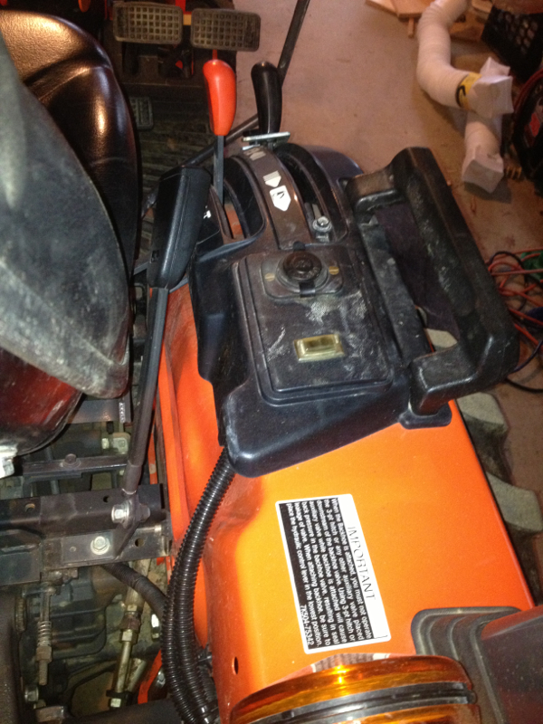

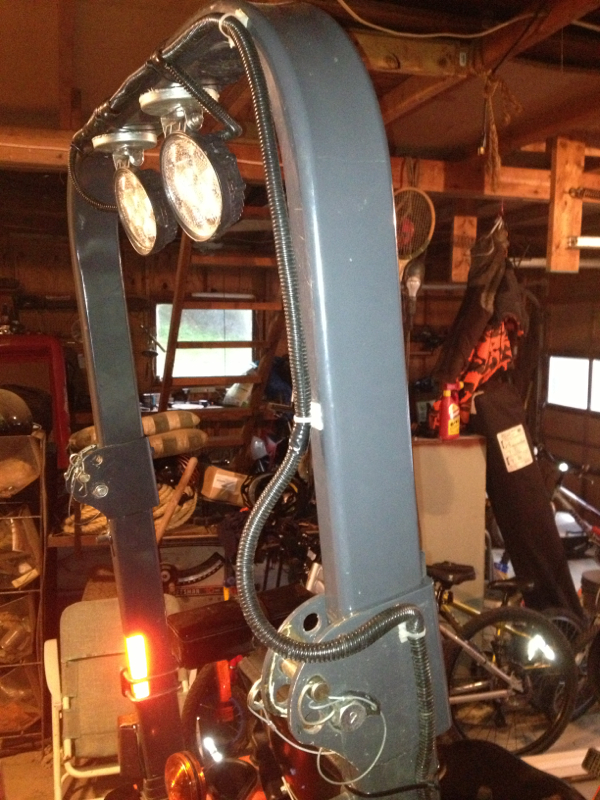

Well since it is that time of the year when it's dark after I get home I went out and installed some lights. I did wire the lights to the battery with a inline fuse.
