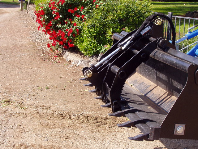

Have a front end loader on my bx2370. I'm looking for something I can make to help me pick up brush piles with larger sticks and such. I know they probably make attachments for this. Any thoughts from those who have "home made" solutions? Thanks

What you need is a grapple(a light one) ,are you capable of building?I believe Everythingattachments.com recently introduced a small grapple.I put a Green's Machine Thumb on my bucket and that works well.Some people use "forks" for brush that may be better than just the bucket.

I augmented my FEL with clamp on pallet forks from Pallet forks/Titan .com . I needed pallet forks for a number of things. Using the pallet forks, and sometimes a chain wrapped around the load, is a partial low cost solution to a grapple.
Look on here and you'll find some guys just lay out a few 2x4's for a jury rigged set of pallet forks.

I like the idea of a grapple but just don't want to sink the cash in right now. Possible for bucket forks? Hmmm..

What about a landscape rake? Turn it around and push the pile with the rake. Or use the loader for the big stuff and follow through with rake from behind. Rakes are really versatile implements.

I thought about the clamp forks but worry about them spreading out and not working well. I would definitely like something I could attach to the bucket but I'm also on a tight leash from the mrs since buying the tractor recently! Lol

There are clamp-ons that join in the middle to prevent spreading. Or you could easily rig up something to do that.

With any tractor with a FEL and you're gathering brush for seasonal disposal or several heavy loads , I used to use either a rope or chain with a pair of FEL pallet forks fastened to the bucket and gather up the debris-what a PITA- off the tractor, on the tractor, chain/rope snag, load shift, cut/bleeding arms etc. BUY A GRAPPLE AND NEVER LOOK BACK-wise investment for your use now and if you ever decide to sell. Hydraulics rule.
