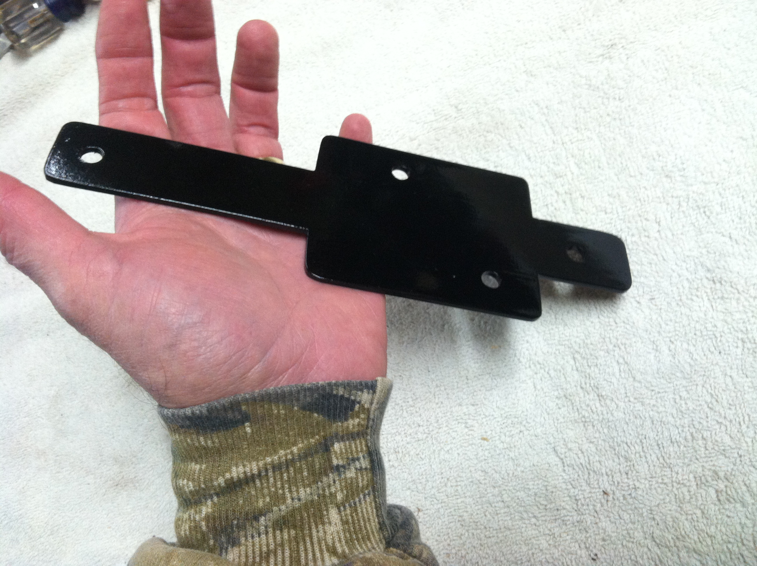

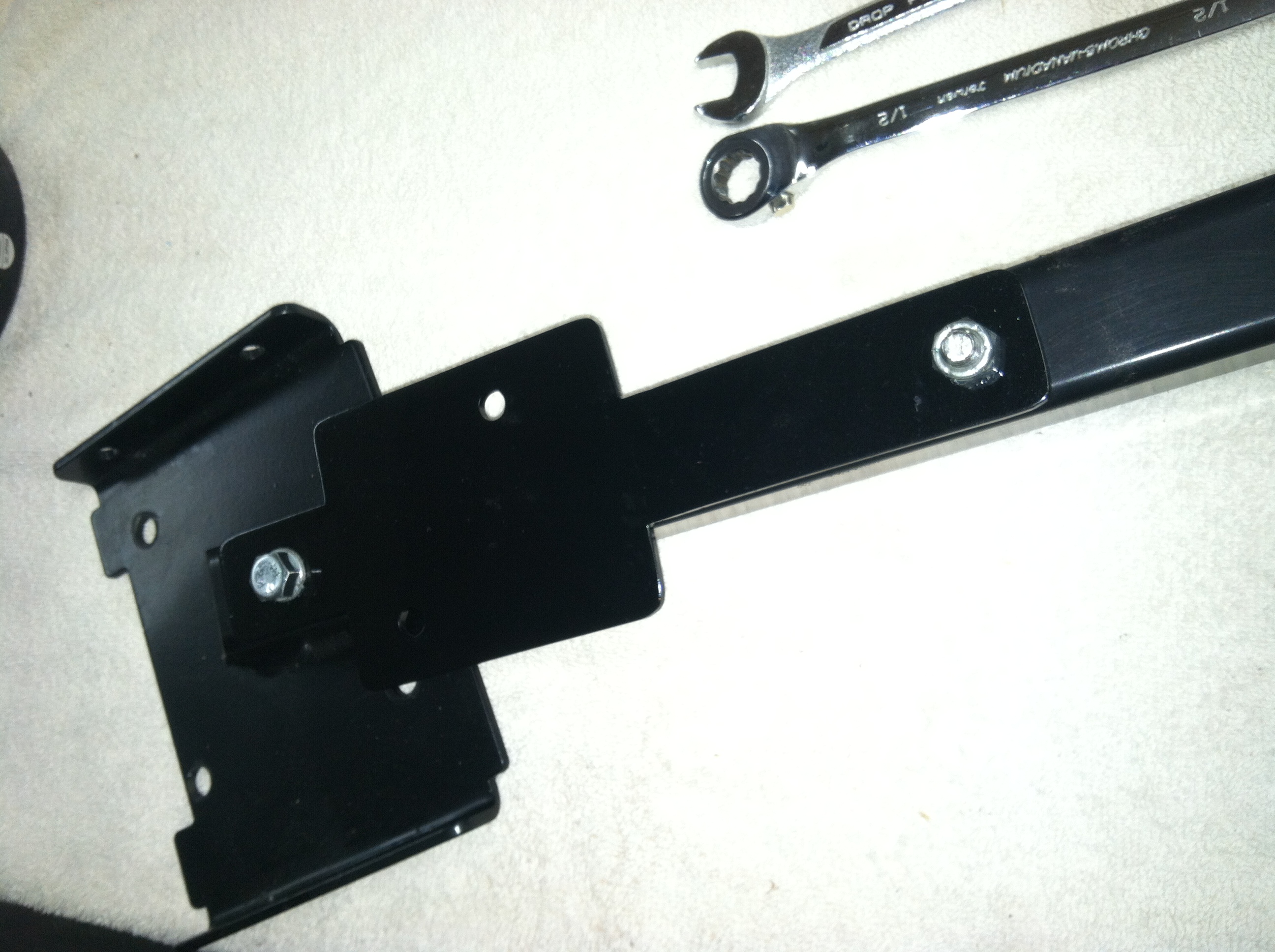

So, some progress has been made... I was at our place where the tractor lives last weekend, so I was able to figure out the best place to mount the diverter valve. I don't have all my tools there, so I dismantled the support that holds the loader valve and brought it home to work on the mount. I am mounting it under and slightly rear of the existing valve.
I had some 3" wide 1/8" flat bar, so I went at it with a sawzall, file, and grinder. Then drill some holes and add a little black paint.
And mounted it on the support member I brought home to work on.
I still have questions in my head... I am new to this hydraulics game. I am pretty sure that the existing hoses on the curl circuit will reach the new diverter just fine. Hopefully, I can figure out any adaptors I need to buy. The holes in the diverter are 8SAE, but I do not know what the hose ends are. I am also trying to figure out how to mount the quick connect ends of the grapple lid hoses. I think I could mount some kind of a plate to the driver's side loader arm, (yes I know the tractor does not have a passenger side). Here is a picture...
My problem with that is where do I get such a mounting plate, and how to attach it? I do not weld... I can drill, but I am not sure if that is the best idea. I have seen posts on TBN by a guy who used some type of a disc with a stud extending off that he epoxied to clean metal on his tractor. Does anyone remember that guy's name or what that product is called?
