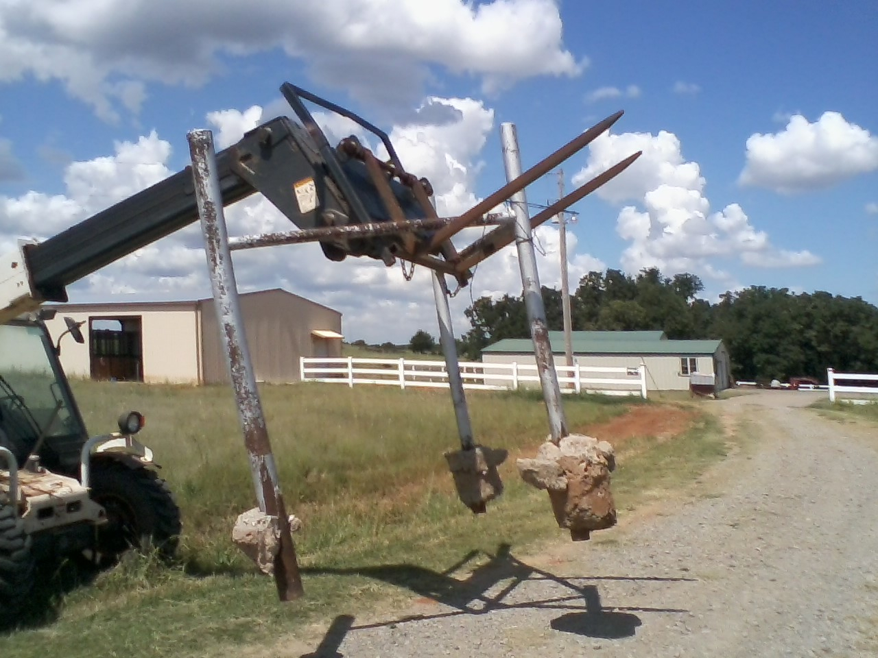

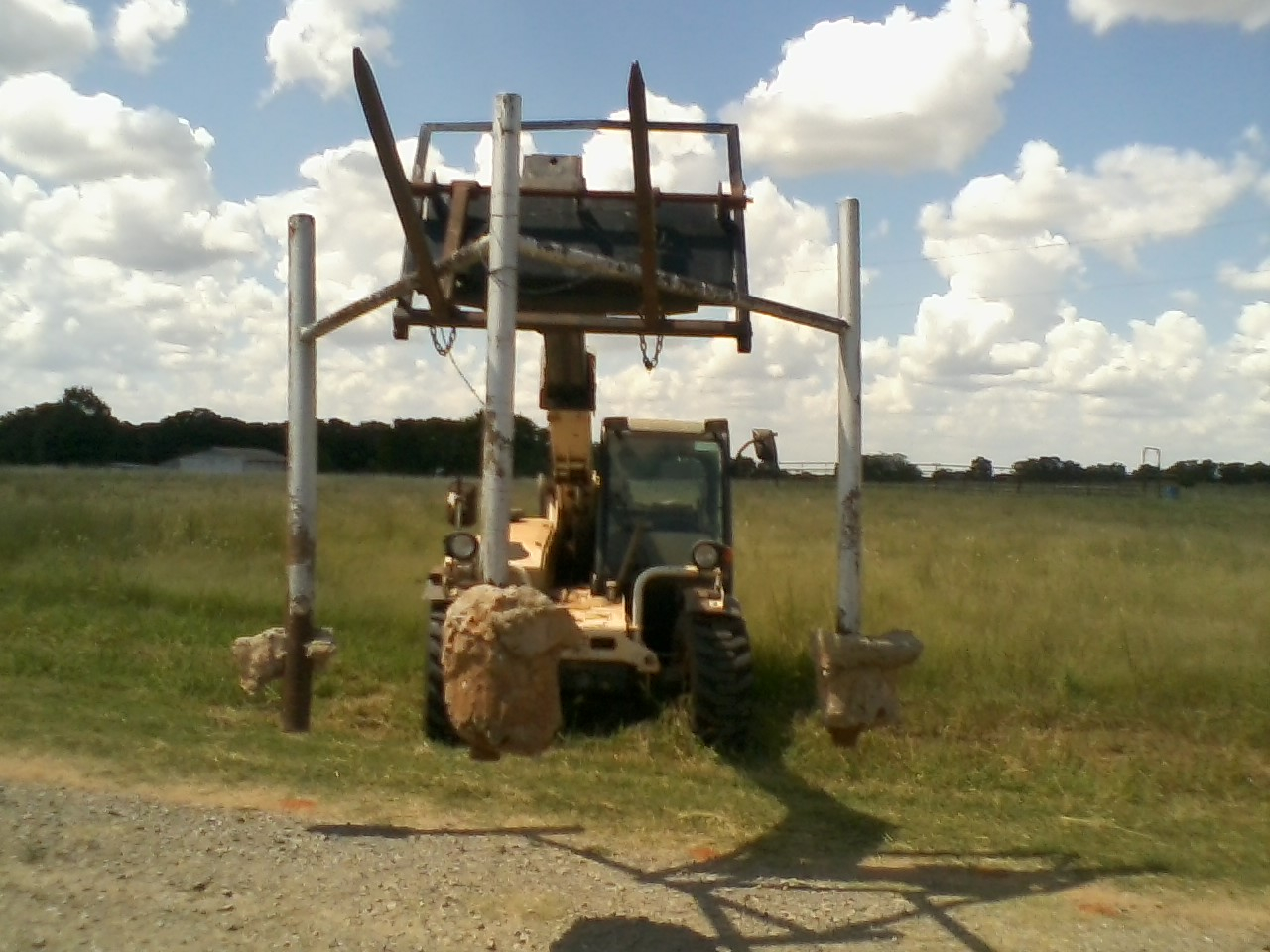

Nope, just an old broken off pipe fence post that was there when we bought that place.
Lots of used 2-3/8" and 2-7/8" pipe from the oil fields available around here.
Here is some with concrete still on the pipe, hanging on the 48" block forks:
