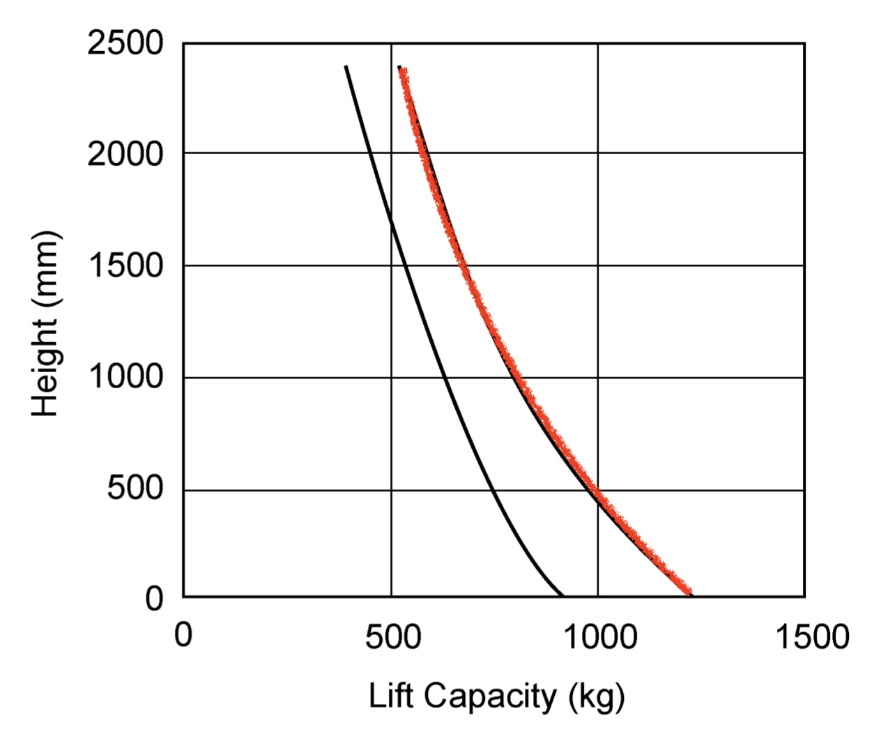

Loaders are rated at their maximum height but they get stronger the lower you go (ie, my Kubota L3200 is rated for about 1160# at full height but can lift over 2600# down low).
All else equal, a taller loader will have a lower load rating than a shorter loader even though they are equal. Drop the taller one down to the same height and the rating would be the same.
This comes into play in marketing. Tractors with short stubby loaders tend to have really high ratings. LS tractors were known for this. Kubota loaders would lift 12-16" higher and have commensurably lower ratings. Kubota gets dinged for this a lot.
If you can put them on par, apples to apples, rated at the same height, then you can get a fair comparison.
Here's the lift curve for my loader, in red. Notice how much it varies with height.
78" ROCK BUCKET (A52706)
78" ROCK BUCKET...
