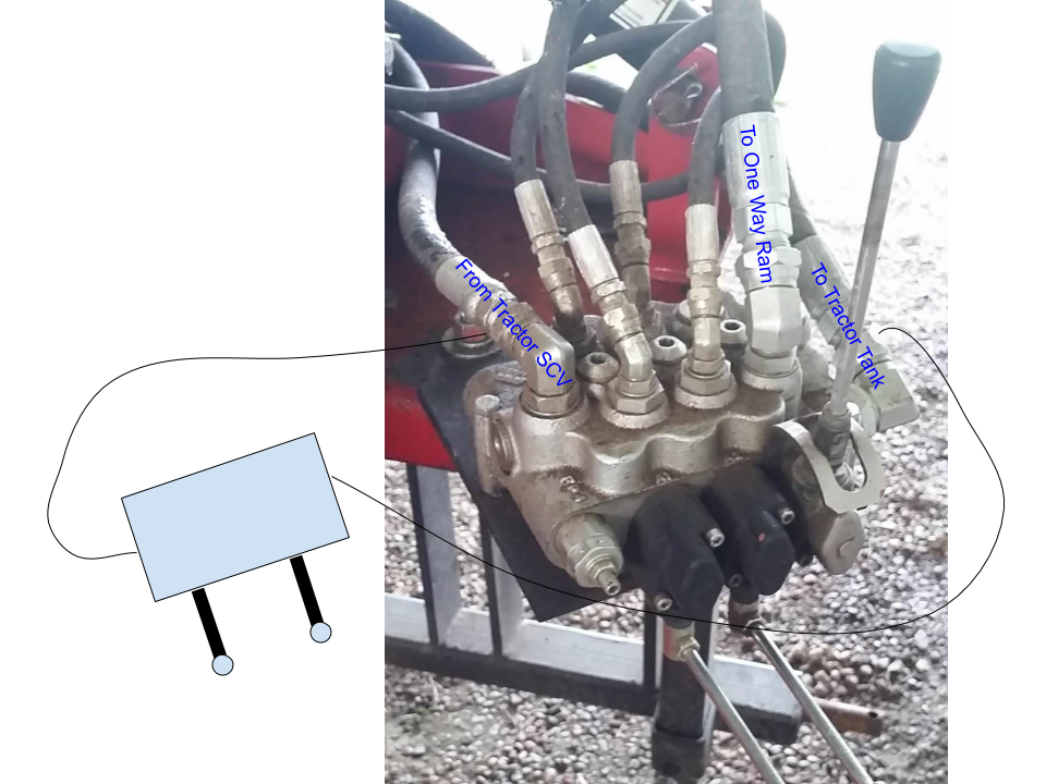

Hello All!
I'm working on a custom hydraulic shift on my Shaver post pounder. I would like to add an additional 2 valve bank to the existing 3 valve system to power some additional hydraulic rams. The current valve is closed center and powers 3 rams, the final ram on the pounder is one way, so the return line dumps to the tank on the tractor, not back to the SCV.
My question is how to plumb in the new valve into this system. Am I correct in assuming that I should tee off the line from the tractor SCV and tee the return line to the tank because this is closed center? The shaver dealer is telling me I can put an open center valve with power beyond before the closed center valve, that doesn't seem right to me. Attached is a picture of what I'm working with.
The post pounder is on a John Deere 2555 tractor (closed center, 23 gpm, 2320 psi). Also, am I correct in assuming that I should turn the relief valve pressure setting on both these valves all the way up since the tractor has its own relief valve?
I'm considering purchasing this valve, the handles can be positioned similar to the existing valve and the specs seem to fit. It comes with a closed center plug and is reasonable at $112. What are your thoughts?

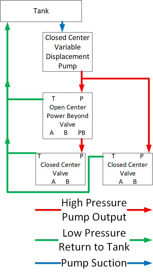

Here is a flow diagram:
630752d1575154320-adding-valve-closed-center-post-ccandpbvalve-png
A and B are work ports
T is low pressure return to tank
P is high pressure in from the pump
PB is high pressure Power Beyond
Aaron Z

The downstream closed center valve blocks the flow from the Power Beyond port of the open center valve.
Please explain this part of schematic because I can't determine how a CC valve is blocking the OC valve. Plus I'm not buying into the return oil(green line) will be low pressure. I've never measured it but when one sends 2250 psi to return line I think it won't be low pressure in return line.
Another fallacy to that schematic not functioning on a JD closed center hyd system is the blue arrow(suction) because JD piston pumps are incapable of sucking oil & requires oil to be supplied to them via a charge pump. The blue suction might be fine IF large hyd reservoir was mounted above CC pump but it won't operate correctly with smaller reservoir because many JD tractors have a smaller reservoir & had hyd problems

It will work. The flow characteristics will not differ from the original CC valve only installation. The diagram is functionally accurate except the detail of the missing charge pump and does not account for the woefully inadequate charge pumps used by Deere for decades.

First valve will have a PB plug feeding the second valve. The second valve will then have a Closed center plug, therefore making both valves closed center. The pressure side will be blocked no matter how many valves are behind the last one (fitted with a CC plug).
