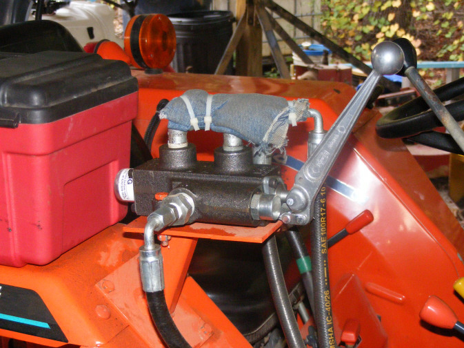

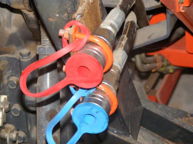

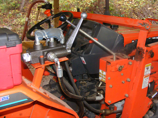

I already did the rear remote thing and after reading this thread I'm glad my friend gave me 2 good pieces of advise.
1: "don't over think it"
2: "keep it simple stupid"
Already having a fel on a tractor it is very easy to add as many RR's as you want or need and for cheap. All the hard work is already done because you have a working hyd system.
Take your loader supply and plumb it to the input on the new valve. I didn't even have to make any lines for this step, just rerout one. Next, with a new line come from the output of the new valve back to the input for the loader. You now have a remote valve plumbed. 2 lines coming from the new valve's ports to the rear of the tractor and mount the couplers and you are done. Loader is still full function, rear remotes when needed and the 3pt works like normal. As far as your original hyd system knows nothing was changed. I had already bought the valve and fabricated a mount for it the day before. Mounting everything and making all the lines took maybe 3 or 4 hrs. Total cost was under $300 and that was even using the push in/pull out type couplers like my M series has.
If more than one set of remotes are required just just buy a valve with how ever many controls are needed. 1, 2, 4, it would plumb in the same way. I hope you get yours worked out. Sounds like it's been a real headache for you so far.
