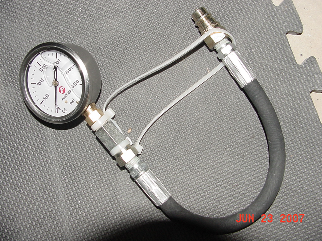

You mentioned a hydraulic gauge, would you just test pressures at dufferent places? Like before and after valve, at QD's?
/ Adding Rear remotes #72
I have a permanent gage installed to monitor and trouble shoot the hyd system.
You can install it in a tee at the IN port of the FEL where you can see it.
As you operate the cyl or hyd motors, you can see the pressure being developed. It will let you know the pumps psi, and allow you to check the relief pressure and set if necessary.
Whatever valve you operate, will show the pressure on the pressure gage.
Here are two test rigs, or you can just mount the gage in a tee.
You can use these to plug into any QD and momentary bump the lever to read the pressure.
The gages are only about $15
