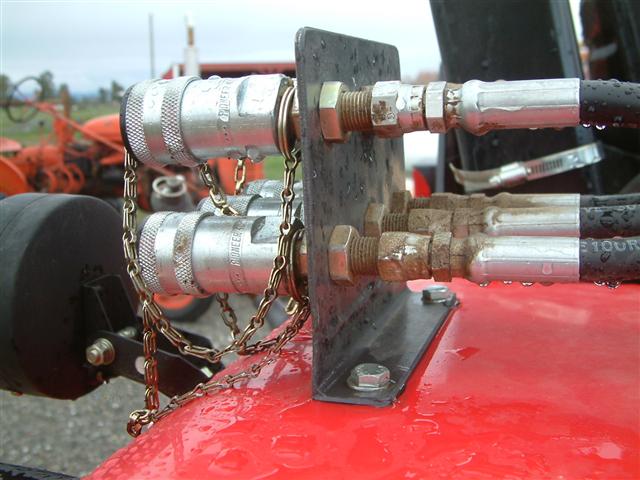

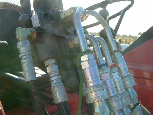

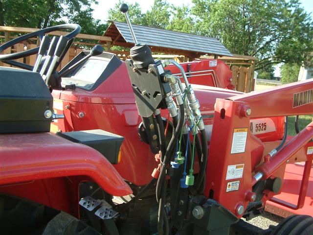

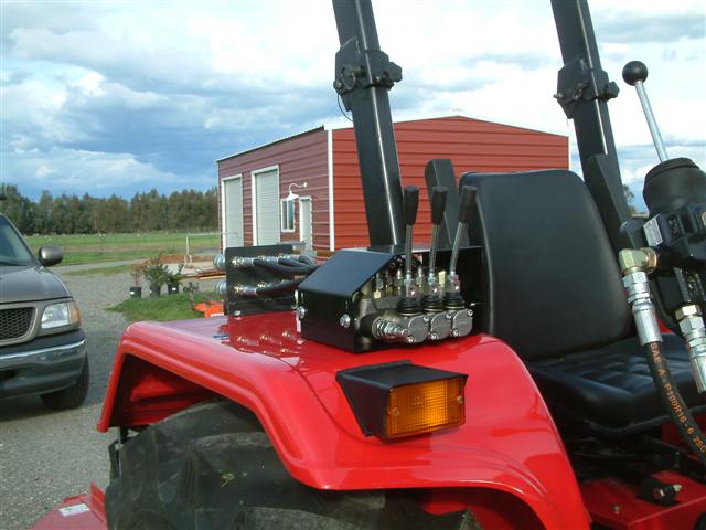

Here's the triple remote setup on my 2008 Mahindra 5525. Dealer installed when I bought the tractor new--$750 parts and labor.
Pressure comes from the power beyond port on the FEL control valve. IIRC you have to insert a sleeve in the PB port when using it for remotes.
The return from the remotes is teed into the low pressure line from the FEL valve.
Hope this helps.
Good luck

Nice job, Flusher. Have you found that mounting to the fender id stable enough?
/ Adding Rear remotes #26
No problem--Mahindra uses real steel in their tractors, not thin sheet metal or (gasp) plastic, so those hydraulic parts are tied down solidly.

Mine is fairly solid also. I think yours is the first one I have ever seen mounted on the fender.
/ Adding Rear remotes #28
It helps a lot to have that large flat top fender on my Mahindra so there's plenty of room for the hydraulic stuff.

Do you remember where you bought your valve from? And was the remote bracket made for you or did you buy it somewhere?
/ Adding Rear remotes #30
My dealer, Dave's Tractor in Red Bluff, CA, bought the parts and made all the sheet metal parts.
Dave is a TBN member and reguiarly posts here. His handle is "DavesTractor". You can send him a PM on this website or contact him on his website
Dave's Tractor, Inc - Home
The triple remote valve is made by Dinoil, a European company. Haven't been able to find a U.S. distributor yet.
