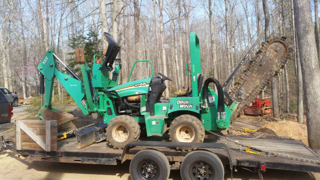

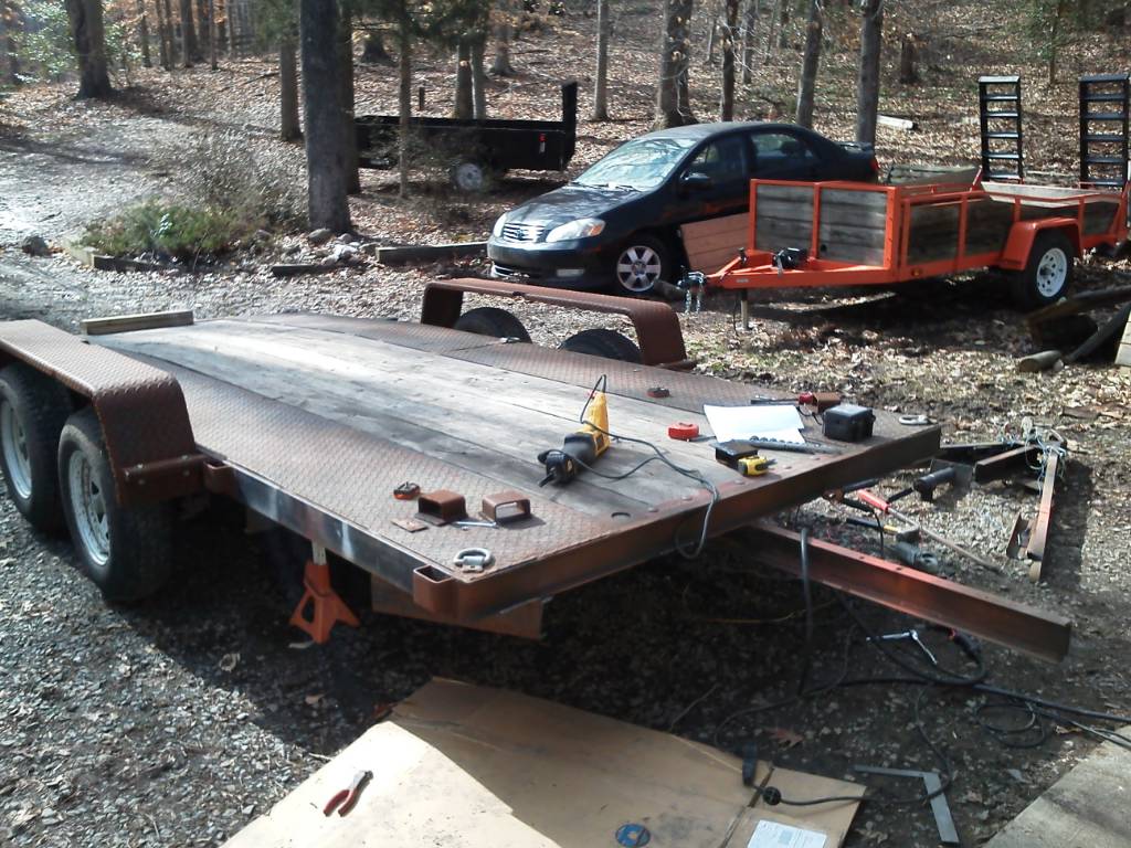

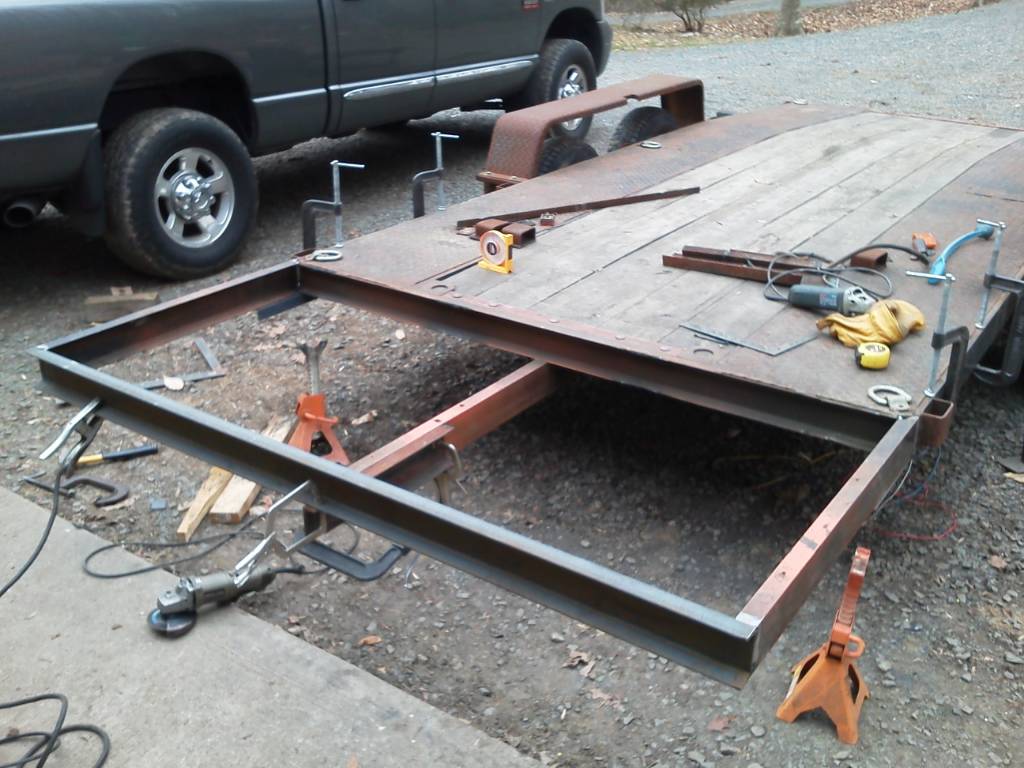

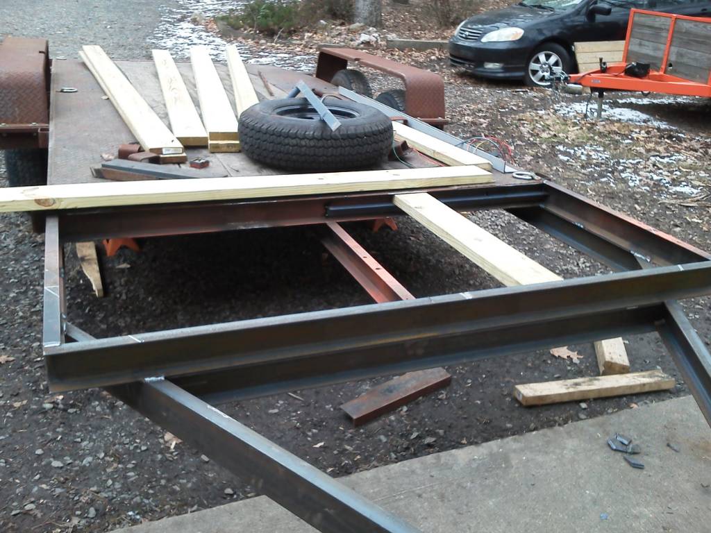

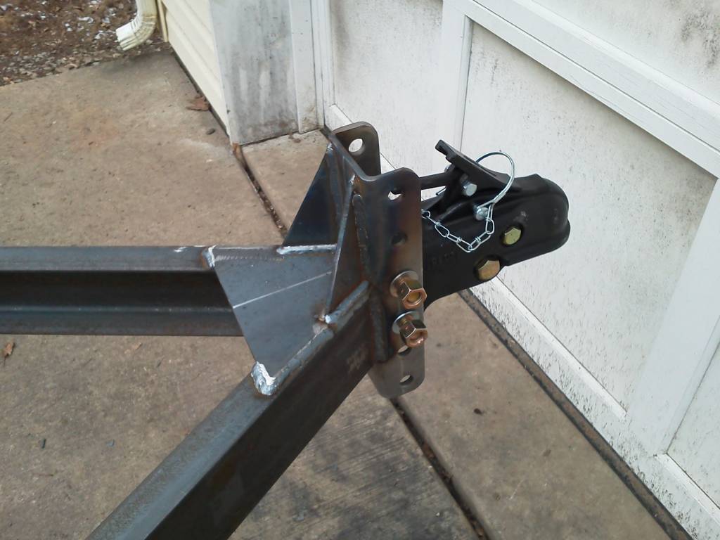

I extended my 15ft car trailer to 18ft, it worked well and I'm still using it to haul everything I will haul.
My axles were pretty centered so adding 3ft to the front actually gave me my 60/40 balance I wanted.
If you start having to move axles around etc. you might be better off selling and buying something else as has been already stated. 422385881.jpeg611939647.jpeg1155981905.jpeg1702957549.jpeg867333777.jpeg
