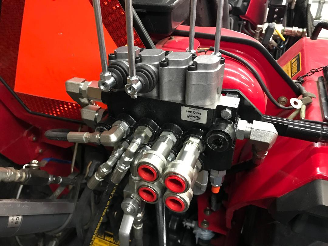

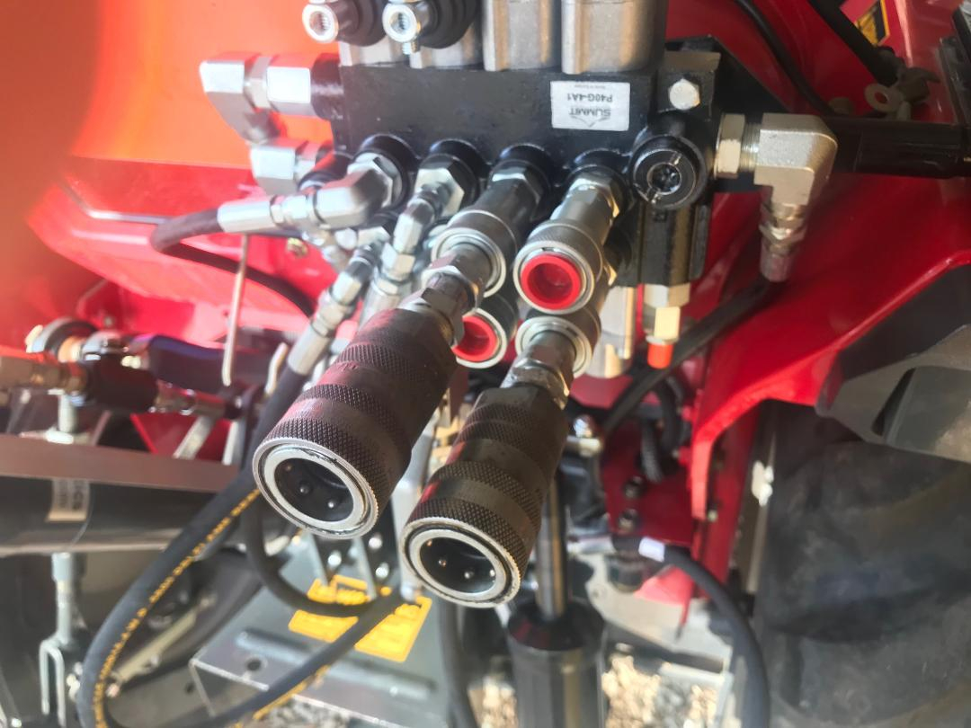

Just another pic to clarify my initial thought and question:
/ Adding Hyd Remotes-Why so much price diff? #23
In theory it should work.
But if it were me....I'd simply put a 45° fitting in one of the adapters or a different length close pipe nipple
#24
Looks like a 5" nipple would spread the large couplers and adapter fittings far enough to clear.
