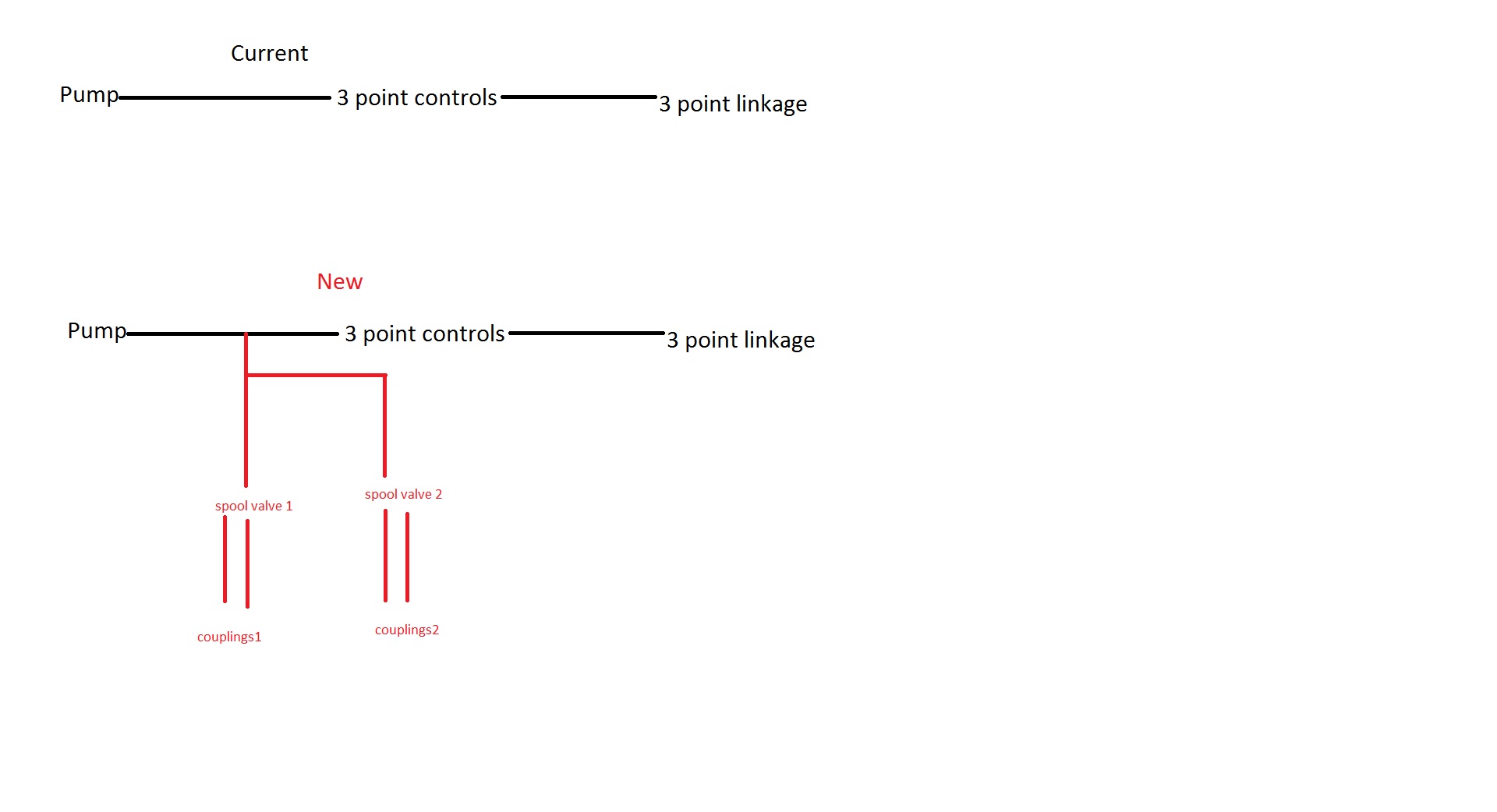

we are going to add 2 hydraulic valves to our old ford 4610
we haven't bought anything yet so far it is just in the planning it in our heads stage
where it gets complicated is that the tractor has a loader, so we need to find somewhere to take the hydraulic power from and really we want to be able to use the 3 point at the same time as these 2 hydraulic lines so as in we don't need to disconnect anything is change any stop cocks or pull in/out the hydraulic flow knob thingy that controls weather the oil goes to the loader, the 3 point or the current single external hydraulic line
we don't need to use the loader with any hydraulics attached
could i take the power from the hydraulics that operate the 3 point linkage? would oil still be fed to the 3 point and the new external lines?
if it makes any difference the new external lines will both be double acting for use with double acting cylinders

I believe your tractor is open center, so you need open center valve with PB.
If you have a loader valve, with PB, you can add more valve in series with the pump flow.
Don't know if your tractor has a hyd block, but that is one place to interrupt the flow for your new valve.
All valves have to be in series.

i think it is currently plumbed in so that it goes from the pump to the loader and then the oil from the loader returns to the sump and then you change the lever to 3 point mode and the oil goes to the 3 point and then returns to the sump
i was thinking if i can find the 3 point hydraulic line and intercept it before the controls for 3 point i could simply fit a T piece and spool valve and couplings and hey presto?

/ adding external valves?
a very basic diagram knocked up on MS paint
of course all spool valves and 3 point controls have a return to the sump and the pump draws from the pump
anything new is in red
if you're confused just ask
Cheers Ed
/ adding external valves? #8
Nope, can't do that as the flow has to be in series with the pump.
If you can find an external line from the selector switch to the 3pt and interrupt that line, you could add a valve in series.
There is only one way you can operate the new valve inserted in series with the flow, and that is to use half lever/half GPM's on the remote valves and the rest of the pump flow is available to the 3pt.
If your remotes use all the fluid, there is none left for the 3pt,, as remote valve cyl fluid is routed to tank.
If the pump to the switch to the 3pt is internal, there is nothing you can do. .
If that valve is the valve you want, make sure it is open center and has PB port

/ adding external valves? #11
Yes, that is correct about the flow..
You can parallel closed center valves but not open center valves.
If the selector switch is the source after the pump, then that hyd fluid will either go to the loader or the 3pt.
You can have fluid going from the selector valve to the remotes, and then the 3pt in series from the pump.
Pump ----selector valve----FEL----tank
Pump----selector valve----remote valve PB----3pt----tank.

i have even figured out what PB does, it lets you add a valve in series whilst the oil then flows on to the 3 point as it is in this case :)
could i have this
Pump----selector valve----remote valve PB 1----remote valve PB 2-----3pt----tank.

/ adding external valves? #15
Yes, that is correct.
