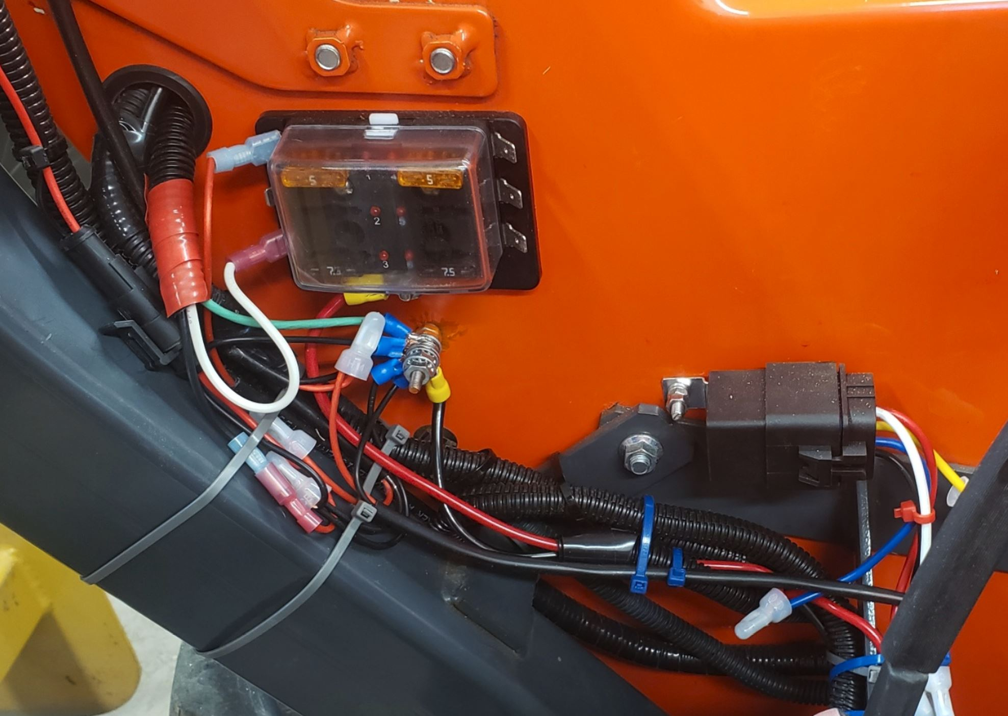

The second addition was to the back of the tractor. There is a 6 circuit fuse block that is powered by a standard automotive 40A relay. The relay is wired directly to the battery through an inline fuse. The relay is controlled by the 'work light' circuit - it is live when the key is on.
I currently have 4 circuits being used there.

I was thinking one electric port for all my needs (fuel station, sprayer, battery tender) connected with a relay controlled by a switched hot lead…
That‘s not gonna work… I’d have to leave the key on to have the battery tender charging… DUH!
