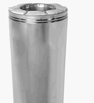

That sure looks like a Selkirk chimney to me, if not it's a twin to it.

Ok CM-thx. I looked up Selkirk per MrMikey and I do believe that is what it is. The brackets in the photos I took match and they have a product line intended for generator installation. I'll check out the Cummins manual as you mentioned. This thing is powered b a Deere "big block"-like 13 or 14L.
/ Adding DPF to 350KW Generac #30
Mikey-Selkirk is a brand?
Yup Canada ,. I do believe there are other brands but it is the most common around here. It's what I have on my woodstove, no complaints with it...other than the cost LOL. My next door neighbors had a chimney fire a couple years ago, turned the top foot or so a nice shade of purple, must have burned for 20-30 minutes until it was noticed and the FD showed up, no damage at all after it was inspected.

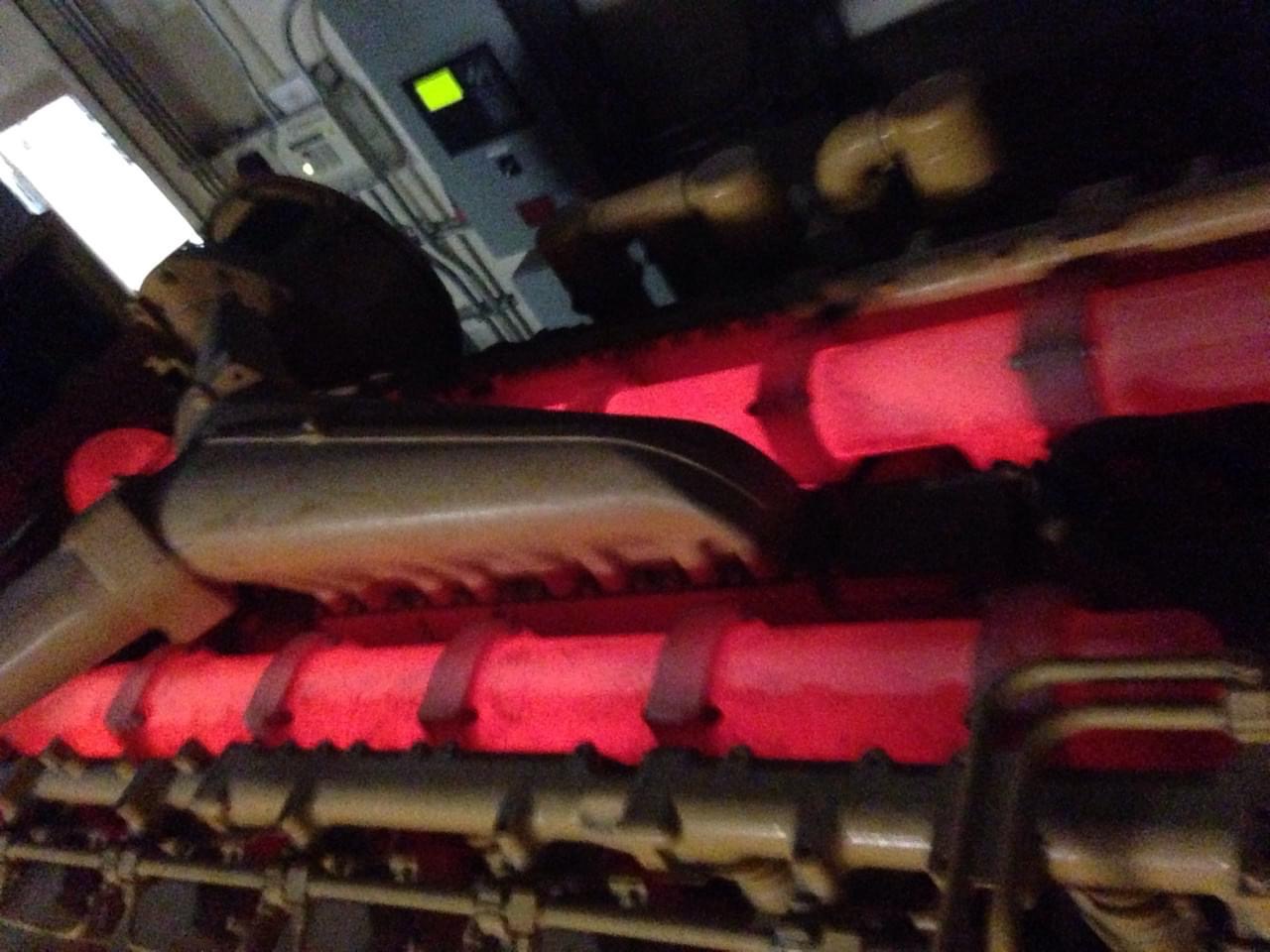

That’s a K50 Cummins but pretty much any commercial genset engine looks like that at full load and is expected to be able to run like that indefinitely.
Commissioning testing requires running at full load anywhere from 4 to 24 hours and occasionally 48 hours but within an hour the far end of a 100’ insulated exhaust pipe will be 1000 degrees. The exhaust stream doesn’t change temperature much from the engine to discharge.
