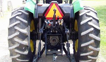

You might want to go out to JDparts.com for the 5210 and look at the various SCVs. You can have up to 5 sets of SCV. Most likely you will just need the third LV100117 and the lever for the third SCV. There maybe a kit that has both the SCV and lever. The lever would be installed to the right of the lever that raises and lowers the PTO. Most likely you will want the float spool.
You can also plumb off were the power beyond goes and install more SCVs. If you do not have enough you also do something with a diverter.
Not a great picture, but here is how the third would look.
