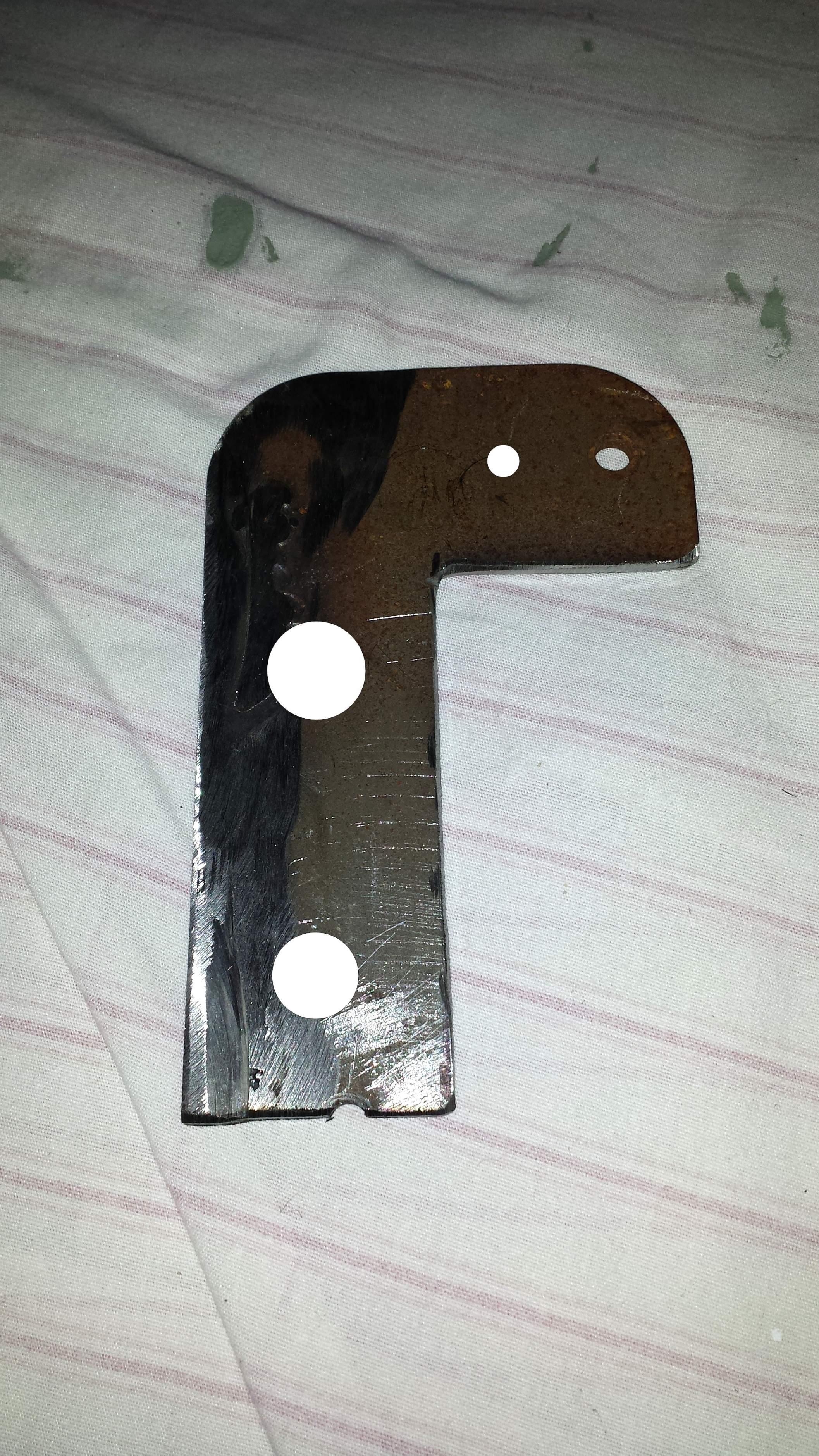

Thanks Scooby/like2wheel. Here's a pic of the rough cut mounting bracket I made yesterday. I drew the bolt holes in for effect. The steel is 3/16". I'm thinking of using long threaded bolts to mount the filter bracket by inserting the bolts from the back side and tack welding them. Then I'll use some extra nuts/washers to adjust the stand off distance from the existing FEL mounting bracket. I may even weld on a shield to the front side of the filter bracket if I can find an appropriate sized piece of scrap steel.
Oh yeah, one more question. Does anyone know what the torque setting is for the FEL bolts? I don't know if that's in the owners' manual - haven't checked yet. Thanks

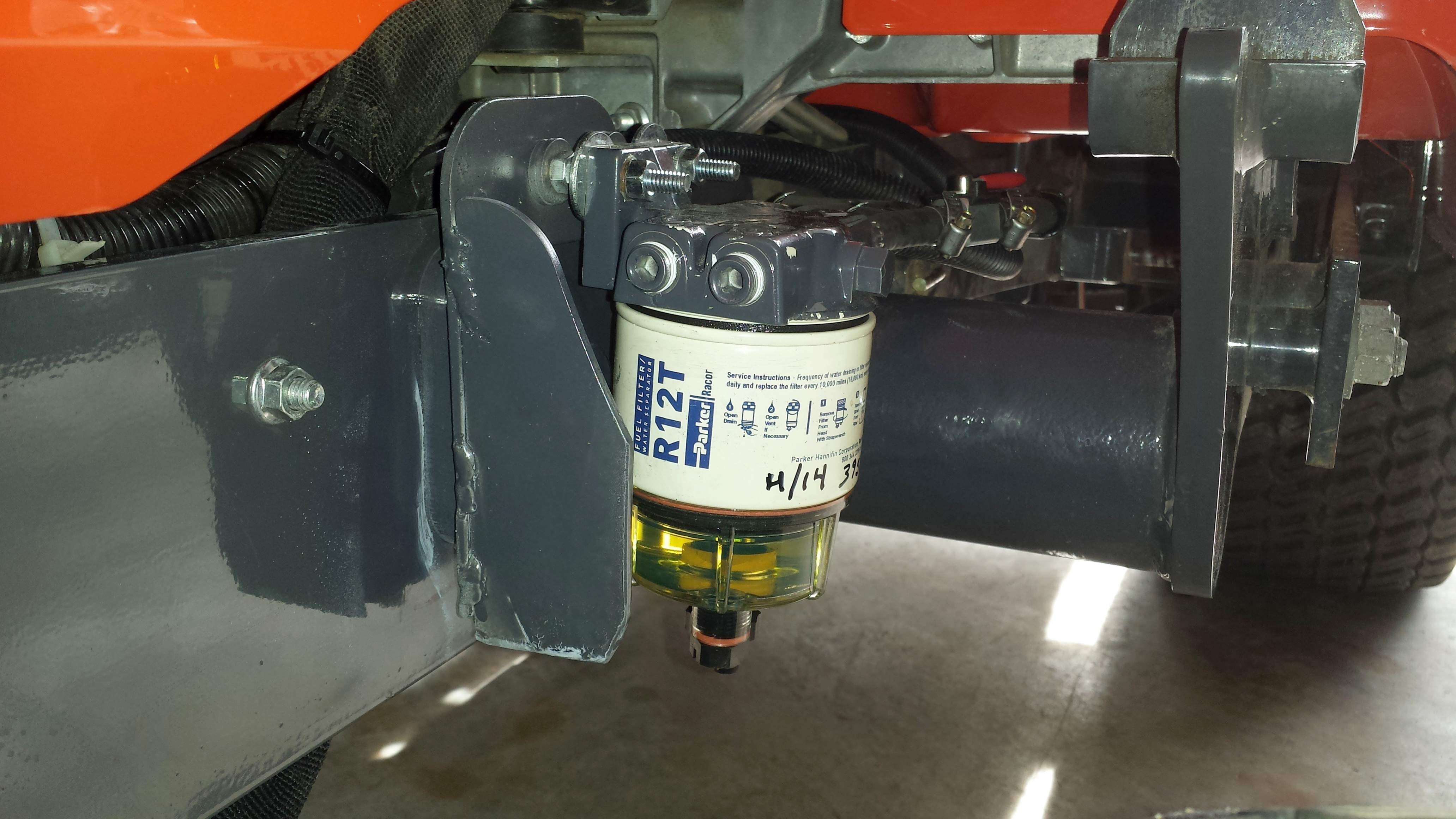

Well, finished my Racor fuel filter install yesterday as part of my 400 hour service. Worked out pretty well with one hiccup. Per the pic, I added a shield to protect the glass bowl as best I could. After I changed the transmission oil (SUDT2), I gave the tractor a spin and noticed the left front tire shuddered when doing a full left turn. At first I thought it was air in the power steering lines, but after jacking up the front using the FEL and doing full lock to lock turns multiple times, I still had the shudder. Eventually, the "duh" light bulb went on and I realized my filter guard was hitting the tire. Had to cut almost half of it off so now it doesn't provide full protection. It is what it is, and I'm not too worried it will get hit by anything big anyway. I did add a fuel shut off valve just before the filter (see red handle in pic). Thanks Scooby and others for blazing the trail. So happy I won't have to go under the tractor and drop my skid plate just to change that PIA OEM Kubota filter.
