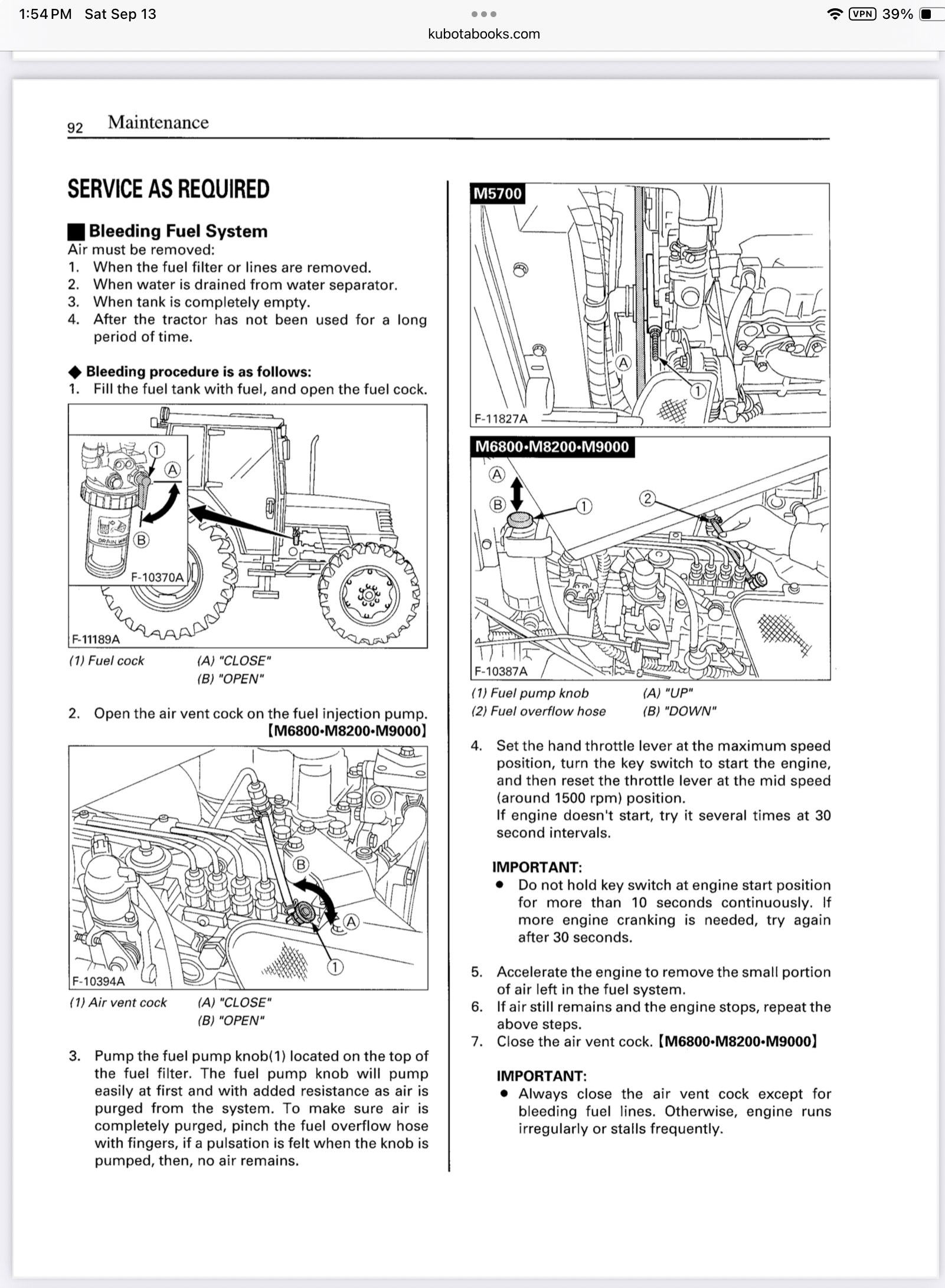

Found this googling “fuel prime for Kubota M8200.”
Fuel Filter Primer Assembly Kubota V3300 M8200 M9000 M6800 ...
To fuel prime a Kubota M8200, first, open the manual primer pump lever on the fuel filter housing to force fuel to the filter and remove air from that stage. Next, loosen the bleed screw on the fuel filter housing and continue pumping until a steady stream of fuel without air bubbles comes out, then tighten the screw. If air remains in the injector lines, loosen the fittings on the high-pressure lines at the injectors, crank the engine with the throttle wide open until fuel squirts out, then tighten the fittings.
Step-by-Step Fuel Priming
  1. Fill the Fuel Tank: Ensure you have plenty of fuel in the tank.
  2. Locate the Primer: Find the manual fuel pump lever on the fuel filter housing.
  3. Prime the Pump: Pump the lever manually until it feels resistant, forcing fuel and purging air from the primary fuel system.
  4. Locate the Bleed Screw: On the top of the fuel filter housing, find the bleed screw.
  5. Bleed the Fuel Filter: Loosen the bleed screw slightly to allow fuel to flow.
  6. Pump Until Steady Fuel Flow: Continue to pump the manual primer lever until a steady stream of fuel without any air bubbles emerges from the bleed screw.
  7. Tighten the Bleed Screw: Once you have a steady fuel flow, tighten the bleed screw.
  8. Bleed Injector Lines (If Needed):If the engine doesn't start after the above steps, you may need to bleed the injection lines.
    • Loosen Injector Lines: Loosen the fittings on the high-pressure lines where they connect to the injectors at the cylinder head. A second wrench can prevent twisting.
    • Crank the Engine: With the throttle wide open, crank the engine.
    • Watch for Fuel: Crank until you see fuel squirt from the loosened lines.
    • Tighten Lines: As soon as you see solid fuel without air bubbles, tighten the fittings.
  9. Attempt to Start: Try to start the engine. It should now start and run.

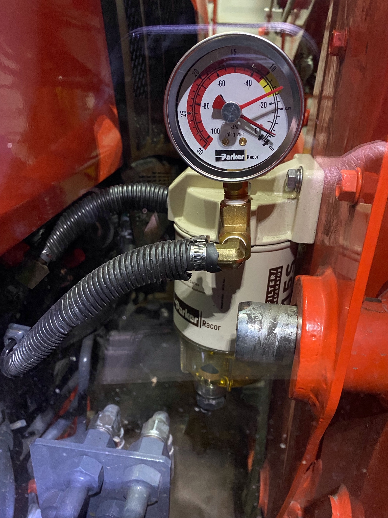

You both should consider adding or replacing the kubota fuel filter assembly with a RACOR 500FG fuel filter water separator as they can filter down to 2 micron with the right cartridge and also the water/dirt drain bowl prevents air from entering the fuel system due to its internal check valve.
/ Kubota priming fuel system help #11
I used to clamp off the fuel lines on both sides of the filter before changing. When I replaced the stock separator / sediment filter on my Kubota with a Racor 2u, I plumbed shutoff valves on both sides of the filter.
