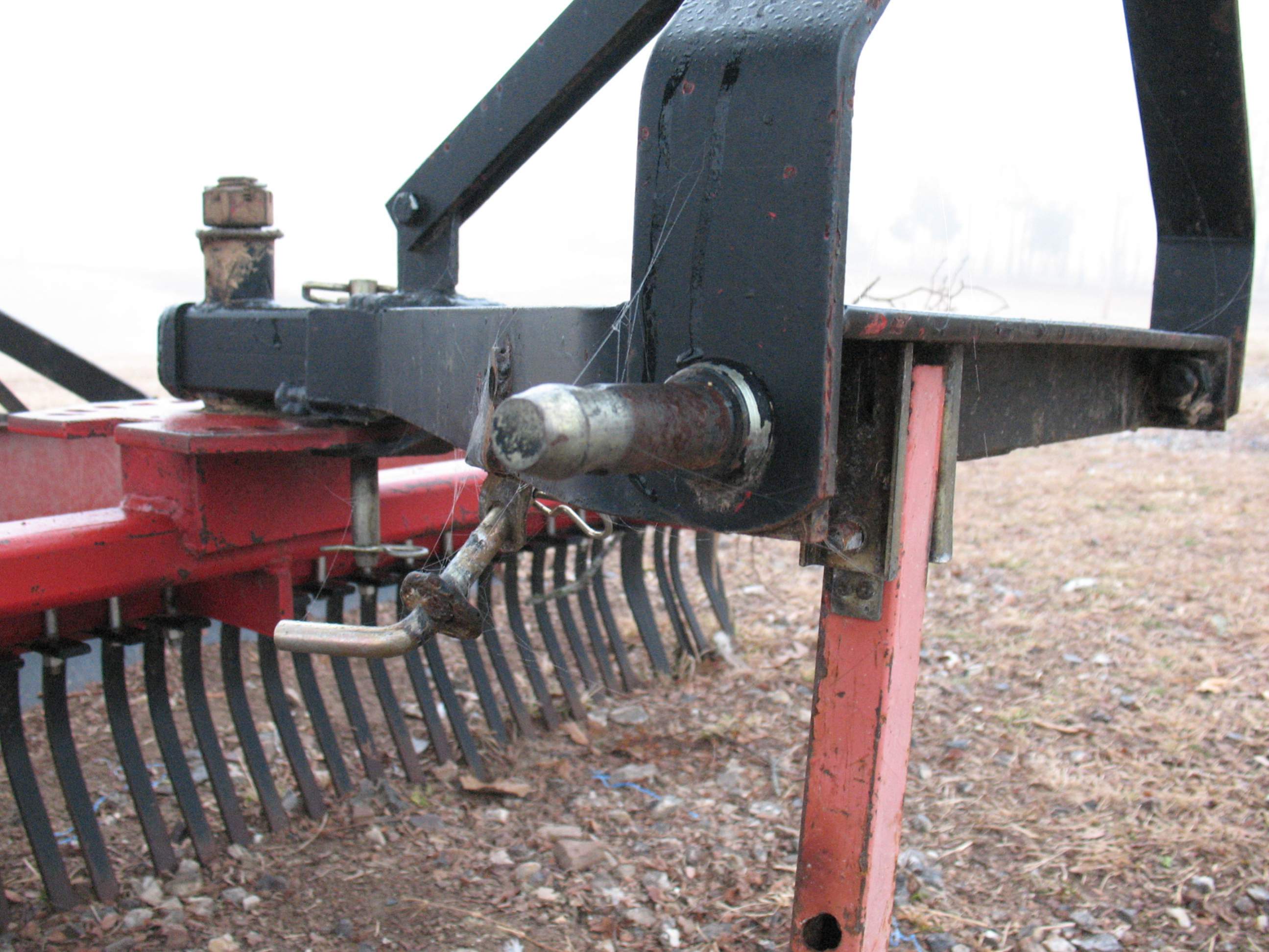

I did the same with mine.It makes it easier hooking it up or unhooking it.

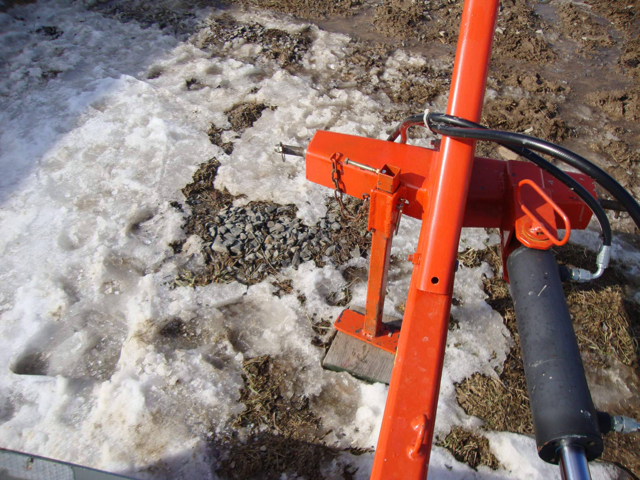

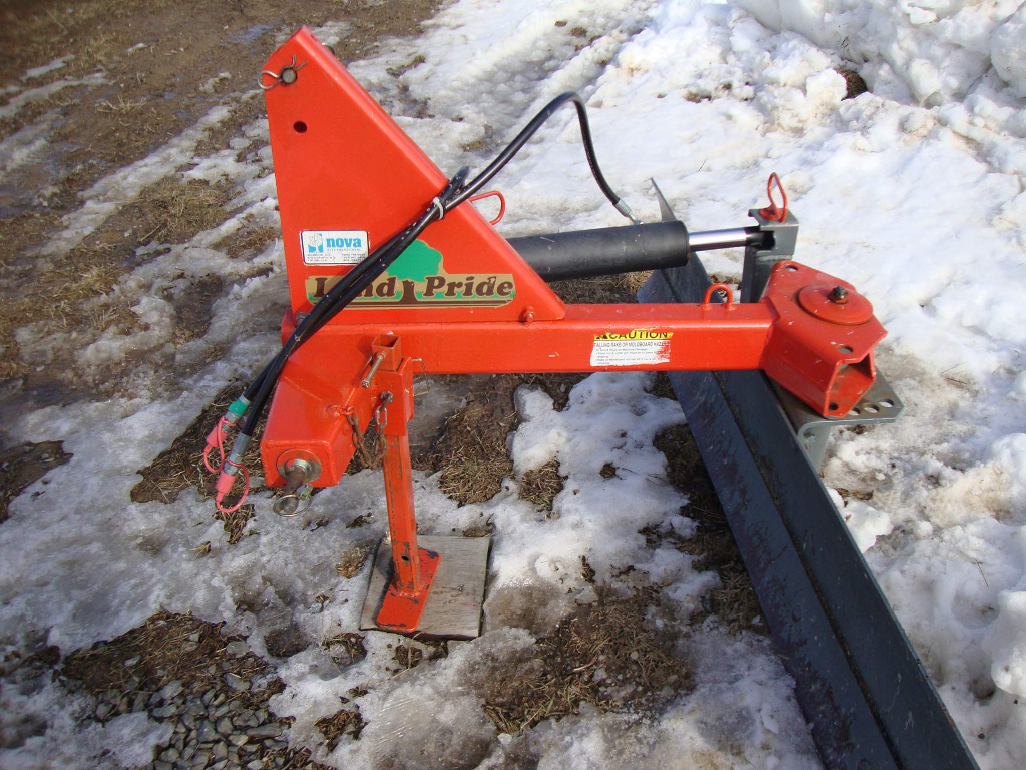

Most blade manufacturers make a kit to add a parking stand if you're not inclined to build one. Land pride does, for example.
Sean

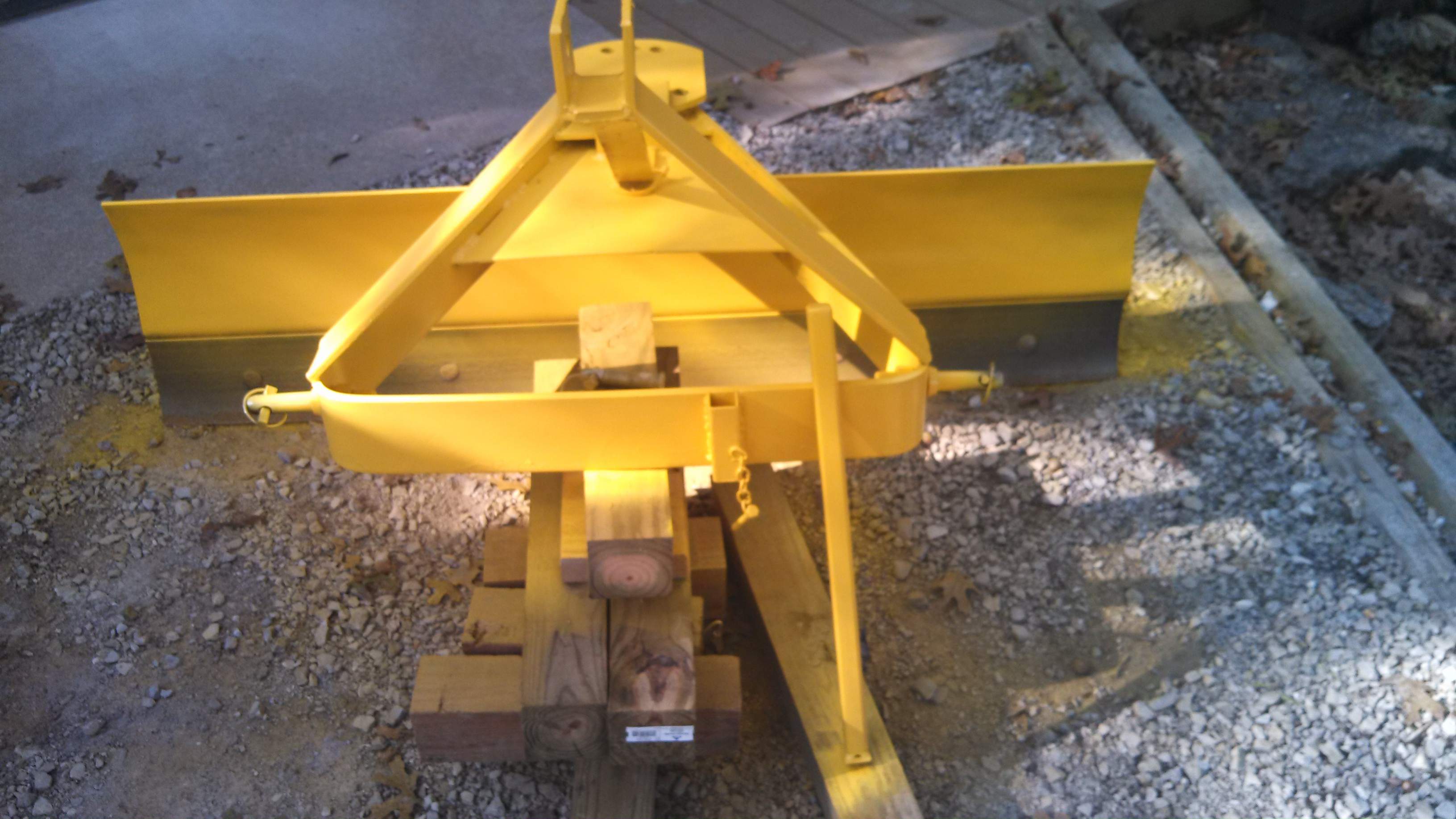

Ok, finally got some pics of the stand. I didn't have the exact right size square tube to use for the outer sleeve, so I welded a cap where it needed to be between the two side supports.
Sean
