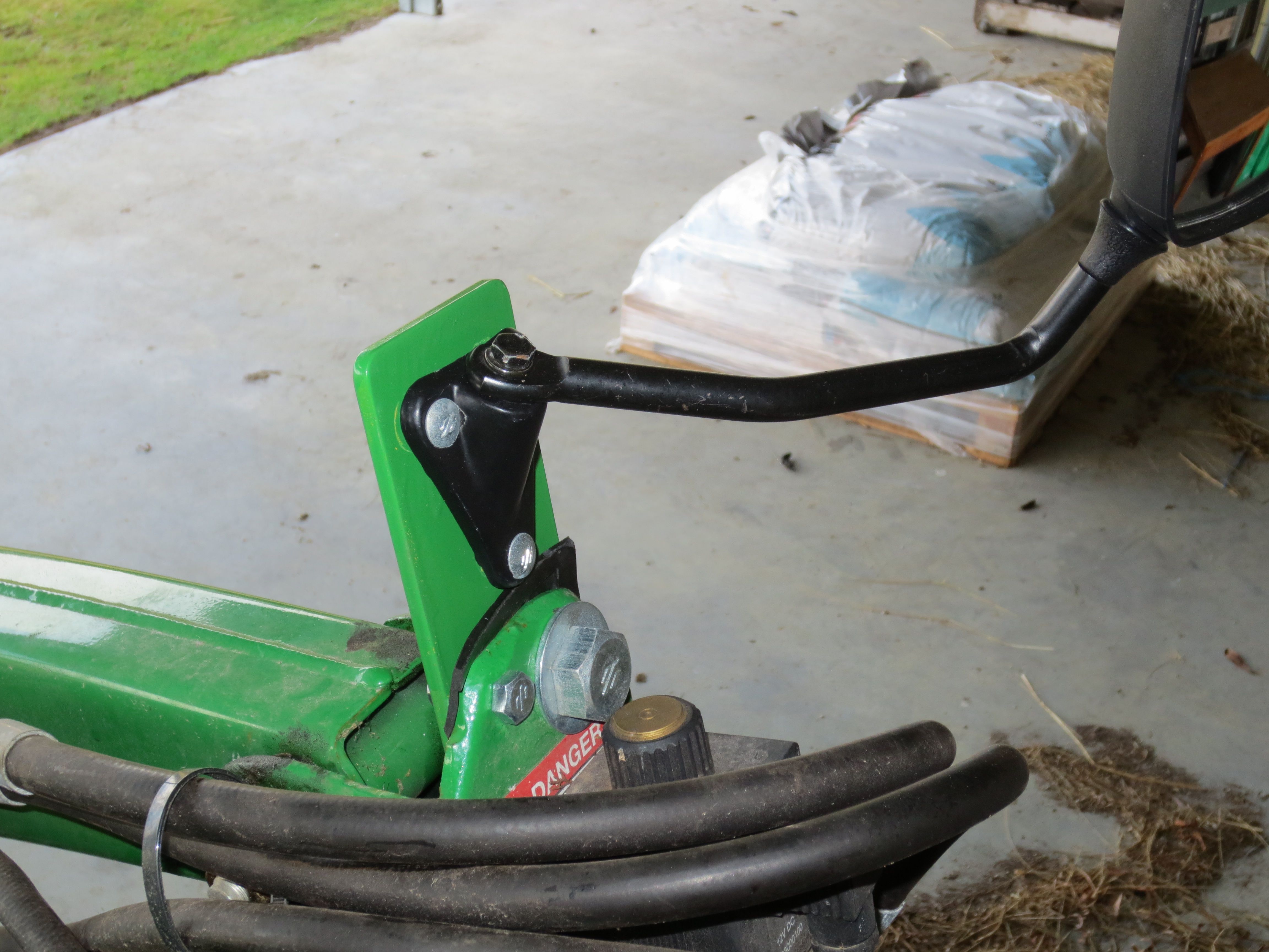

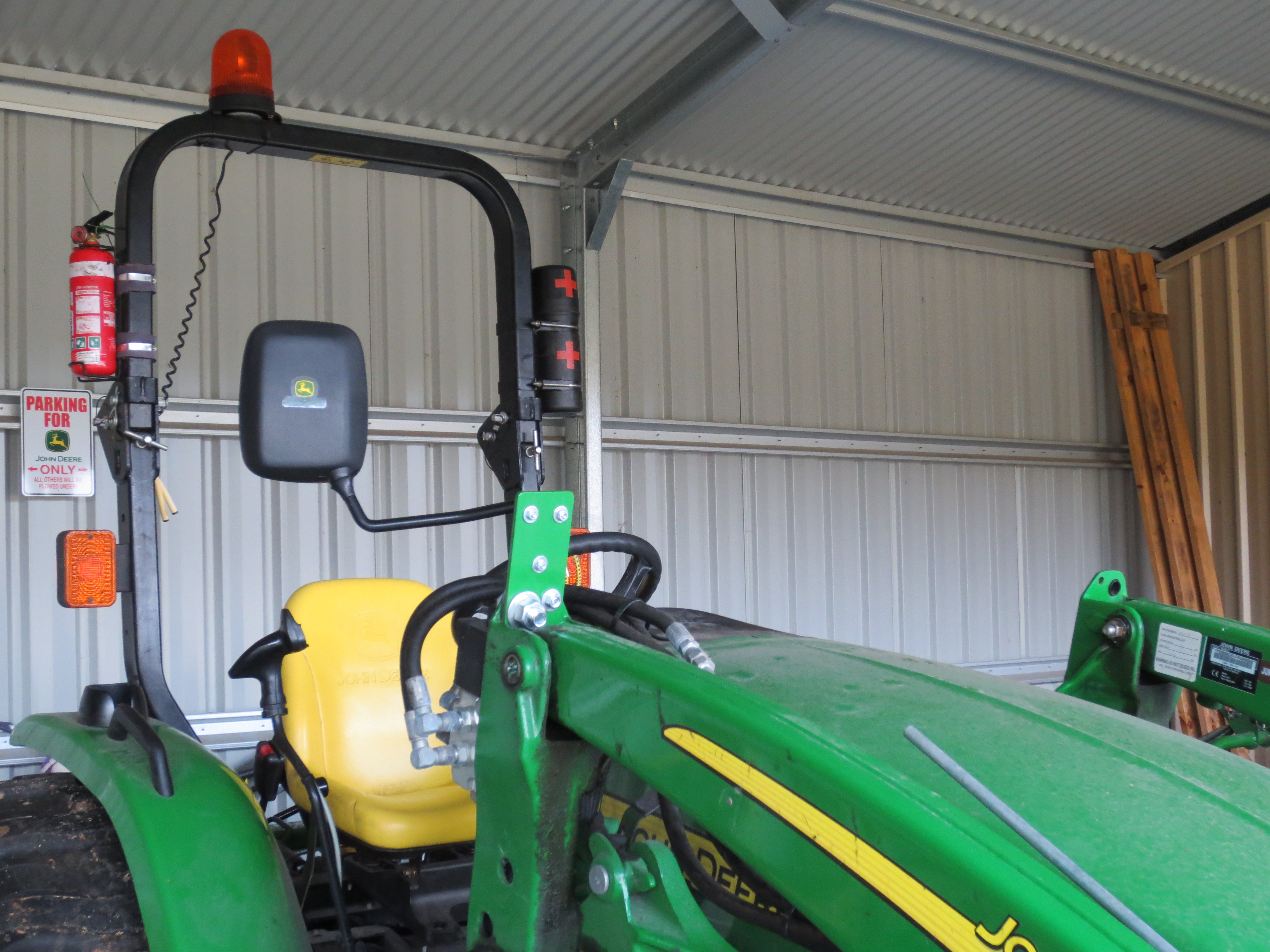

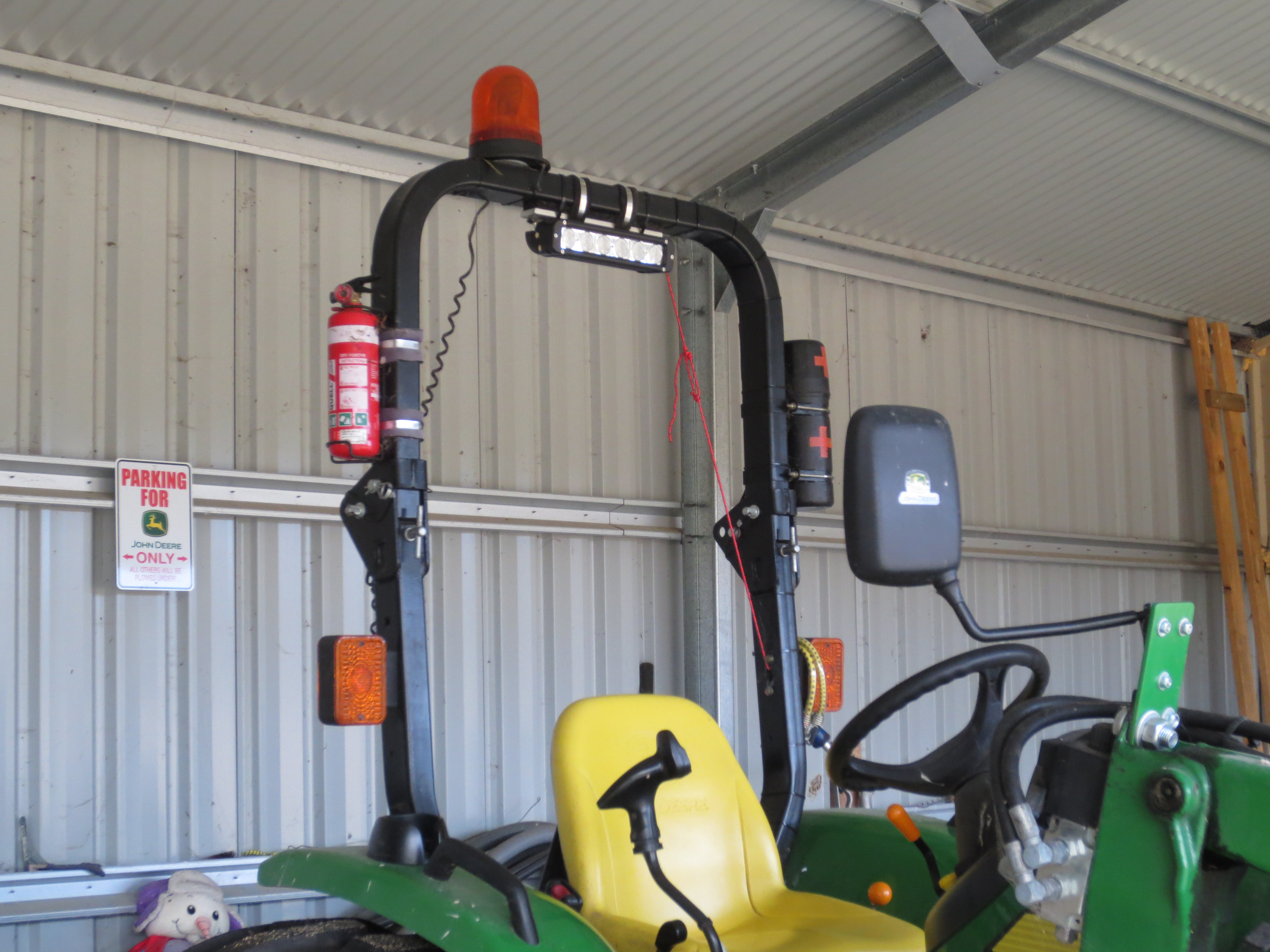

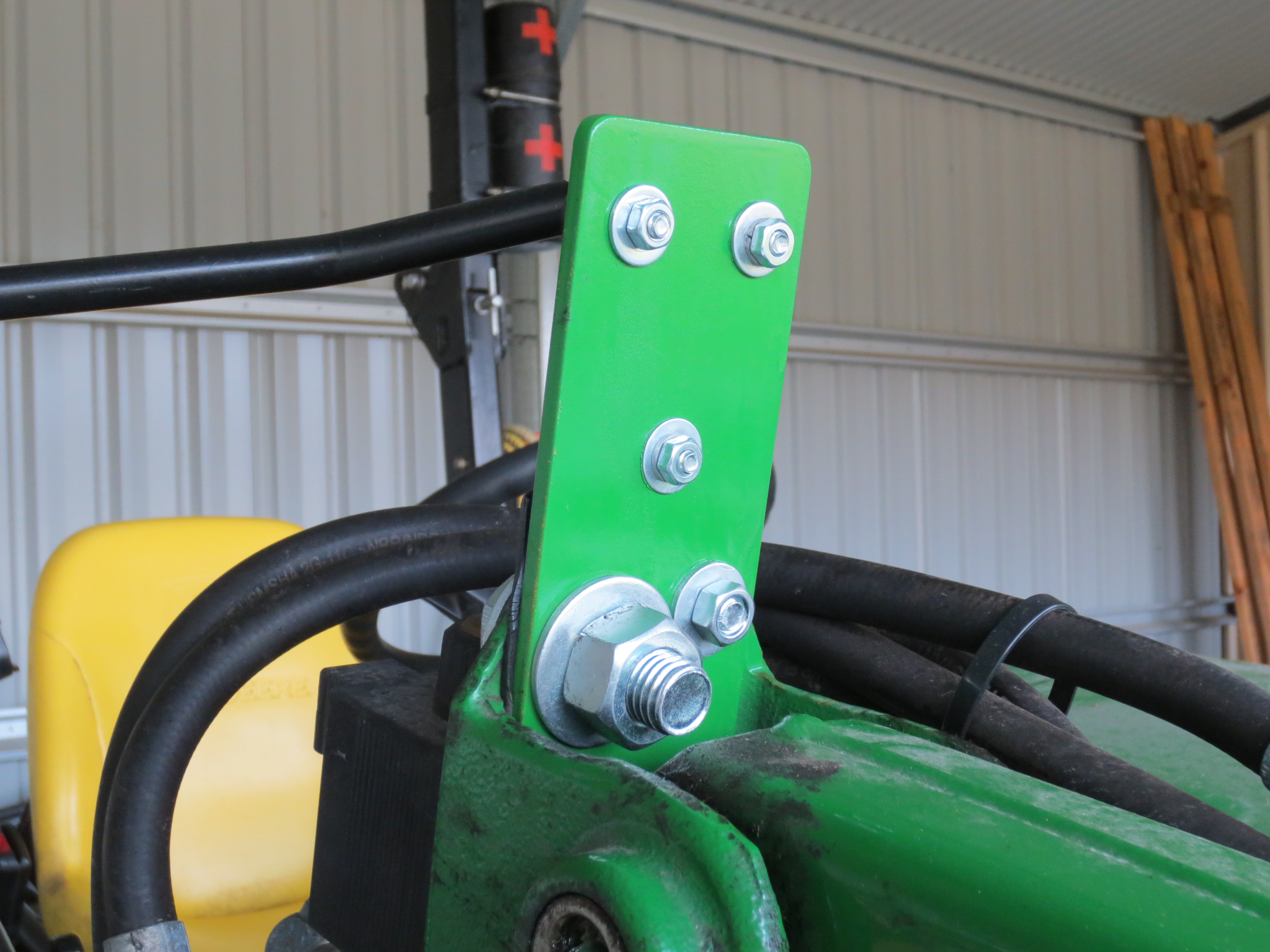

I went 'big' after trying the small, round, mirror type. I found a generic 'Van' replacement mirror (with mounting arm) at my local autoparts shop.
The local fabrication shop knocked up a mounting plate to fit the holes on my FEL post. I ensured that I cut a rubber gasket between the plate and the FEL to cut down on vibration; the result was no discernible vibration at all.
