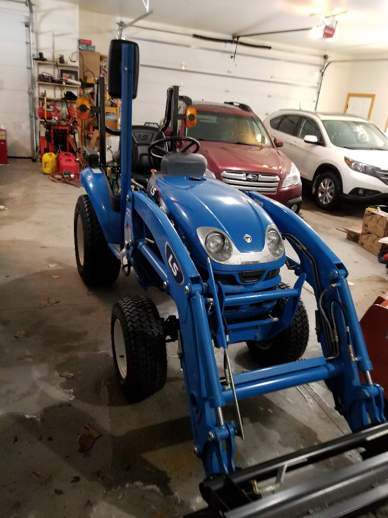

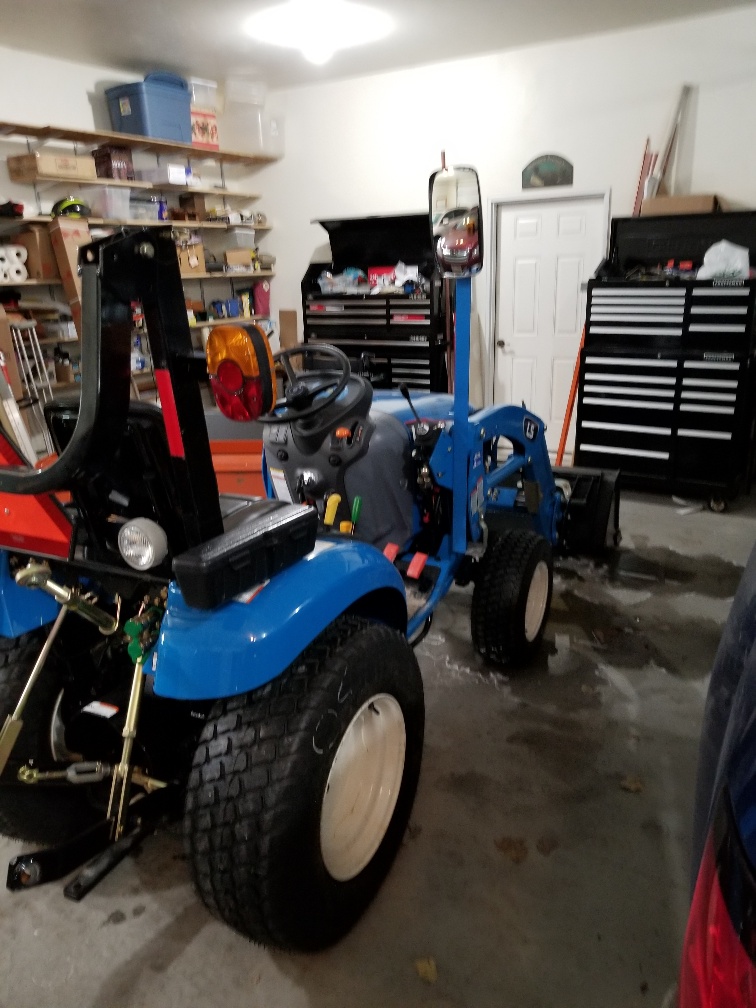

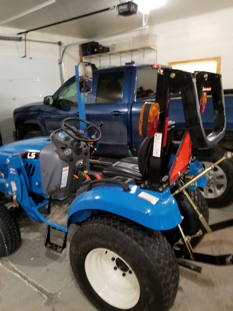

Bought a 4' piece of L2x2, mirror, longer bolts and spray paint.
Drilled holes to fit and matched the paint with your input.

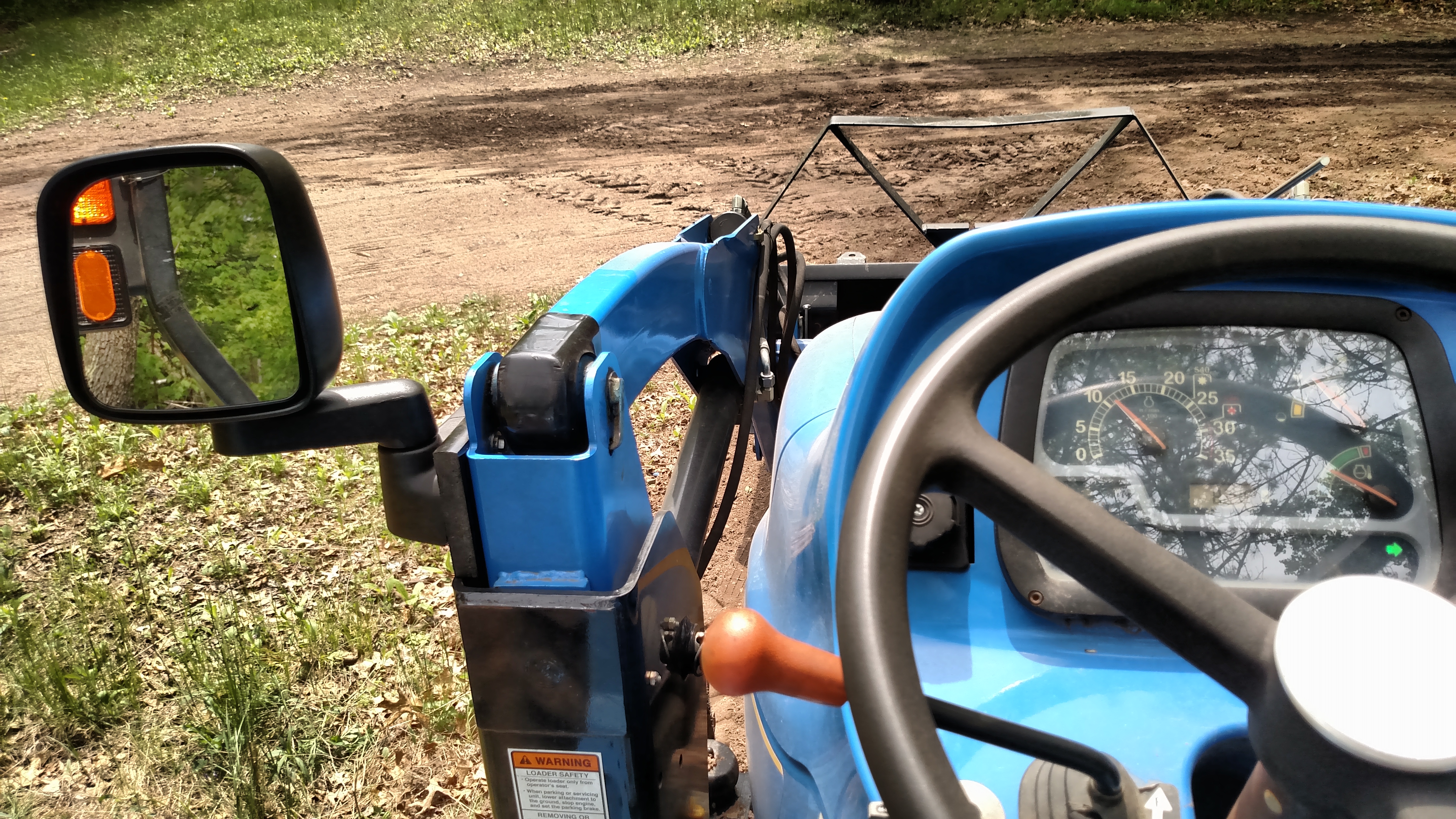

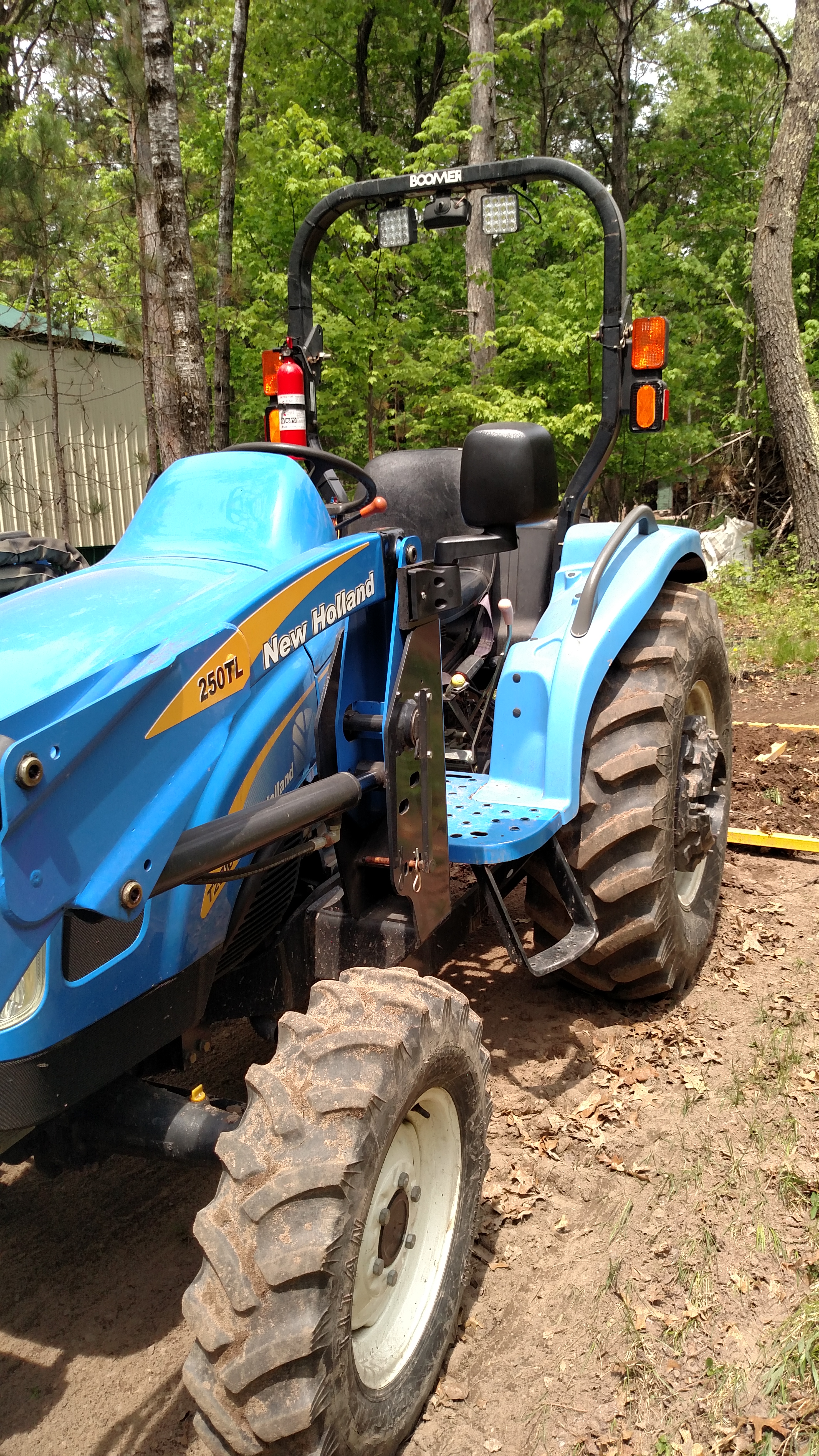

A $23 Jeep Wrangler mirror is an easy bolt on option ...

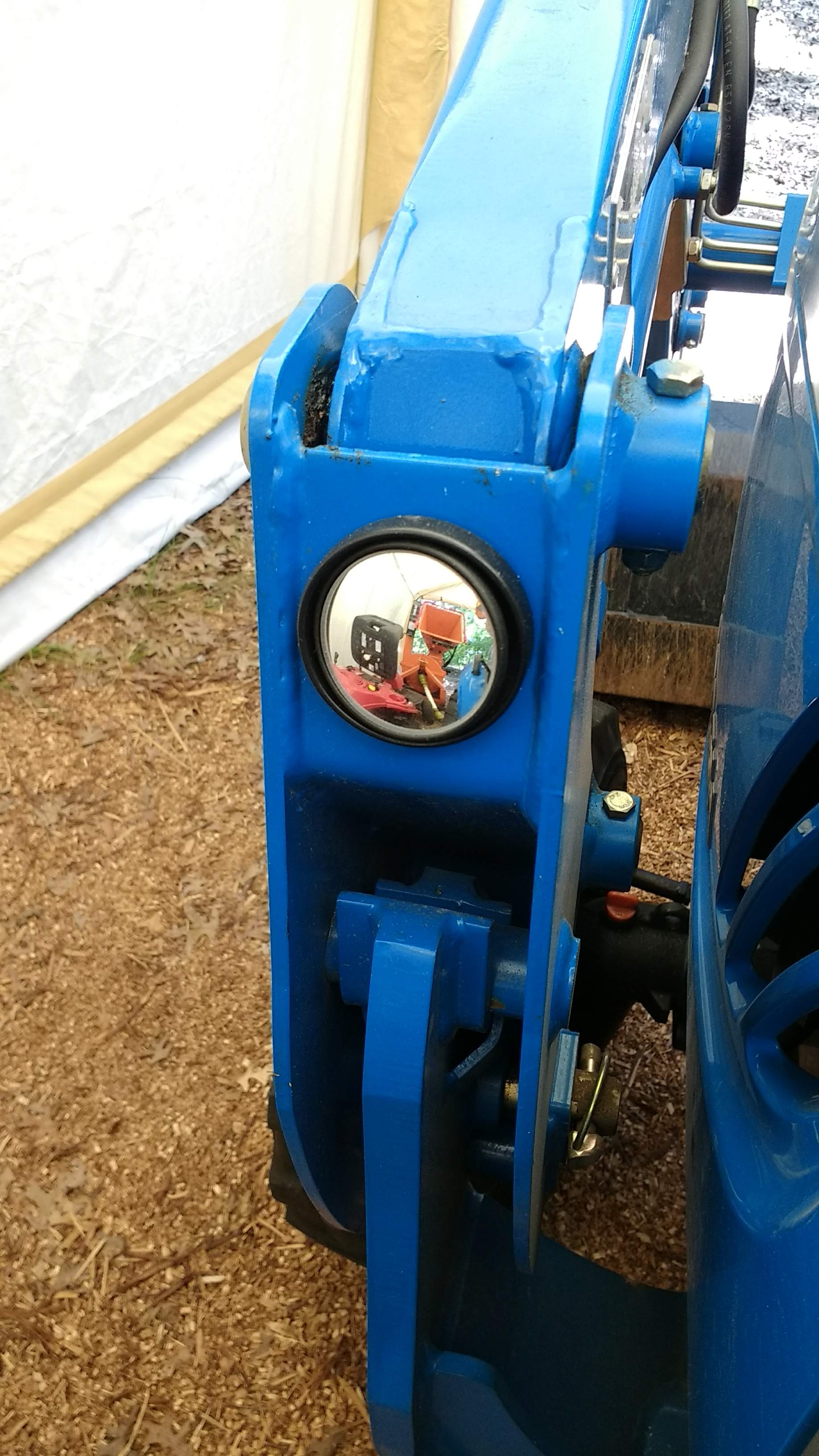

I've posted this before, but I'm reposting after using 2" spot mirrors for a number of months and finding how effective they are in providing awareness of things around me, especially when I am working or transporting where cars approach from the rear.
The mirror in the image is pretty old, but it attaches in seconds with double stick foam tape to each of the bucket supports plus it can be "tilted" to put the focus where you need to watch.
Amazon has similar adjustable mirrors at 4 for $6

Those look like branch benders to whip back and hit you in the face. I have one of those cheap self adhesive round mirrors on my truck which work good to eliminate the blind spots but I never considered putting them on the tractor. I might use that idea.

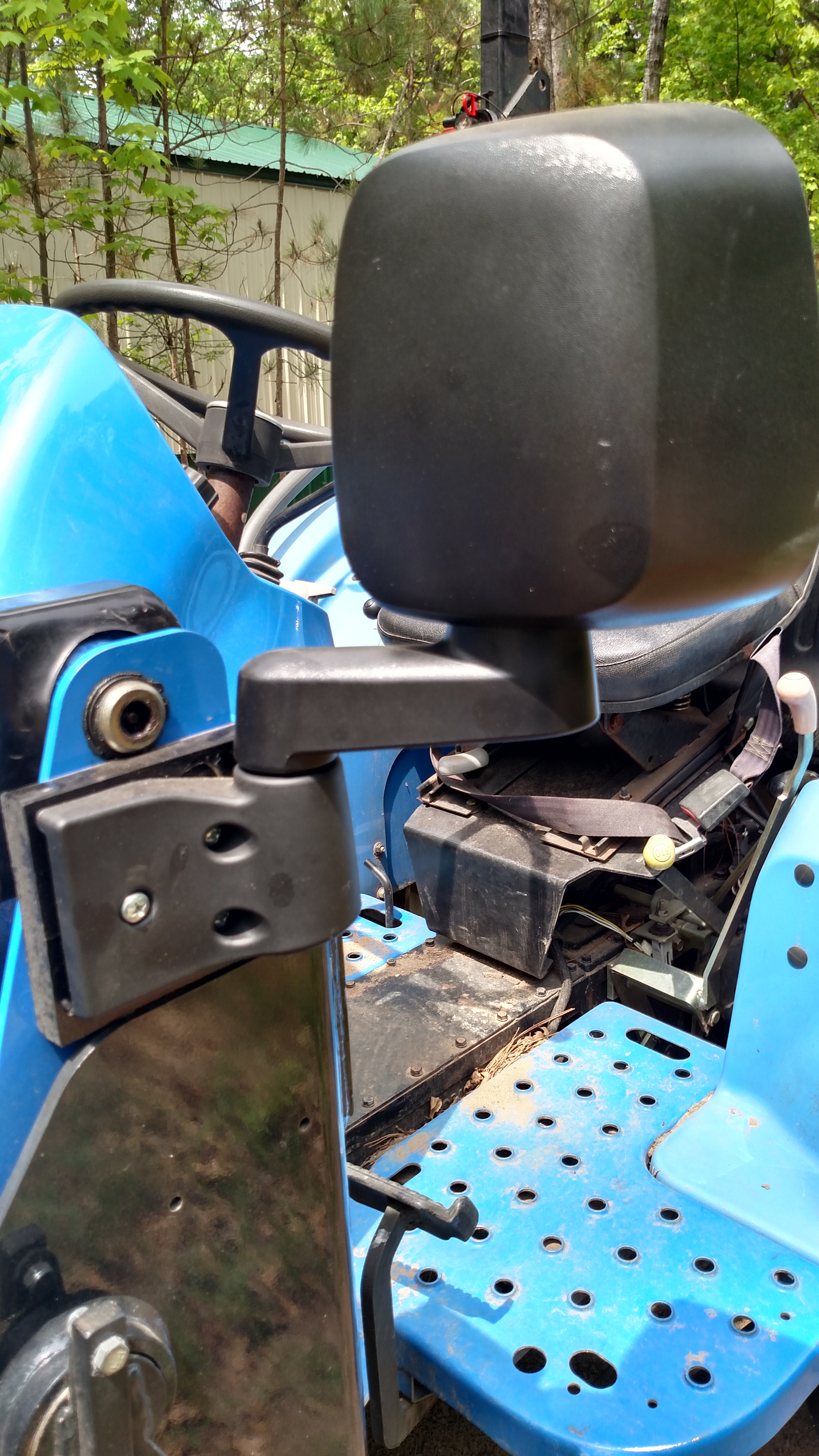

The Jeep Wrangler mirror I mounted has very little vibration. I was luck enough that there were a couple of holes in the loader mount. I used a piece of wood and threaded inserts to cinch it all down.
