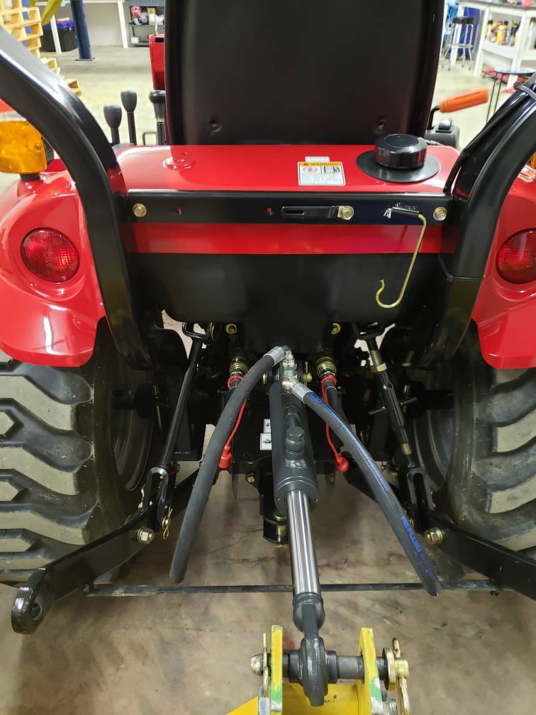

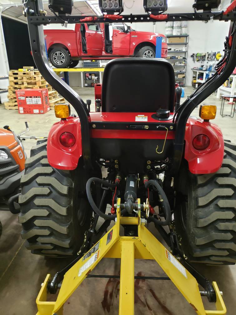

Added a hydraulic top link today

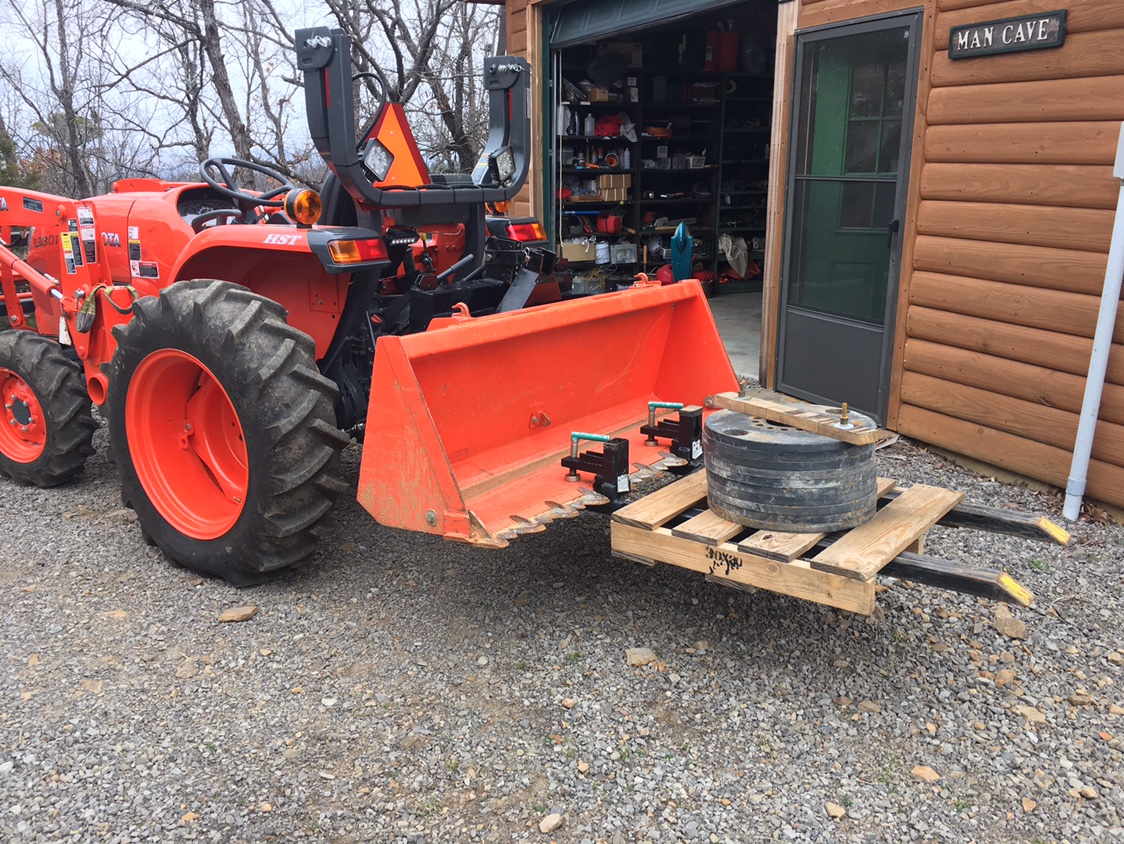

Just curious how you use that setup? I don't see much good having a bucket on the back, especially without a hydraulic toplink. Are you simply using the bucket to carry the forks? Cause you would do so much better with a actual forks. That bucket takes away from capacity, and pushes the load out pretty far
I don’t use it often yet but did it for using the bucket as a carryall mostly with the grapple on the front. I had plans (and am in the middle of) adding 4 remotes for which two are dedicated as TnT.
Yes. SSQA forks would be even better but I had my unused bucket and slide on forks not being used. I tend to leave the grapple on most of the time I’ve noticed.

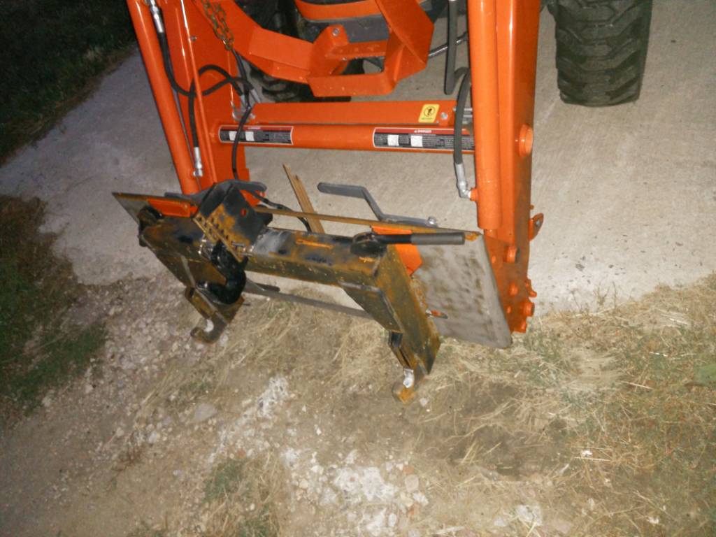

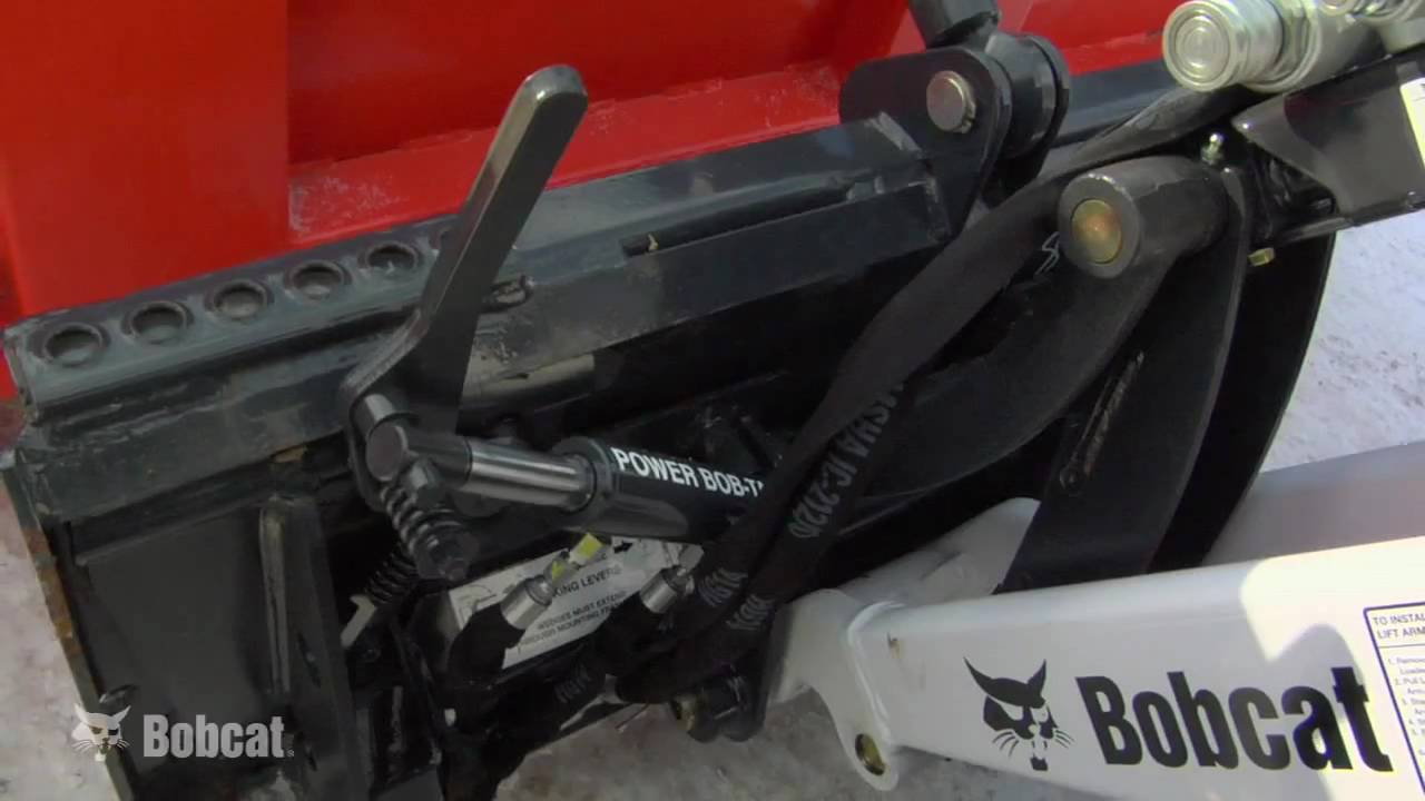

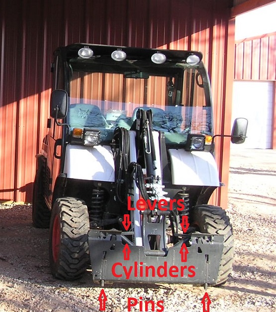

I was refering to the picture of the bobcat. that handle is definitely different than the regular two handled ssqa . I will check out your other thread. Kubota wants a rediculous amount of money for their hydraulic actuation of the ssqa.
/ Added a hydraulic top link today #28
I posted the picture from Bobcat. That picture angle doesn't show the other side.
Here is mine from the front:
If the cylinders are not there (it is an option), it operates manually.

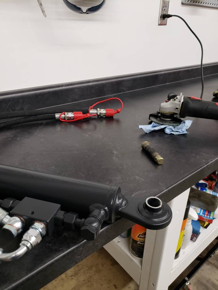

Think it's over $1,200-1,500 for the option. The cylinder alone costs over $850. Mindblowingly expensive. Ya, it's probably custom, but so were my pair of TnT cylinders from FitRite that were cheaper & came with lots of hoses, fittings & other stuff. I'll be using a small 1" Bore x 8" Stroke - 0.625" Rod cylinder that was $41 new.
I couldnt find one that was really any smaller. A 300lbs rated actuator could do the job so no need for a lot of force to break things. 1 square inch of piston will generate 2,500lbs of force. I dont need to do the math to figure out the area of a 1" circle to tell me it will have plenty more than the 300lbs of force its proven to require.

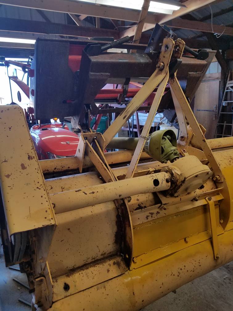

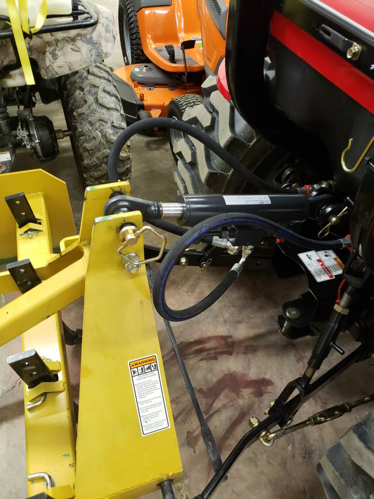

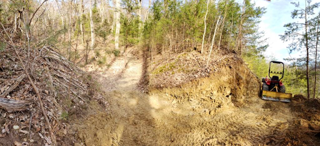

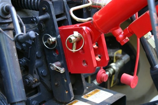

Update after some use this weekend: I'm definitely happy with the hydraulic top link. It has saved me from getting on a d off for adjustments on my latest project....but more importantly it has given me just the clearance I need when in tight spots that would usually cause my box blade to catch. 20190323_184620.jpeg

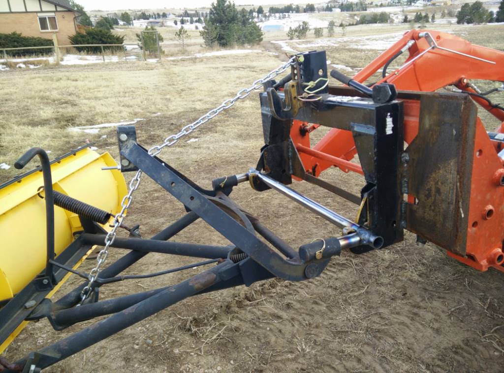

are you planning on using a pressure relief valve to limit the force or just a stroke limiter. I took a closer look at my ssqa after taking the bucket off for the first time and it seems a lot simpler to implement now that I see how the handles are made.
The problem I see will be sourcing a cylinder with the right stroke length and attaching it to the handles. You can't bolt the cylinder onto a bracket because both handles need to move. unless we use two smaller cylinders
Limiting the force could be an issue if I can't find a relief valve that adjusts low enough. I wouldn't want to mangle the pins that move into the lower bracket if for some reason the attachment was not aligned properly before actuating the locking mechanism.
/ Added a hydraulic top link today #32
Fallon,
I got the smallest cylinder I could to minimize pressure. I do have a crossover relief valve to install, but I more got it for my hydraulic post hole digger & was planning on setting it to 2,500psi or so.
On my linear actuator build I measured out the stroke length & got the actuator based on that. It was to short, but I made mounting brackets to fit. I made them adjustable, so could tweak it so it bottomed out the actuator before hitting stops on the handles.
As the setup goes over center to hold the SSQA pins in place there is extra motion in the system. The actuator/cylinder will hold things in place if it stops a bit soon before the handles would go over center
