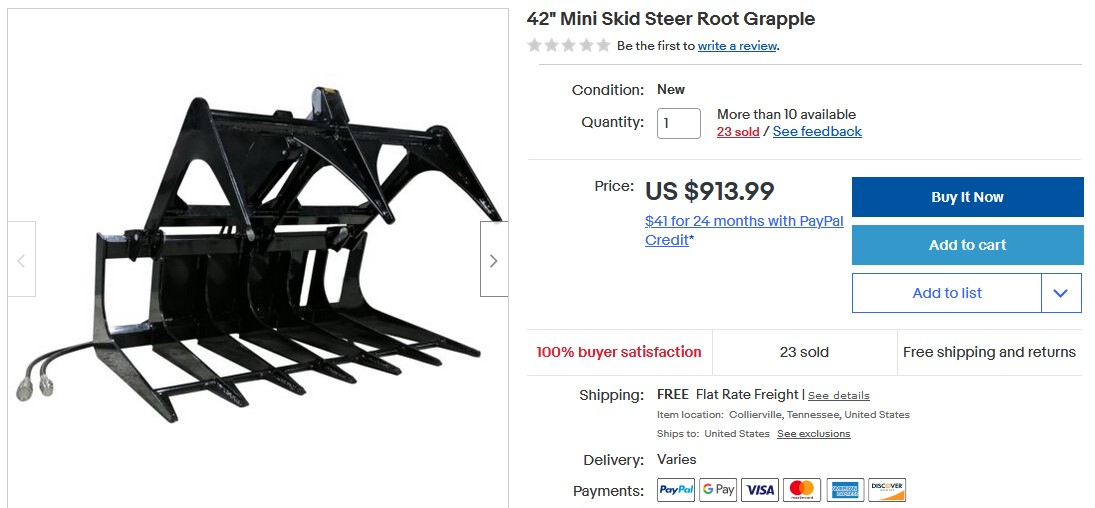

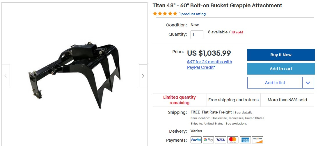

Group,
Long question on bucket grapples. I have an extra bucket (long story) and am thinking of adding a grapple to it. As I was looking at different Add-A-Grapples I noted that Titan’s Add-A-Grapple cost more then their Root Grapple (assuming I would just add a homemade PT mounting plate).
So – What would you do and why?
Thanks much

IMHO a bucket would not do as well to scrape roots, branches off the ground as the root grapple. See my picture in avatar for my new forks/add a grapple setup. There is also a thread if you are interested.

I've modified mini skidsteer attachments to the 425,good match. The dedicated root grapple will definitely be more useful than an adapted bucket. The utility grapple from pt is still the go to tool for the 425s here.

I would buy the root grapple.
As others have stated adding a grapple to a PT bucket would not be nearly as useful. The sides of the bucket make it difficult to grab awkward, oversized objects. The most common use of solid bottomed grapple buckets is moving scrap steel or construction debris. The solid bottom keeps the small bits from falling out, but even those have the sides cut down considerably.
