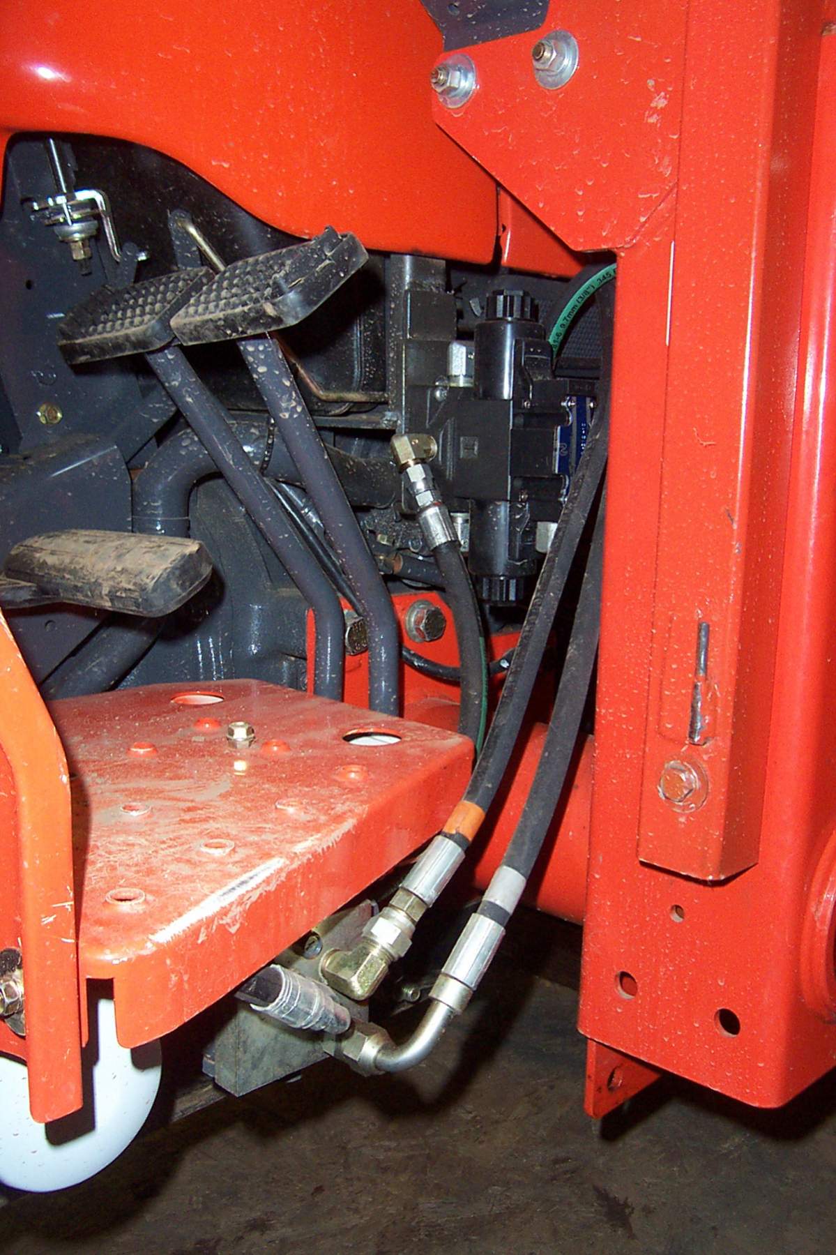

/ add 3rd function to L3400 #5
I added a grapple control to my l3400. I went with electric over hydraulics.
I installed a marine switch on the dash.
I ordered the wrong valve because I ordered an open center valve. We have open center system, you need a tandem center valve
It uses a D03 base, here is the link.
Northman Fluid Power Hydraulic Directional Control Valve 19.8 GPM, 4500 PSI, 3-Position, Double Solenoid, Tandem Center Spool, 12 Volt DC Solenoids, Model# SWH-G03-C6-D12-10 | Power Solenoid | Northern Tool + Equipment
Here is a link to grapple project on a L3400.
http://www.tractorbynet.com/forums/attachments/134273-making-different-grapple-forks-bucket.html
I like your grapel knight, Northern calls for a d05 subplate maby i'm missing something?Whear did you pull supply & return from? I like the grapel being seperate from the bucket.
/ add 3rd function to L3400 #7
I pulled from the power beyond fitting to a loop at the back of tractor for backhoe,to my D03 Block, then it returns back to the main hydraulic block underneath the brake area, from there it feeds 3 point hitch internally in the tractor.
I don't have power beyond so I'll have to do some plumbing research. Still haven't found the do3 base. The picks really help, THANKS.
