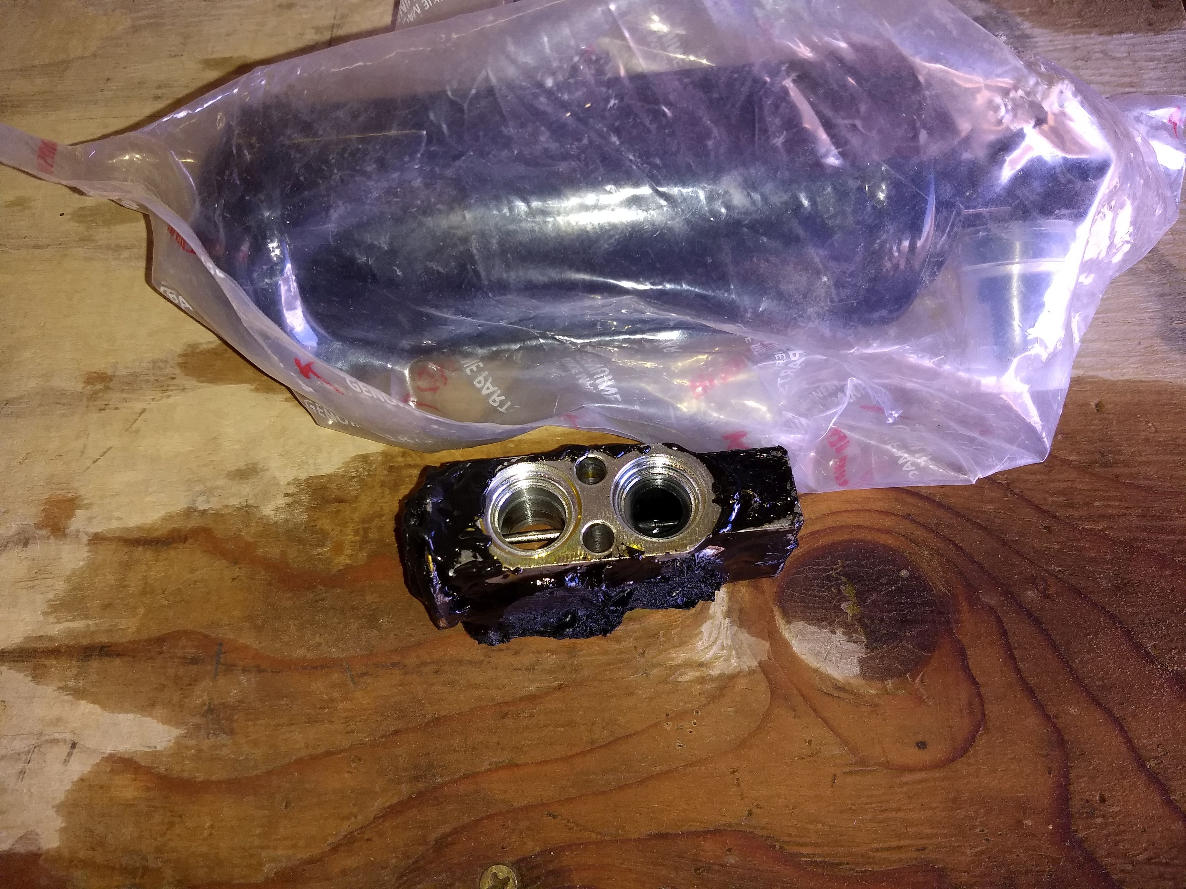

Update.... My tractor AC works! For now. I tried holding a vacuum on the system over night. The system went to around 28"hg immediately. I shut the pump off and came back about 6 hrs later and it had dropped to around 18 or 19". I turned the pump back on and left it until this morning and it had dropped to about 25". I pulled an absolute vacuum again and recharged the system. We filled it to 21 psi on the low side and 230 psi on the high side. We ran the tractor for 15 minutes and the pressures held steady. The air out of the evaporator fell to 49F. So we disconnected the gauges and called it good. Then the amazing thing happened. The hose on the high pressure end gauge had an appreciable amount of water in it! I would guess about 2 tablespoon full ran out.
That is a LOT of water in a small AC system. I am not sure why the water came to reside in the high pressure gauge hose, haven't figured that out. But I am glad it went there as opposed to my system.
So what has been happening is that the water in the system has been accumulating and freezing in the condenser, blocking all flow. Pulling a vacuum for a couple hours is not long enough to evacuate that much moisture. It took doing it all night to get it done. I am amazed there was that much water in there. The system has always had freon in it and has never been left open longer than brief periods of time.

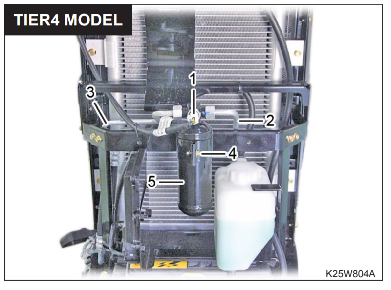

Not having a receiver dryer certainly is a problem. It is also why the system only takes about half as much freon as the book says. From some of the things Bernard posted, Branson may have indeed made a few tractors without receiver/dryers, That is unfathomable! I plan to go back to Branson and insist my tractor be retrofitted with one. I cannot see the system working long term without one.
By the way, it does have a low pressure switch somewhere, because the compressor wouldn't engage until we put enough freon in it.

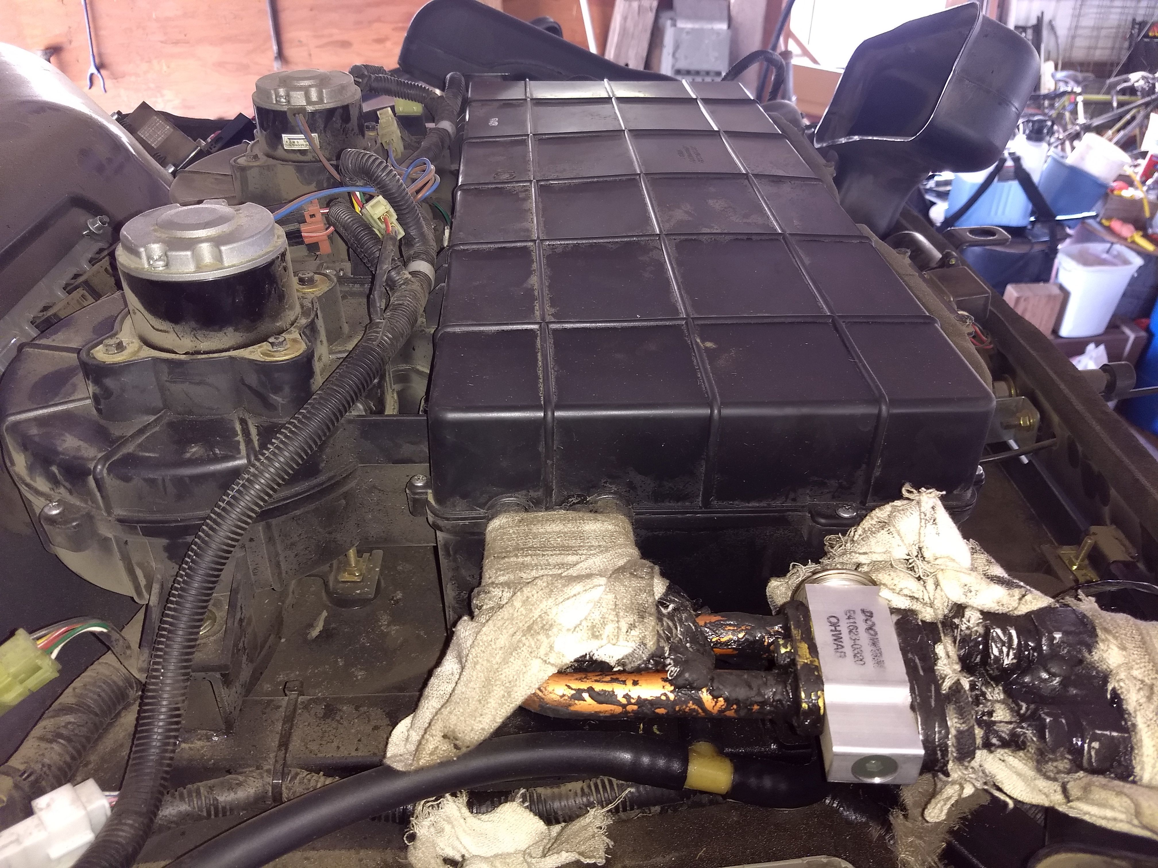

One comment I will make concerning his no repaired dilemma and that is, in post 33 with the view of the roof mount ac components, there is a substantial amount of dirt and chaff on the blower housings and as such, I suspect there is also quite a bit under the evap / heater core cover as well on both HX's and that will reduced the efficiency of them in both heat and cool modes.
Just went through that with my Kubota M9 cab tractor and had to disassemble the housing and clean them both. Made a huge difference in cooling and heating efficiency. Just a little FYI because no matter how good a system works, a clogged with dust and crap HX will degrade efficiency and eventually lead to a frost issue because the HX cannot transfer the cool to the warm air coming in.
You do make a point. I pulled the cover off my evaporator/ heater cores and cleaned them as one of my steps. It is a difficult chore on my tractor. There was substantial amount of dirt on the leading edge of the evaporator. I cleaned it off and I could notice a difference in air flow. However at that point in my project, I had no freon flowing, so the air temperature off the coil was the same (warm) before and after cleaning. I did read last night that if the air flow is decreased via dirt on coils what you will likely see is a drop in the air temperature because the same amount "negative" btu's from the freon evaporating has a smaller volume of air to cool. So it cools it further. Likewise, when you turn your cabin fan to a faster setting, the air temperature off the coils might actually rise, but despite that the cooling of the cab increases because of the increase total amount of heat transfer that occurs. Makes sense.
