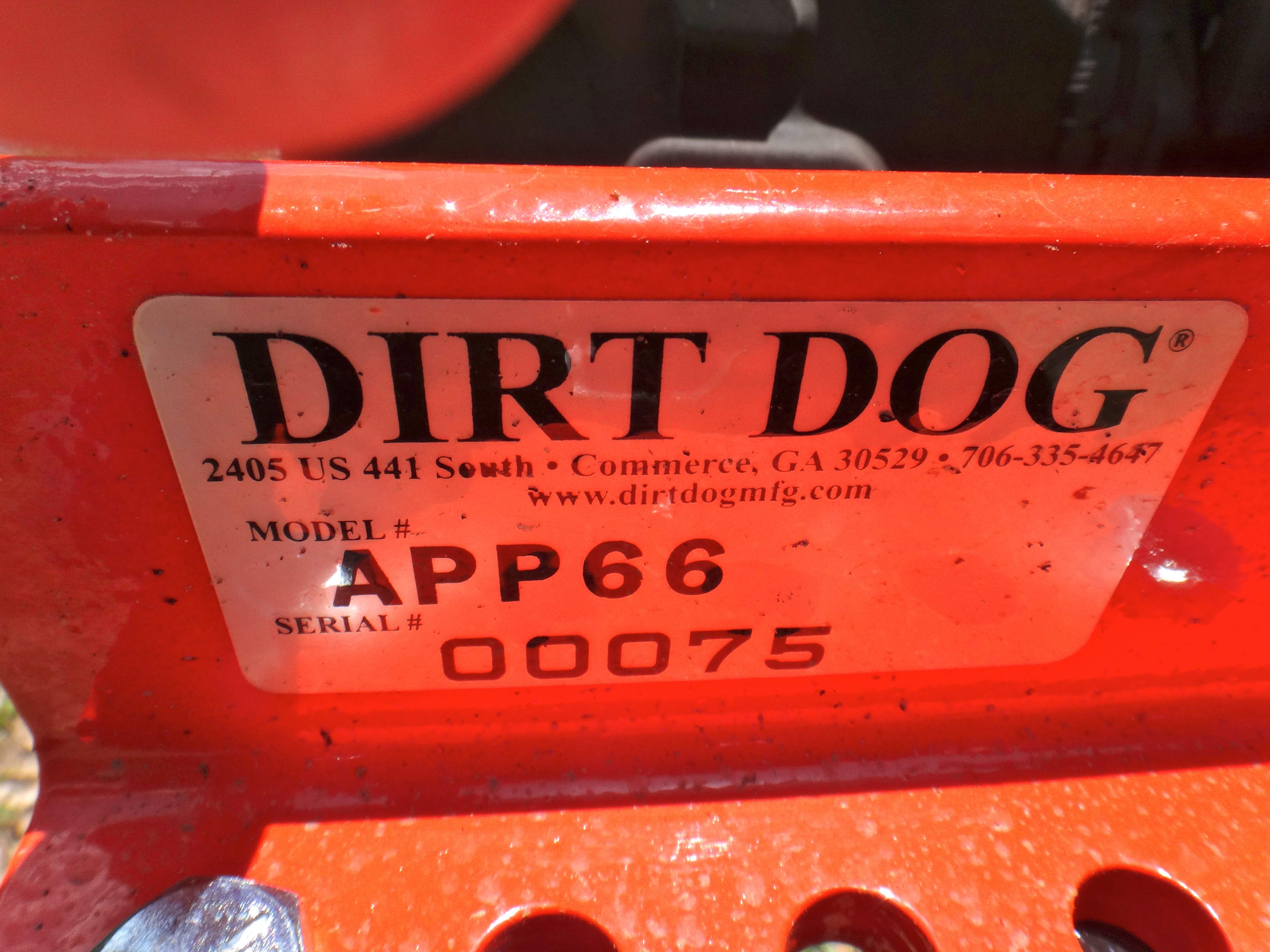

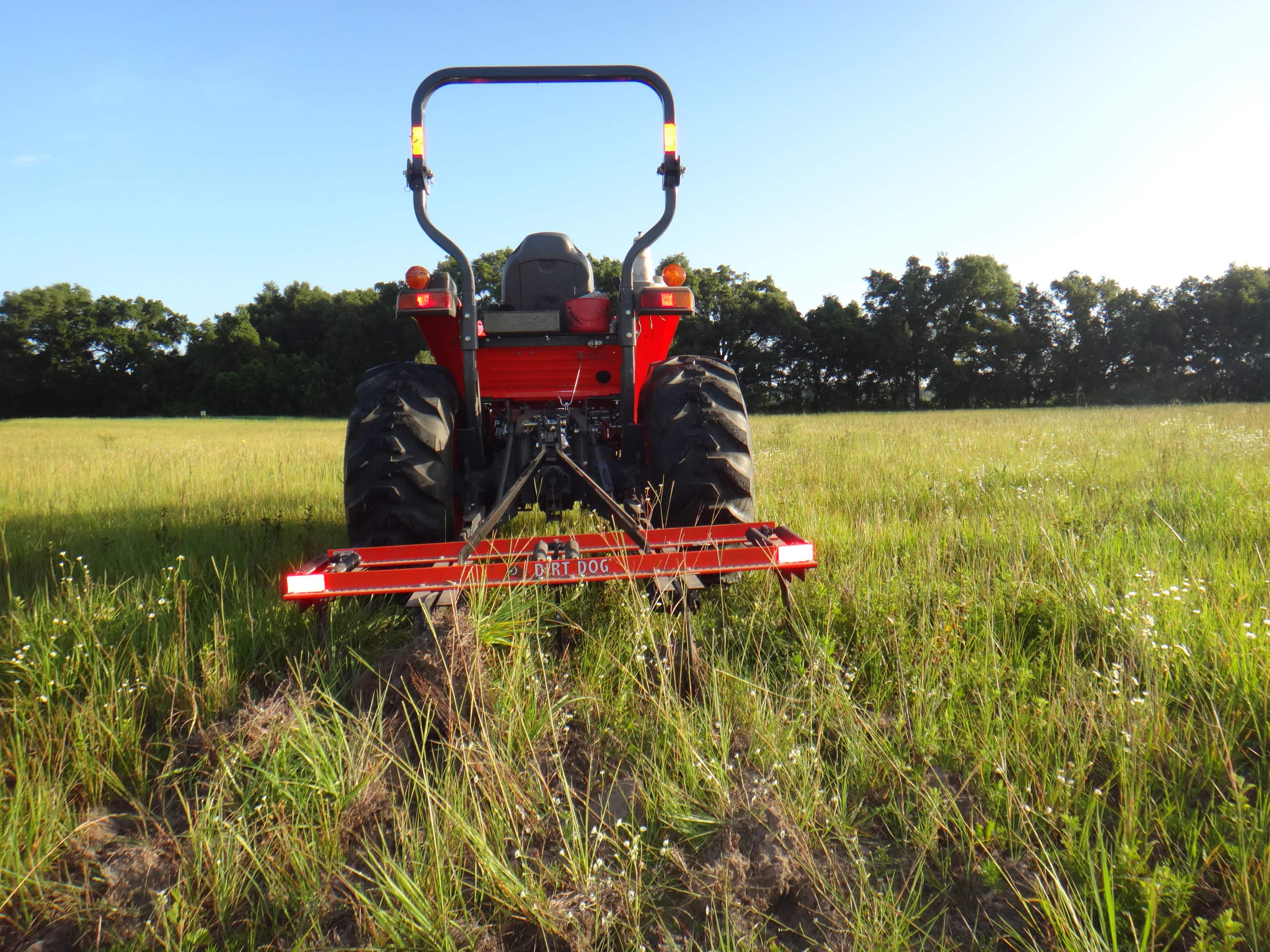

PHOTOS: Only air in those tires. You will probably want some type of pasture aerating implement.
