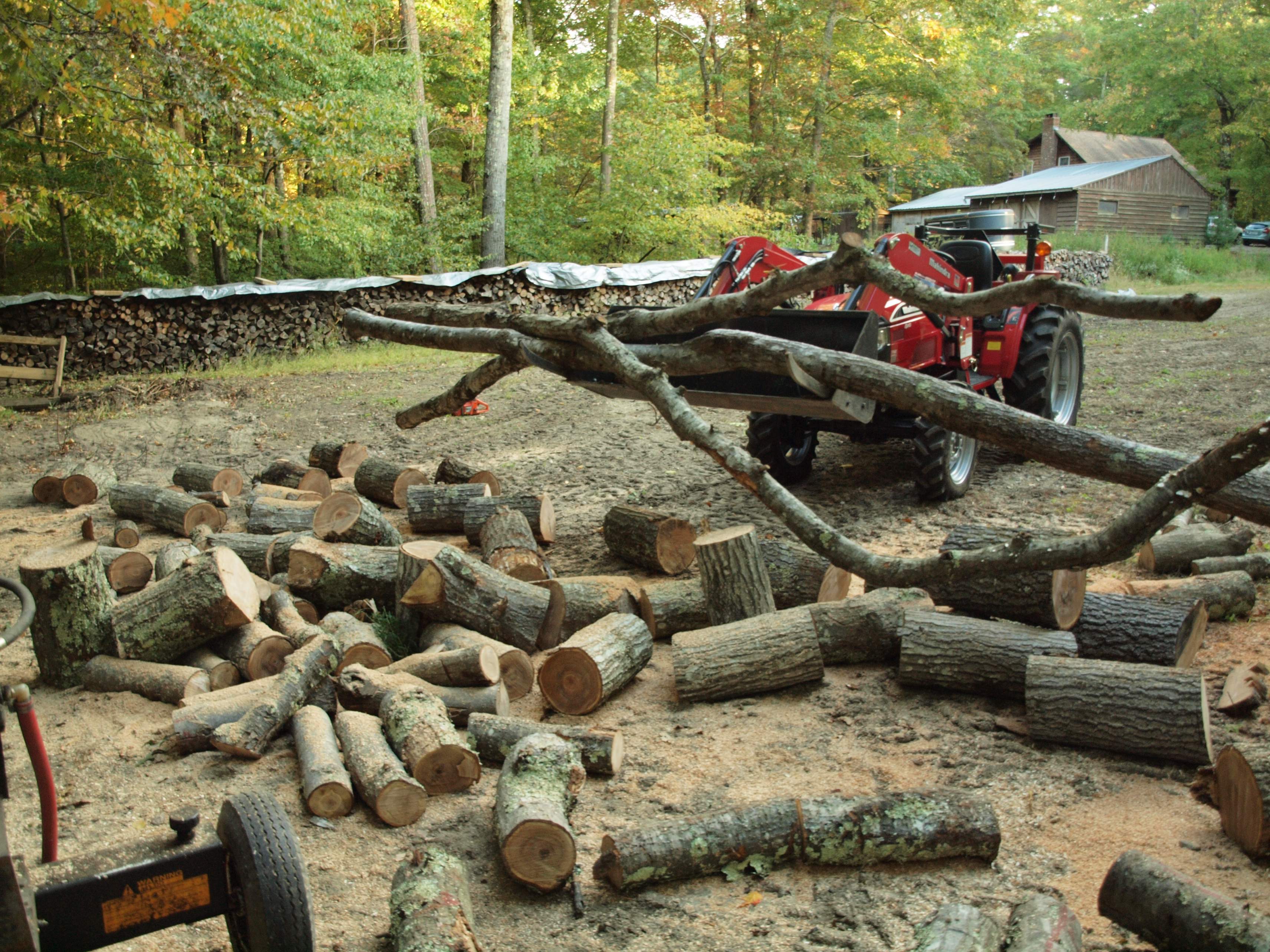

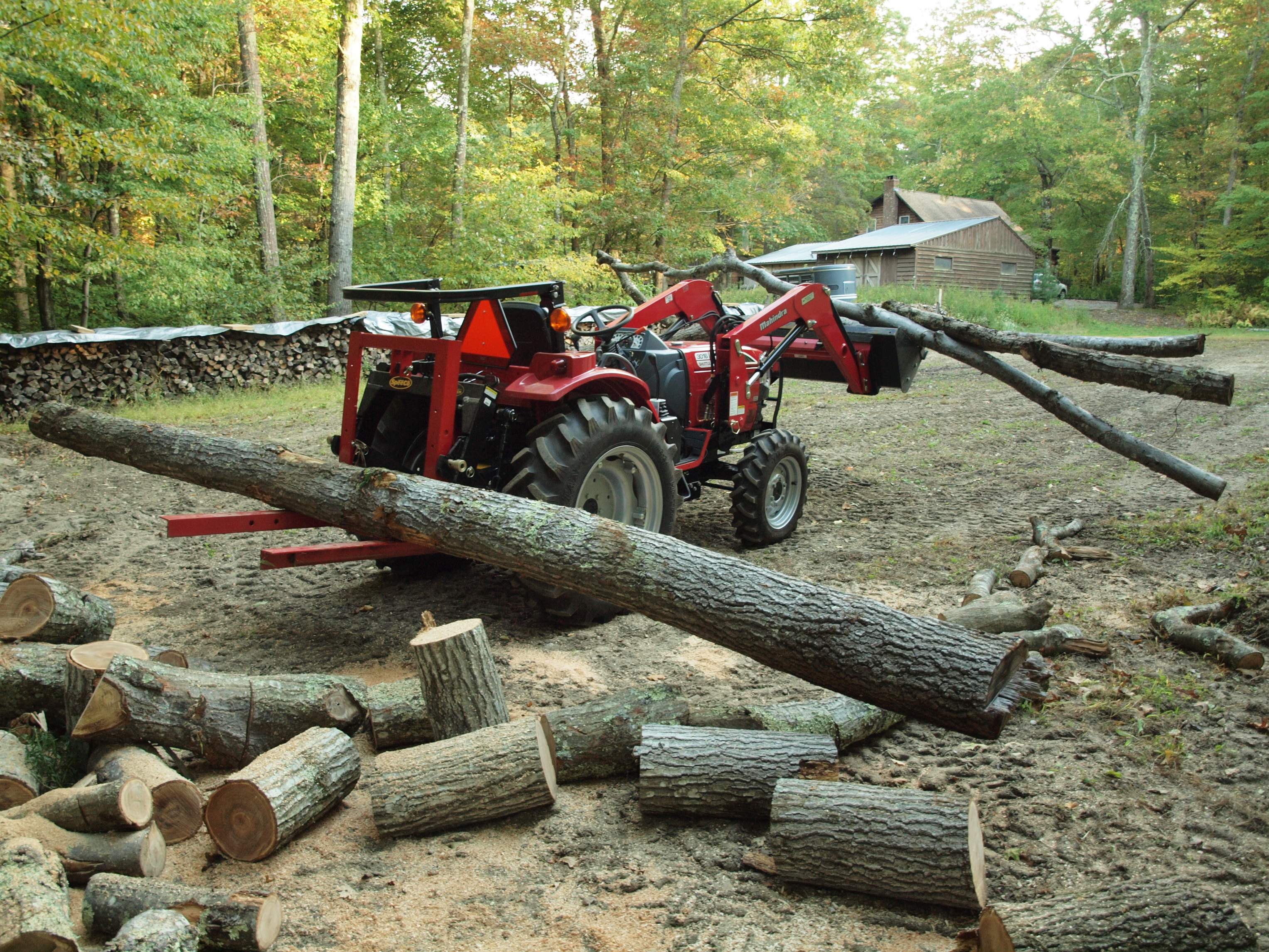

Yes, a Backhoe will be a $7,000 option. Many on TBN feel a grapple is more useful and 1/2 the money.
I consider tractor options fungible. It is not which is good, it is which one or combination will give you the biggest bang for the buck. In turn, this is highly depend on your projected uses, which will change significantly once you begin operating your tractor.
You probably realize the Three Point Hitch is the #1 working part of the tractor. When a Backhoe is mounted the Three Point Hitch is covered and cannot be used.
The FEL+ bucket is the #2 working part of the tractor; rear-center drawbar is trailing #3 working part.

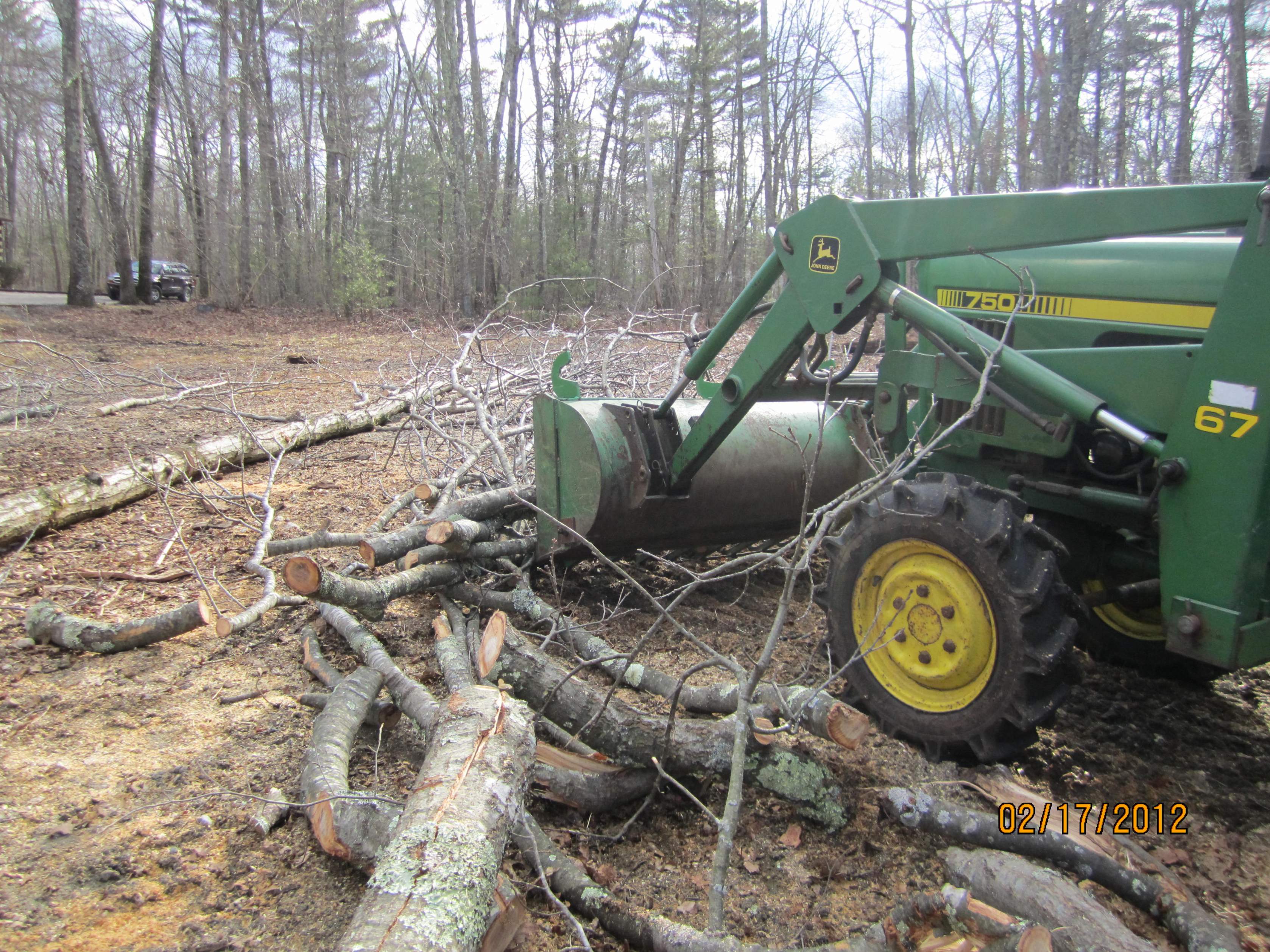

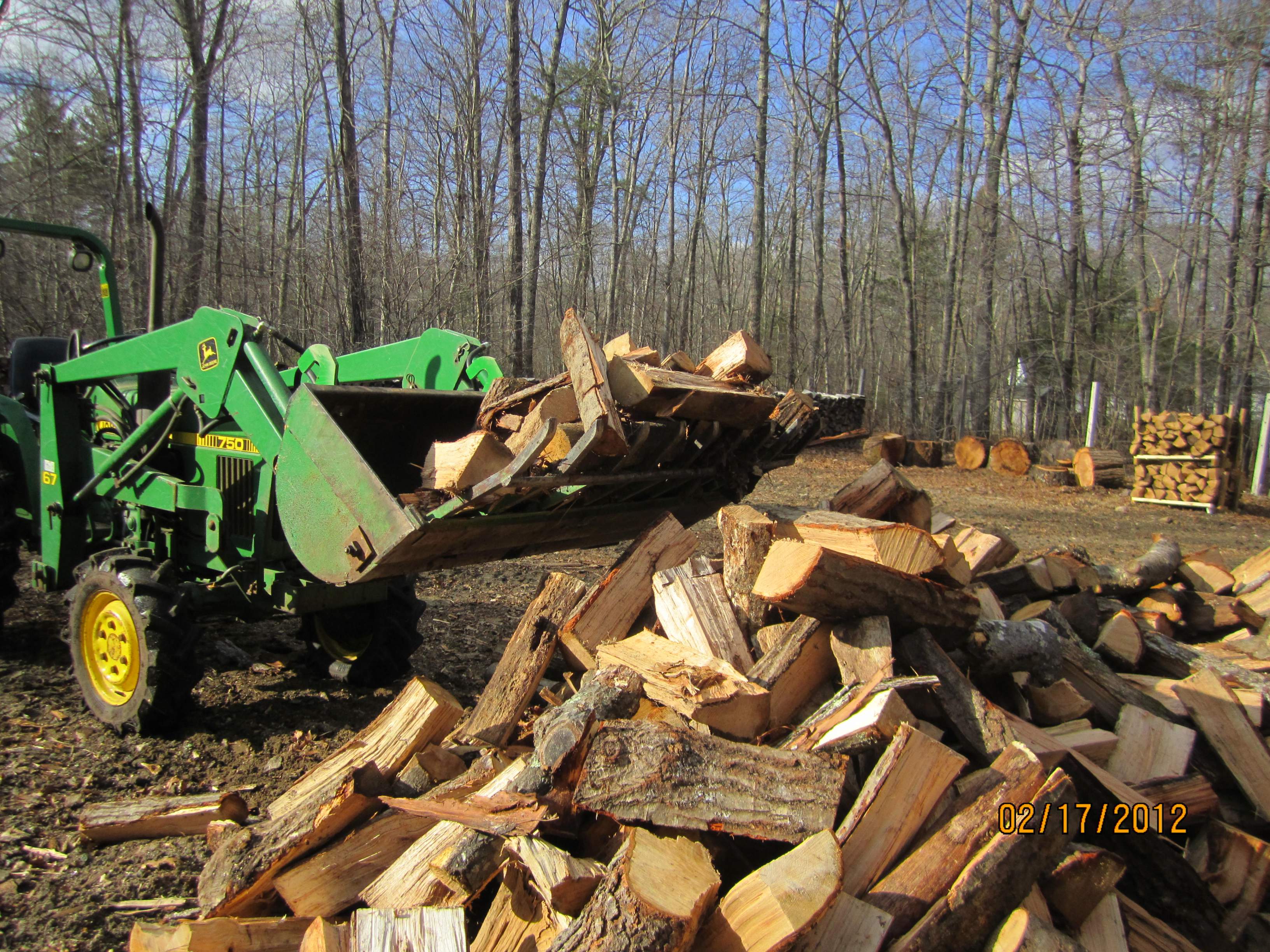

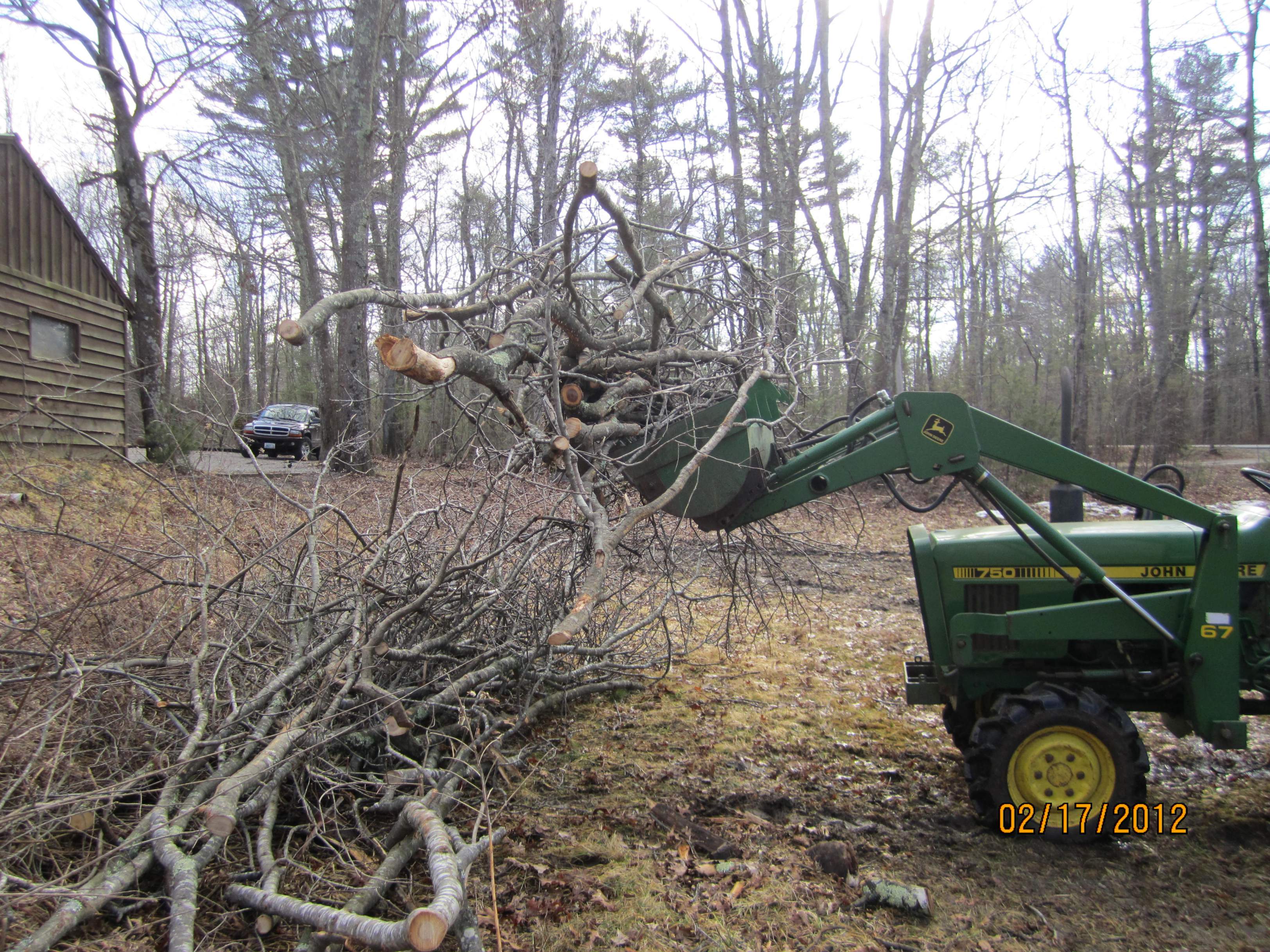

With 35 wooded acres, I can see where a backhoe is going to be needed a lot for thinning out the underbrush/saplings, dead standing trees etc. I only have 11.2 acres and use my backhoe all the time even after 6 years of ownership. The first year or two it was almost a daily use to clear up the overgrown property. Lots of thickets that the trees were so close together that one could barely walk between them. I used the backhoe to dig up probably 75% of them so the others had room to grow. I think you may need to do the same thing. I also have lots of rocks that appear from time to time and over the years I have dug up many tons of them but I am not through yet because they still appear annually.
I also use the backhoe for making holes for planting trees, shrubs etc in the yard, plus trenching for water lines. It is much easier to just put in a remote hydrant rather than dragging 200 feet of hose for watering. So far I have added just one for myself but it was 350 feet distance. I used my backhoe to put in 4 hydrants for my brother in law and bury 4 animals plus one big danged dog(Great Dane) for another neighbor.
So far, I find that I can maintain a gravel drive way better with my Kubota B26 back dragging the gravel with the FEL better that using a rear blade. I think the landplanes would be of more use to you than a back blade.
One thing to look at in choosing your tractor other than comfort and layout of levers is the hydraulic pump capacity in GPM, higher the better.

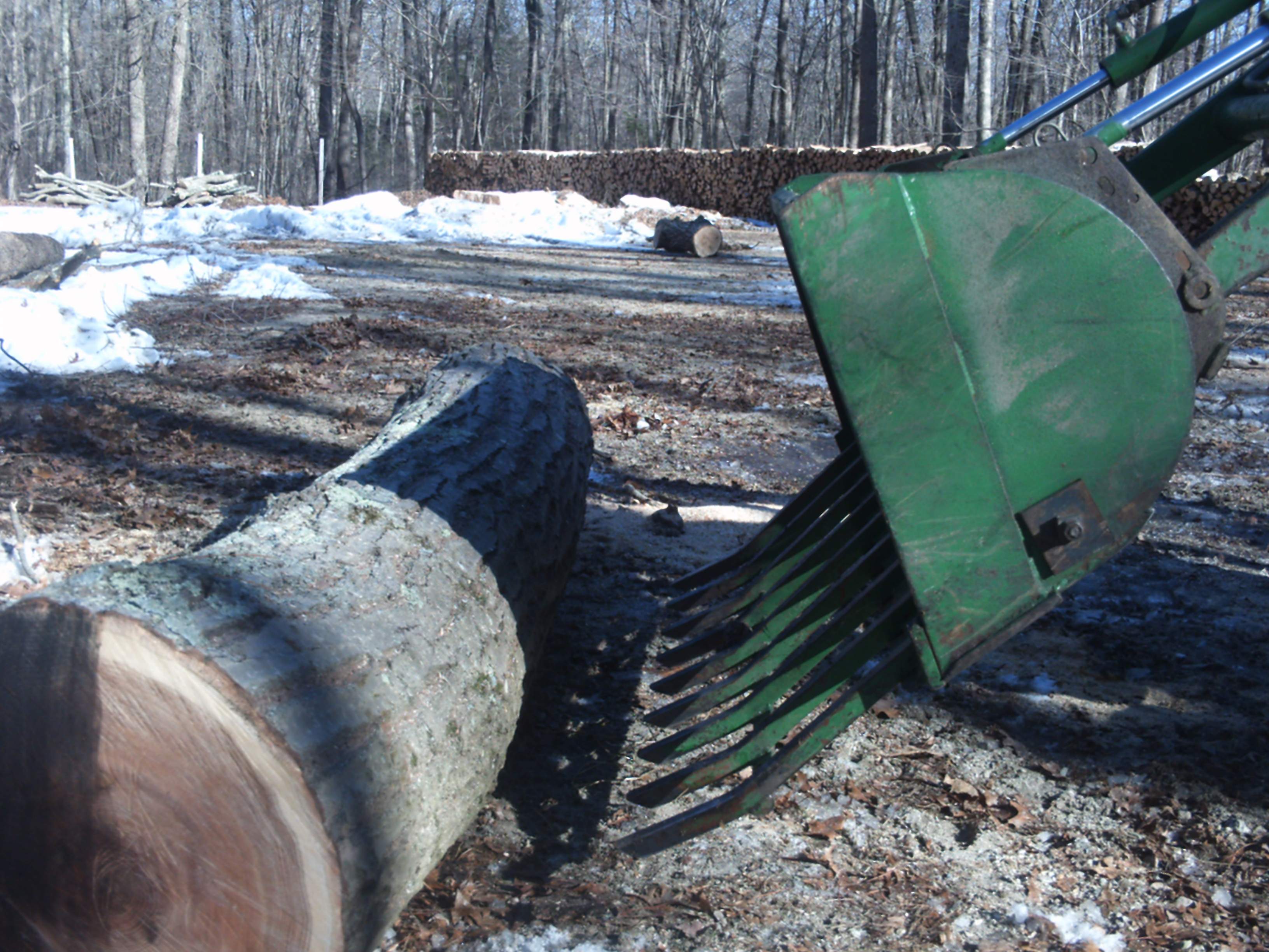

PHOTOS: Ratchet Rake

Photo #5 Tractor Three-Point-Hitch adaptor for pulling trailers and attaching chains used to elevate and skid logs.
