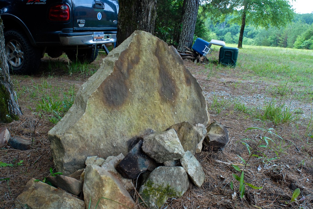

Anyway, we buried him next to the cabin down on my property which was his favorite place to be. A while back I also found a large stone from an old house site on our place. I suspect it was a foundation stone but I think it will make a great tombstone for Dash. There is a picture of it below. It is heavy but I can set it in place with the tractor bucket. It is not hard like granite or marble but it is not soft like limestone or sandstone either. I want to put Dash's name on it but I'm not sure how. Would prefer to carve it in rather than paint or something like that. So all of this is actually to ask how I could go about doing this? I want it to look nice but it does not need to be perfect. I have a Dremel tool but not sure what type of tip would work. I have an angle grinder but I don't think it would be neat enough. I have wood chisels. I have various files. I might could heat up a three sided file and bend it into an L shape to cut into the rock. Any other ideas?

Thanks for the thoughts guys. I had dogs growing up but never got this attached. Dash is the only dog I've owned as an adult. He grew up with my kids. Never thought a dog would mean so much to me. Anyway, I think I found the answer to my question: Dremel makes tungsten carbide carving bits that should do the trick. I'll clean up the face of the stone and have my wife trace out the letters and I should be able to carve them in with these bits. I'll post pictures if/when I get it done.

Sorry for your loss. It sure leaves a hole in your heart that no front end loader can fill. One reason I am dragging my feet on a new dog. Most of the stones in old graveyards were carved with a cold chisel and hammer . A rubber mask and a sandblaster will do it too. The Dremmel should work just take your time.
/ A tombstone for Dash. #8
cut his name and info out of a piece of thin plywood and secure it tightly to the slab and sand blast it.
/ A tombstone for Dash. #9
Sorry I know what a dog can mean to a man. Glue some innertube or rubber roofing to it and sandblast.

You and JPRambo mentioned sandblasting. I think my brother in law has one. So it would cut around the stencil and the letters would be raised?

He was home. He said he took the rock to a local memorial/monument company (gravestone company) and they came up with a design and did it for him. He said the monument guy could also come on-site if the rock was too big, but that would cost extra. I guess they go out to cemeteries all the time to work on monuments and tombstones all the time. Anyhow, they did a real nice job for him.
No, the opposite. The sand eats the stone inside the template and the template protects the rest of the stone. Tombstone companies use rubber masks. I had a schoolmate whose family owned a monument company and lived across the street from the cemetery that we lived next to.
/ A tombstone for Dash. #20
Thinking about it, you can also reverse mask things to get a raised effect, too.
