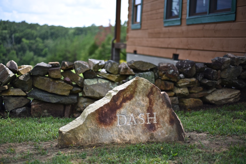

Well, I got the tombstone done. Used a Dremel tool and a couple of drills with some tungsten carbide grinding bits straight out of China. The whole box of them cost less than one Dremel brand bit. They worked perfectly. The rock was actually quite hard in places and this took about 3 hours. I would have liked the letters to be deeper but I got them down about 1/8 of an inch. The rock has a wide base and is about 8 inches in the ground so it isn't going anywhere.

Dan, I had no idea if it would work when I started. I tested one of the bits on the bottom of the rock and it removed material fairly well so I proceeded. My wife printed out the letters in the font she chose and then stenciled them onto the rock with a Sharpee. After that I just started grinding away. The Dremel worked best but got hot fairly often. I used the corded drill for rough work and the cordless drill (several batteries worth) for intermediate work. The bits came in various shapes and each shape had its own strengths. One of the hardest parts was that the 'grain' of the rock was variable. This made cutting neat lines somewhat hard, the bit wanted to jump out of place. The curves in the 'S' were the hardest and the 'S' is not as deep or as neat as I'd like it to be. Also, the composition of the rock varied in that some was softer than others. I'd hit a spot that cut away like sandstone and other spots that didn't want to budge at all.
Like I said, I think it took about 3 hours. It was tedious and slow but once I saw that it could work I just kept at it. At the end of it I was tired. But, if I'd spent another couple of hours I could have cut the letters deeper and possible neatened them up a bit too. But, I think this will do. If I need to work on it some more, well, it isn't going anywhere.
Also, as mentioned, these cheap Chinese bits held up very well and do not look worn at all. I think with an air compressor and a die grinder with those bits, this would have been much easier and faster.
