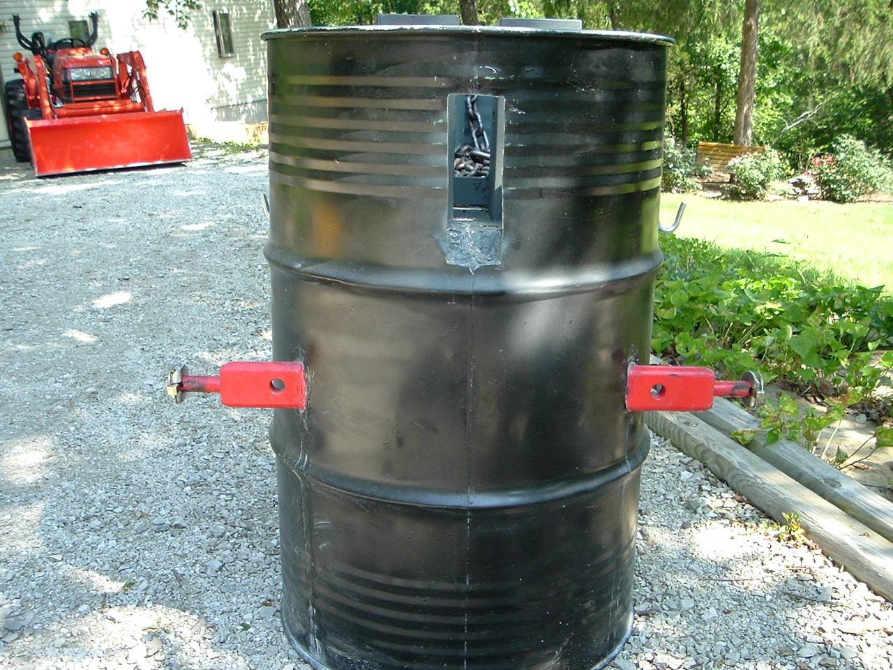

When I did mine [BB] I fussed around with locating the top link so as to keep things simpatico......until I decided to situate the drawbar above the center of gravity on the barrel....and omit the top link connection altogether. The barrel remains vertical in all positions, rests on the ground when the tractor is not in use and the capacity of the barrel to pivot on the pins offers some forgiveness in the event that I back into something.

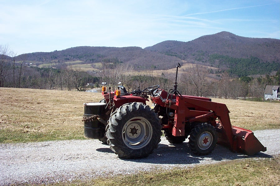

Im with you on that one, I used a 35 gallon steel barrel, about 700 lbs I believe, and situated my 7/8" bar just under the first rib down on the barrel. That thing hardly even moves, and I have taken it over some pretty rough terrain.
KOua, very nice job BTW !

Just keep in mind, that the tractor shown above is quite large, and has a lot of lift on the 3pt. so attaching above the center of gravity was easy and still getting the ground clearance he wanted to achieve. On a smaller tractor, without as much lift distance in the 3pt. you may not be able to attach up that high to get above the center of gravity of the barrel to not need the top link and still get enough ground clearance

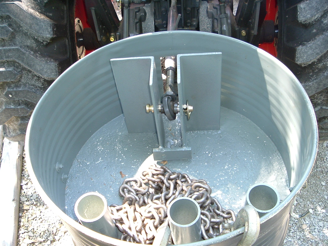

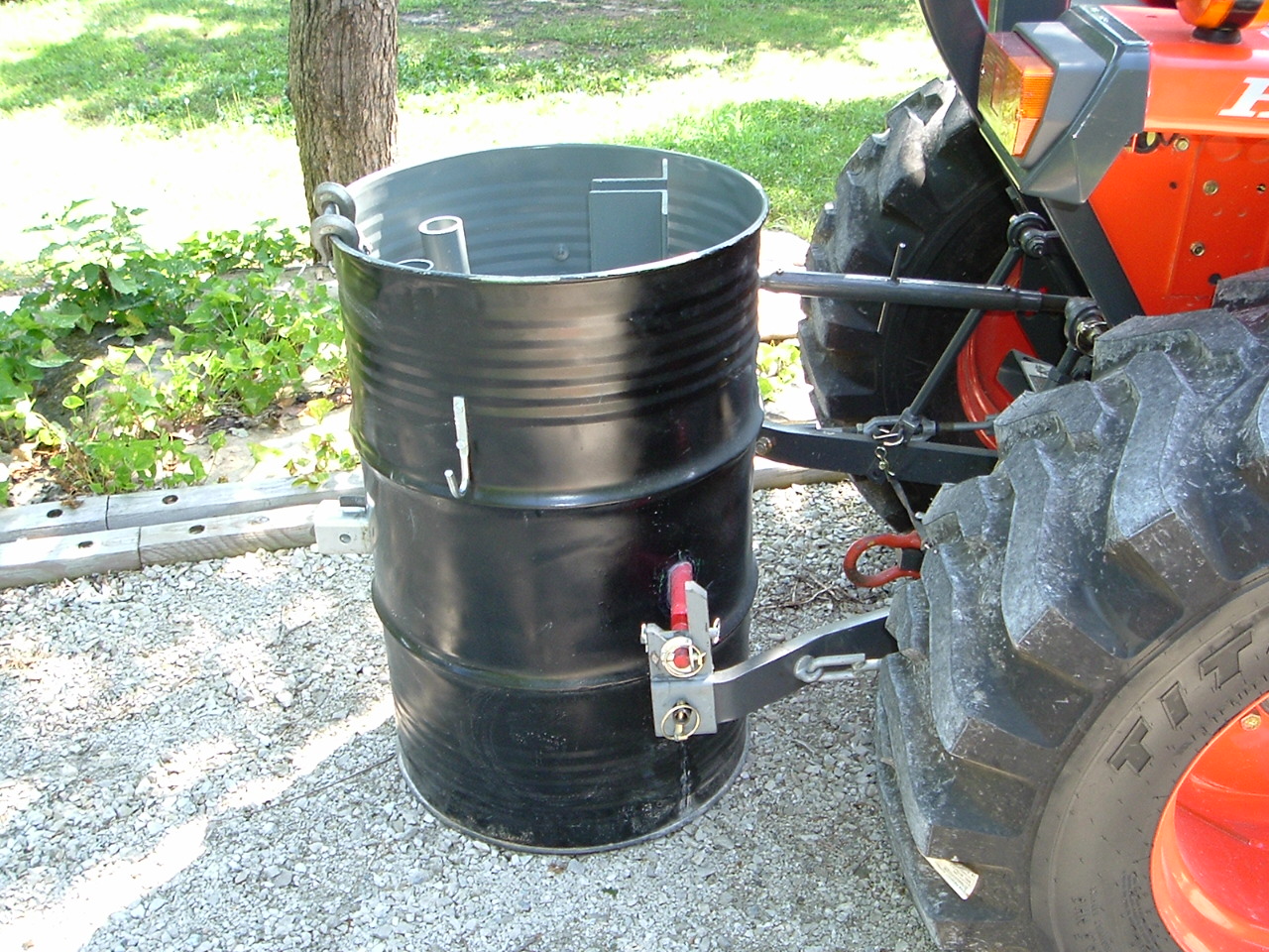

Very interesting ideas! Would like to fab something like that for my B9200 but am not sure how you folks determined how much weight to use. I lifted a 55 gal drum of fuel oil with the forks I built from plans on this site. Everything worked well but had the feeling I was at the limit for this tractor. I have loaded turf tires. Sure would appreciate any suggestions. Thanks, smoker
I also have the Kubota B9200Hst, and the lifting weight on the 3pt is about 450. A 55 gal barrel of water weighs about 440 lbs. If you are going to use a 55 gal barrel, only fill it about 1/2, to 3/4 full of cement, and stick some 2 in PVC pipes in it for rakes, shovel, with a space for chain laying in the top.

Thanks for the compliment Scotty, I have enjoyed having it, and using it. It has been very handy to carry things, and helps keep my "rear end" on the ground where it belongs:thumbsup:
James K0UA

But if I was going to build a barrel weight, I would consider a cat. 1 draw-bar and poke that through the barrel, and fill with cement. This would be stronger than re-bar as far as bending, and they only cost $20 or so.
Be careful so you don't make the thing to heavy for your tractor. There will be a lot of jerking around back there and you don't want to rip something off the rear end. I never heard of that happening, but I'm new here.

I paid off the safety police so I'm good now :). I'm using a 30 gallon barrel and am having a slight problem deciding on how to overcome the weight thing. My tractor a Kubota B9200 has a lift weight of 450 lbs. 22.5 gallons or 75% full is already at that weight. I want to use the above center idea to eliminate the third member. I'm worried that the amount of concrete above the tow bar won't be enough to support it. Thought of building up the bottom with some stone???? What's the best idea? Thanks folks, smoker

... Make a couple U shapes out of rebar to extend down into the concrete.
