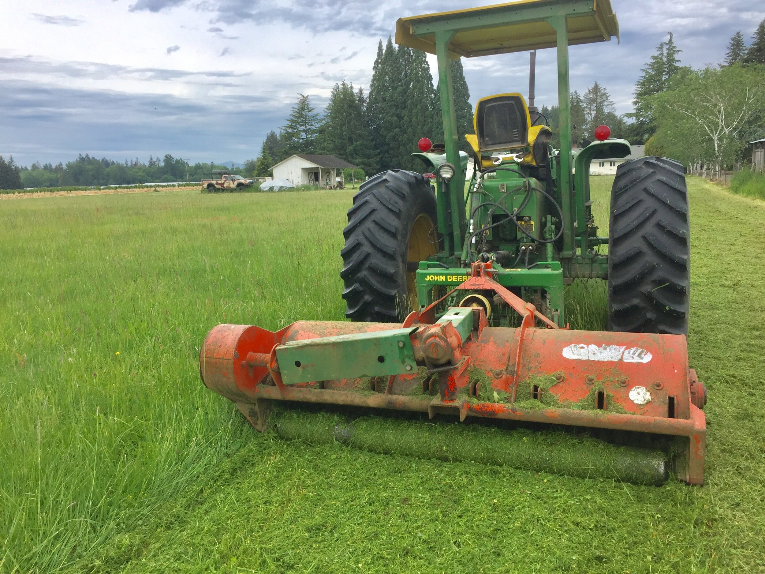

Are you running blades or hammers on that flail? I run hammers on my Maschio and have never had this issue in grass and weeds much taller than this. Mine actually grinds what it cuts into mulch.

I have a heavy duty Rears flail and have never had a problem like you describe even cutting grass and weeds four feet high. It just shreds everything wet or dry. 9DFE6C5C-BBE3-4F89-9C99-638A678DBD62_1_201_a.jpegMaybe your flail is a light duty mower?
