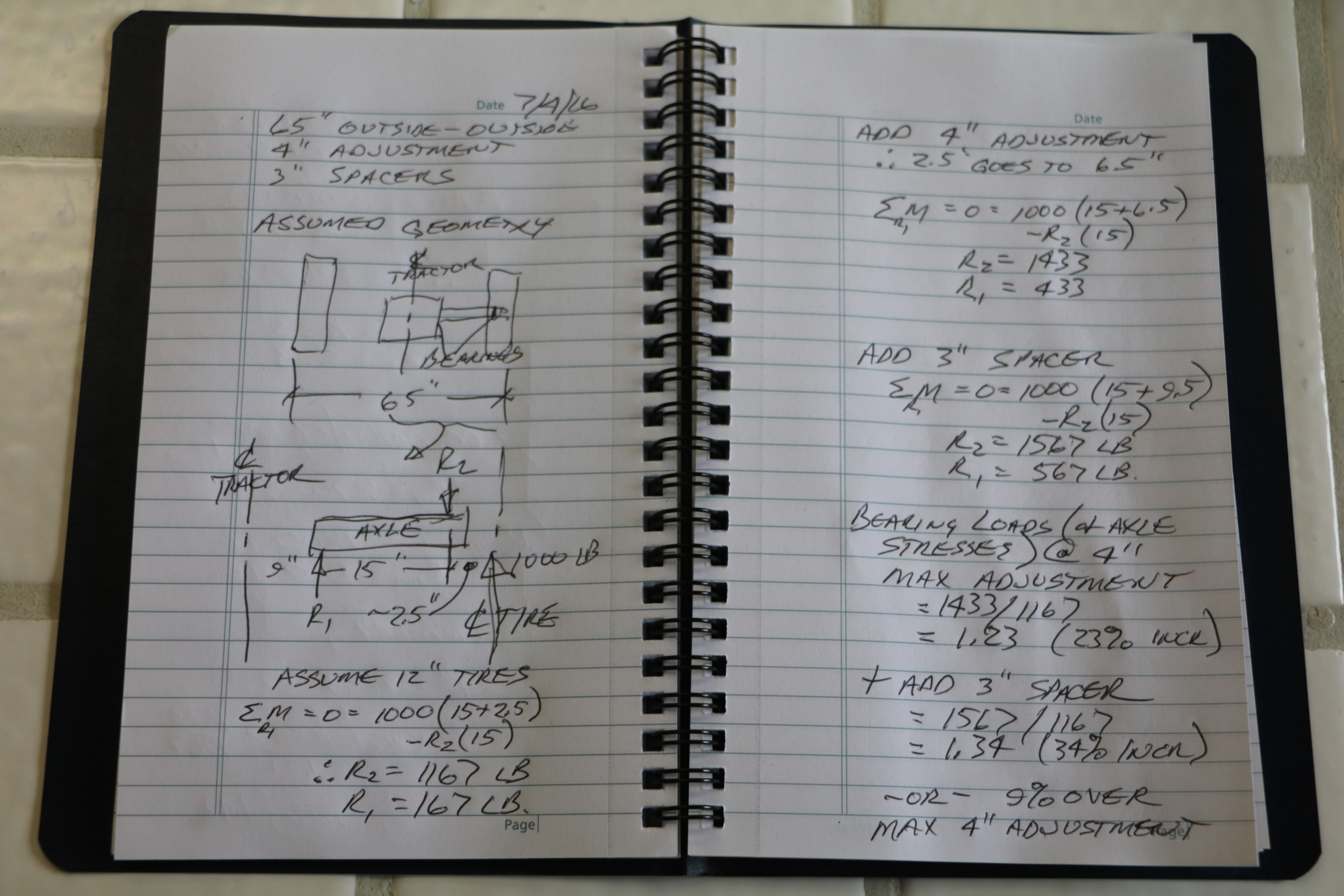

My Kubota with AG tires had adjustable rims.
There is about 3-4" of adjustment in the rims.
I just bought wheel spacers that are 3".
Just on the science theory, which way would make the tractor more stable on a side hill?
Say the outer part of the tires touching the ground is 65" as a baseline with both settings.
With the "rim" sticking out past the end of axle or the end of the axle/spacer sticking out past the "centerline" of the tire vertically,
Causing a bit of cantilever. Which would be more stable in respect to the center of gravity overturning the tractor on a side slope.
Yes I know. Both is better.
Inquiring minds want to know. I know some of you will ponder this. **** OCD![/QUOTE]
Let's apply some actual numbers to this thread...
Here's my read on this. I made some very basic geometry assumptions for only one condition - 1000 lb. vertical load at the tire centerline. Generally, everything will be linear for any given load, i.e. if you double the load to 2000 lbs, the bearing loads will also double.
I looked at 3 geometry conditions; baseline, 4" adjustment, and 4" adjustment + 3" spacer. Each condition will give greater side slope stability, and will increase bearing, axle, diff. housing, etc. stresses as shown. I've treated the axle as a free body, meaning the forces and moments (bending) acting on it must balance so it remains static. This is why the bearing loads are not equal to the 1000 lb. applied load.
Bottom line; assuming the 4" adjustment is OEM approved, adding the 3" spacer will increase local stresses by about 9% FOR MY ASSUMED GEOMETRY. Your results may vary.
I'm guessing most of us guys on here do the occasional overload. Note however that this will be all the time and for all load conditions.View attachment IMG_1718.JPG

You really need to know the spacing between each axle bearing pair, and the placement of wheel center wrt the outer bearing to get a good handle on % load increase. ... The proportion increase in bearing load seems it would be much higher -- ~ 50%
