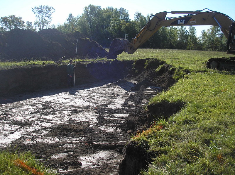

Just started the foundations for an 8-box horse stable. This will be a monitor-style (raised center isle), hopefully finished and fenced in for next summer.
Got contractors with Big-Boys to excavate and put in a road - my baby BX can't cope with this amount of earth moving - 36x48 foot foundation (5 foot deep) and a 200-odd foot trench and 200+odd foot road.

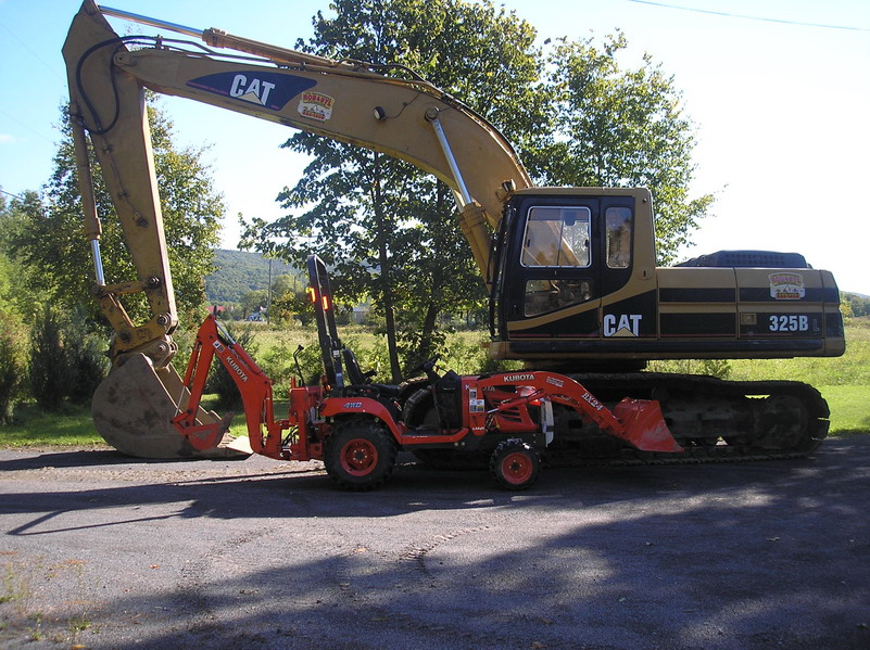

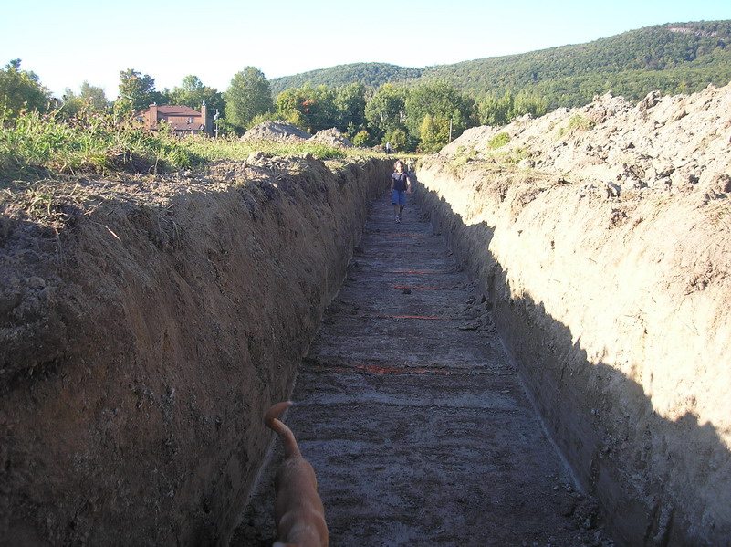

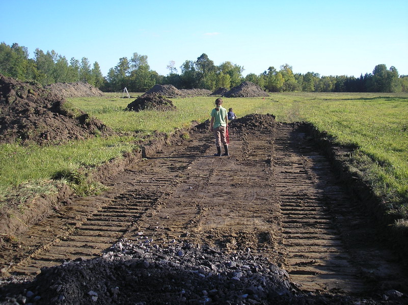

Looks like a nice project. What is the trench for?

What is the purpose of that trench that leads away from the pit?
/ A new horse stable
The trench is for drainage - the stable foundation footings are drained (French drains) and the output goes out the trench. This is heavy clay soil, so the water around the footings needs to be evacuated.
The trench is (alot) wider than I wanted it, but that was the bucket width of the excavator. This will be fun to fill in with the bx24...

Very impressive pics. I really love the one with your Kubota and the Trackhoe. If the lighting was a little better, I'd think about framing it!!!!

Here you go, Eddie!

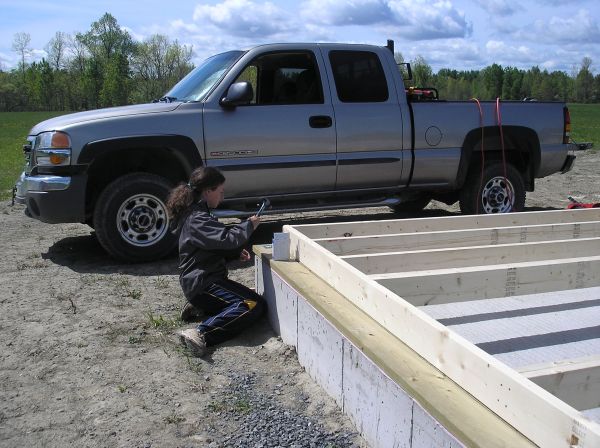

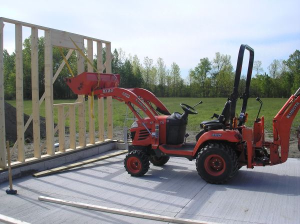

Well, its been somewhat snowy winter and a wet spring, but the stables construction has been restarted.
This spring I did the following to get prepared for the framing:
-dug a 4+ foot hole on each side of the foundation wall in order to bore a couple of 4.5" holes that we forgot last autum. Bx24 came in handy there. Also installed the plumbing for well-water input and waste-water output.
- skimmed of about 2+ inches of gravel fill in order to increase the concrete floor thickness.
- added some poly and and 1" styrofoam sub-slab insulation.
- poured the slab!
Now that the prep work has been done, the fun of framing begins. I've got the mud sills installed and have started nailing and raising 12-foot long wall sections. The bx24 come in handy for raising the walls as shown in the photos - using the tractor makes it a one-man show... except for the rare times the kids want to get involved.

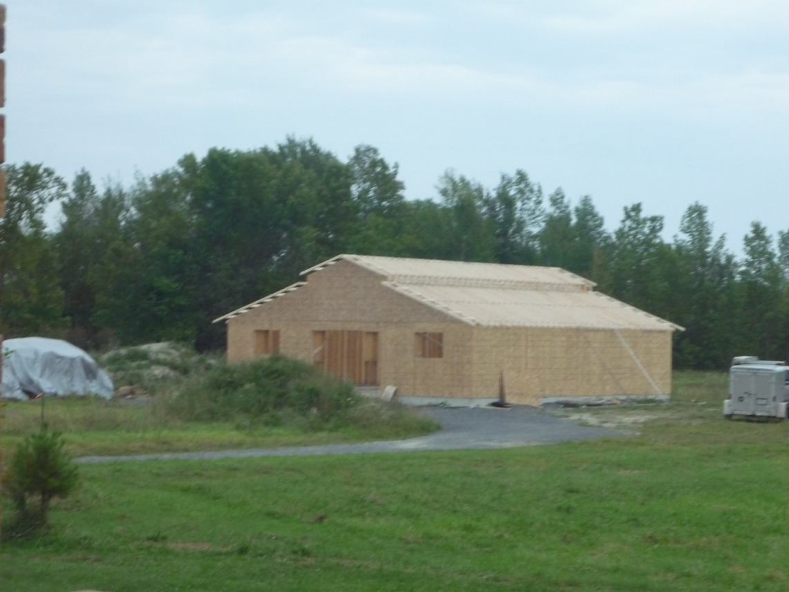

Here's a quick update - got the walls up and finishing up the sheathing. The roof trusses will be delivered next week...

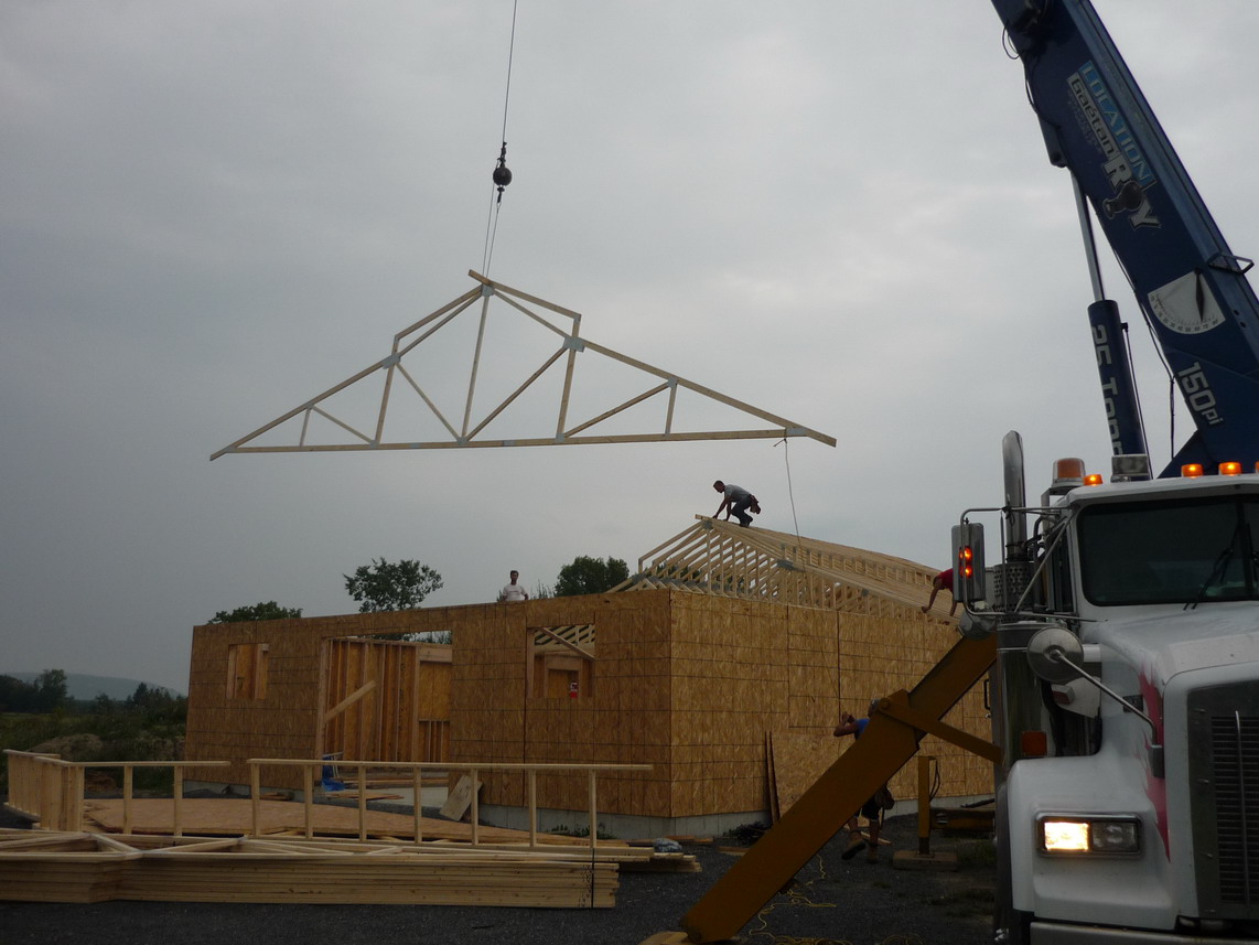

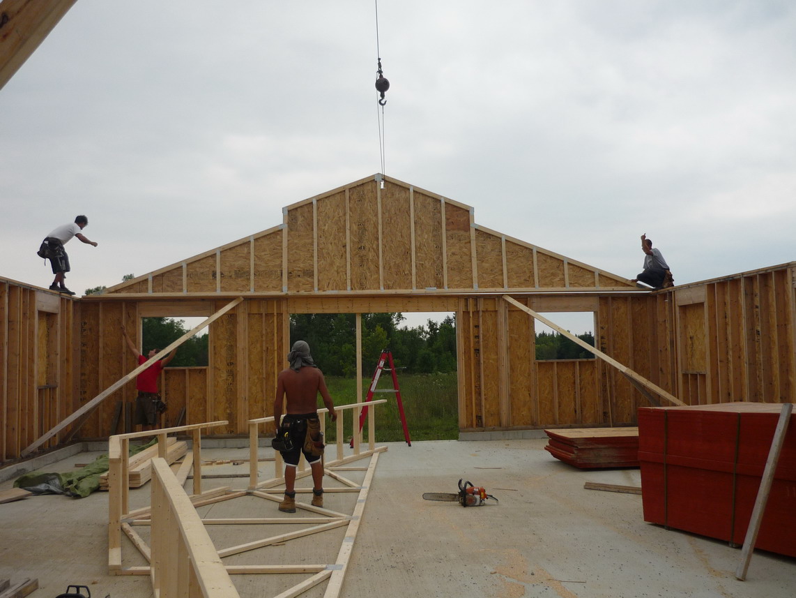

Finally got the roof trusses delivered and installed. Got some OSB on the roof too. I didn't do this work myself - hired a pro crew to do this. Those guys really know what they are doing. Here in Quebec, framers go thru a 2000 hour apprenticeship and a tough exam.
Anyways, got the metal roofing order and I should start installing that this week.
Here's some pics of the framers in action...

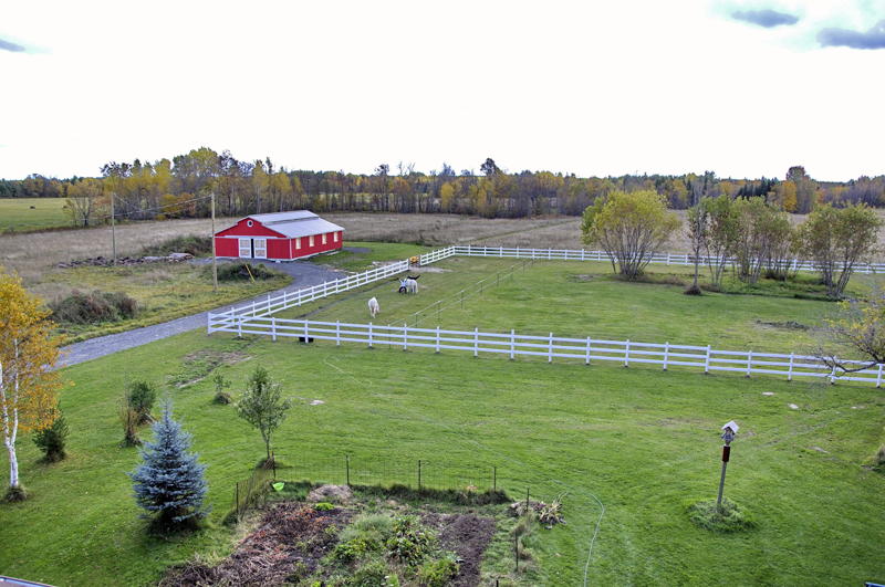

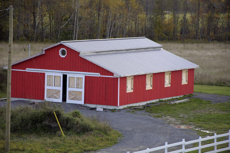

Its been a while and it seems I haven't done much in the past year. What I did this summer:
-finished soffits before too many pigeons moved in.
-installed metal roof.
-built and installed hanging doors front and back.
-cut out, built and installed stall windows
-applied housewrap and straping to exterior walls
-applied pine board&batten to exterior
-painted (C3-brand solid latex stain) red siding - got to cold to do the back wall
-started on white trim
-tamed some pasture, cleaned out junk, and filled in low spots for horse paddock
-built 3-board cedar-post fence
-painted fence white - kids helped for 2 hours then got bored.
-got electrical panel in and got power
-started on tack room walls
In progress:
-redigging 1200'+ ditch in main (wet) pasture
-insulating half of barn (hay in other half)
-laying out and install of 6x6 cedar posts of 4 stalls
What I didn't get done (my planning was too aggressive):
- 300-foot water line from house
- hay storage shed
- pasture fencing
- horse stalls
I added some pictures taken from the roof of the house...
Also, I'm gonna need a bigger tractor...

That's a nice looking horse barn! Will that be pasture out behind it? Your place looks very neat and well kept.
Dave.
/ A new horse stable #20
Looks very nice. I'm curious why you put trusses in a monitor style barn. Doesn't that kind of defeat the purpose of the raised center aisle (loft)? Was it that much cheaper to build with trusses?
