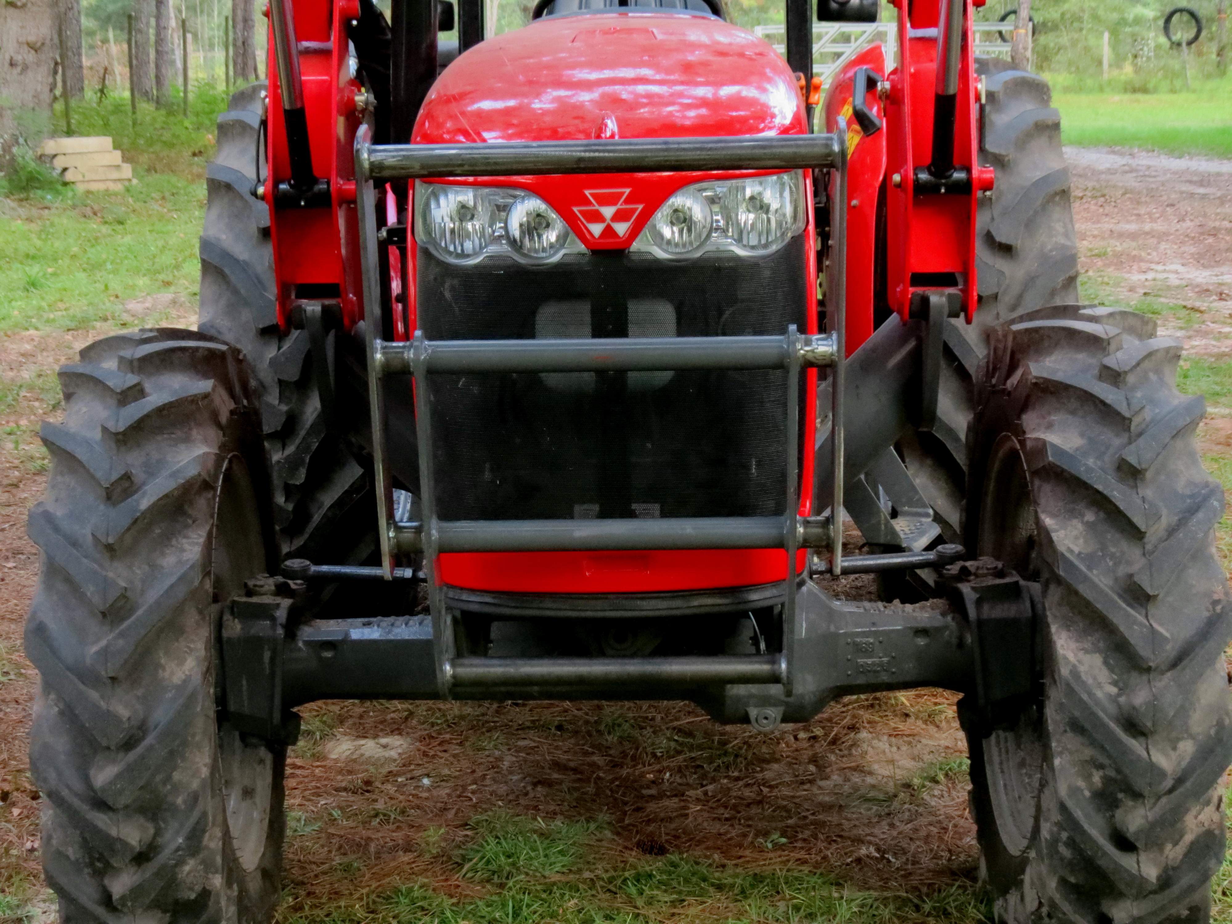

What do you have mounted on your grill guard?
Can I get a better picture of the grill guard?
I'm been thinking about modifying mine.
thanks,

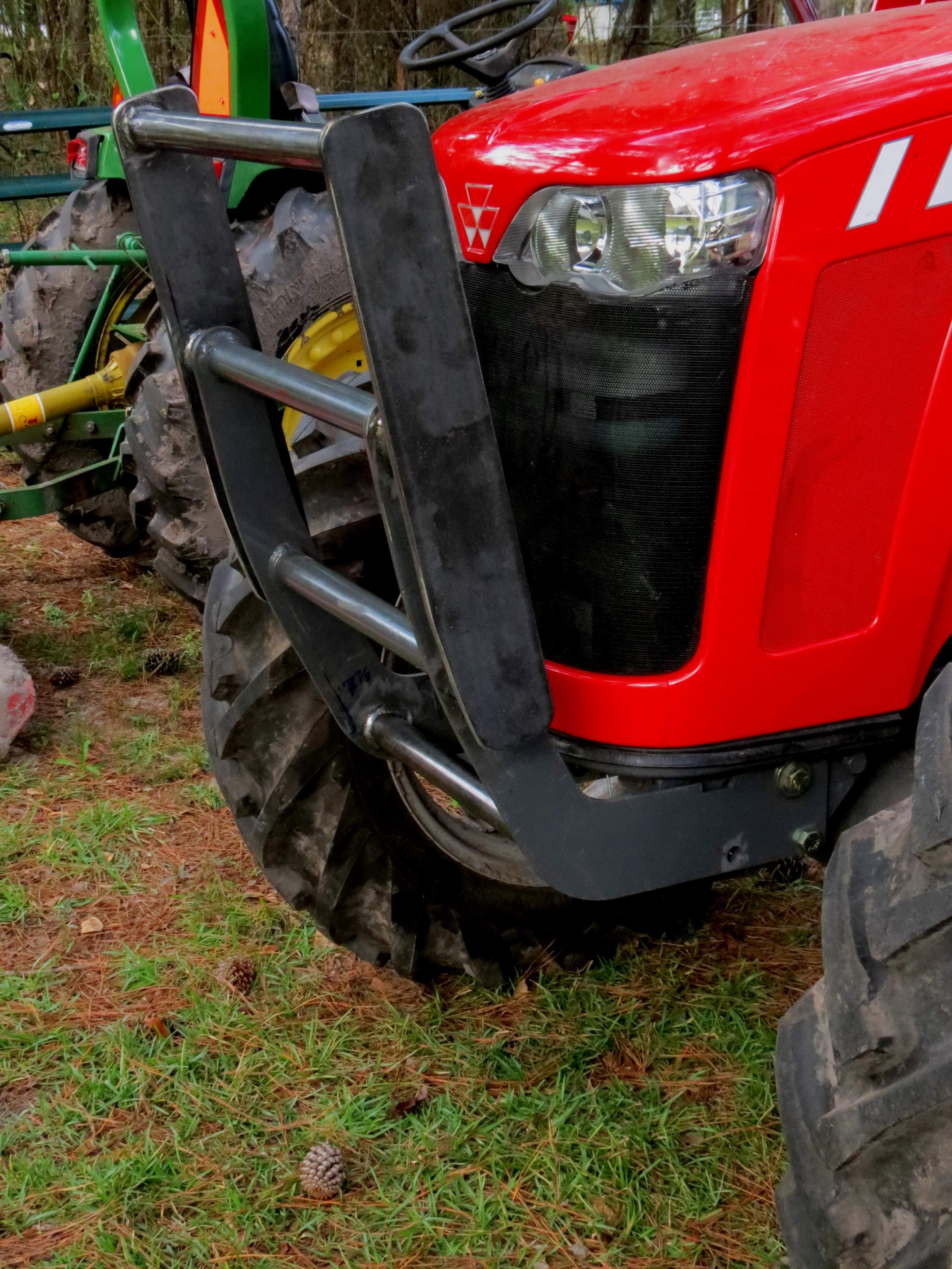

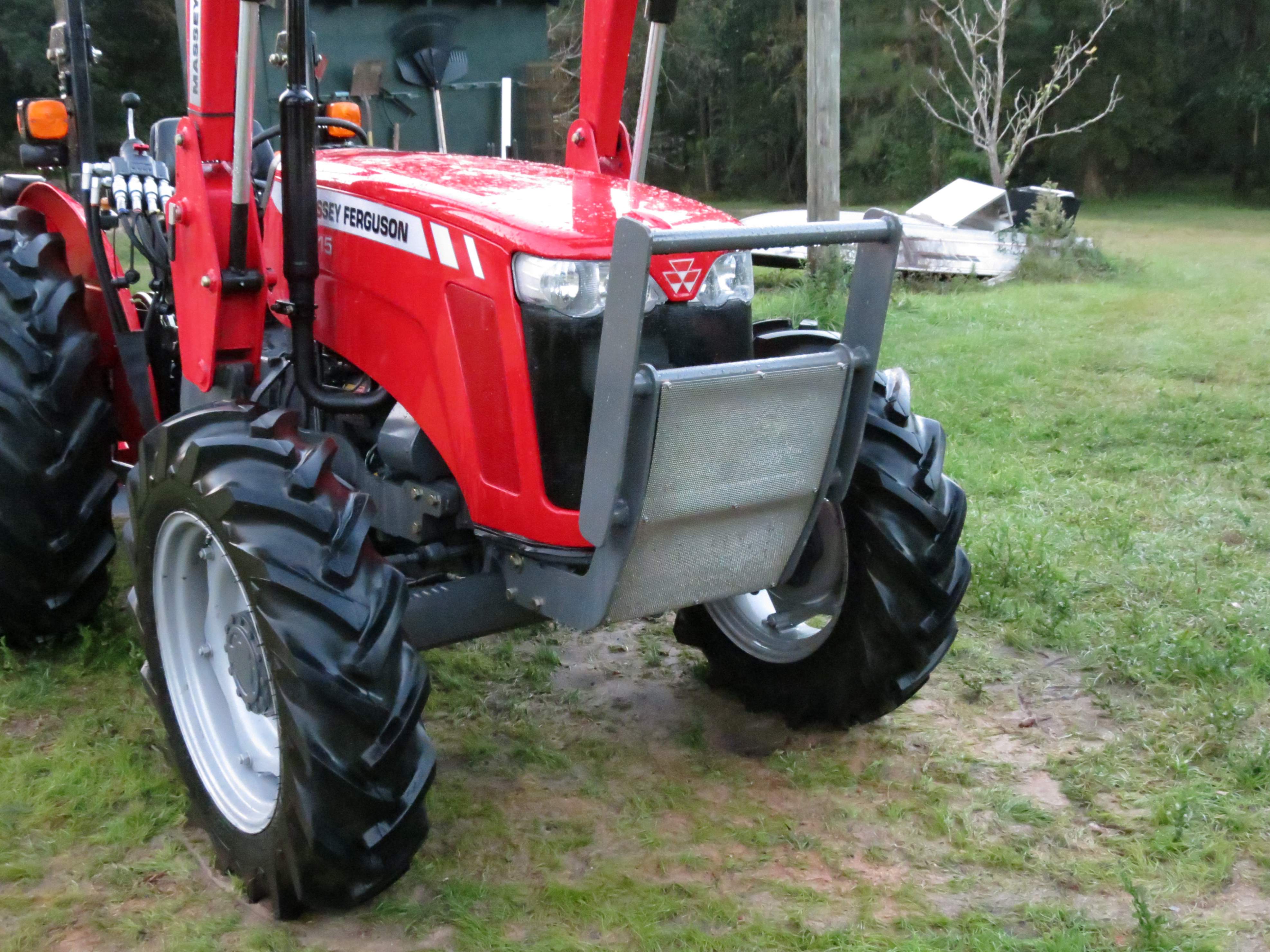

/ A grappling decision
here you go. I just added to the factory guard where i thought it was lacking. the perforated 11 gauge stainless does keep the grille clean.
before stainless and paint
Also added a mounting bolt to both sides just had to drill the 11/16 holes

/ A grappling decision #6
Looks good!
/ A grappling decision #9
Nice job on the grill guard,should have done mine before I busted my lower grill and battery.
/ A grappling decision #10
Yes, I'll need to do the same thing. Punched a small hole in the black plastic vent in the front of mine. No significant damage, but it will probably happen again unless I do something to prevent it.

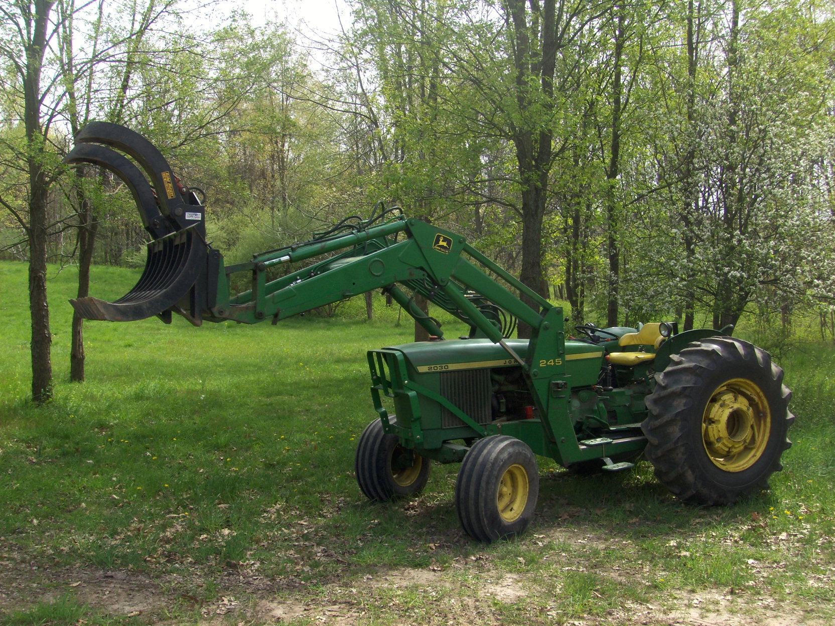

I also have a Rake Master! Glad to hear they are still in business. I bought mine used. It came with skid steer mounting plate that I modifiied to work with my JD 245 loader quick attach. Mine is very heavy duty. I plan to redo the mounts so I can use it on my JD 6415's JD 640 loader. (Did not have the JD6415 when I bought the grapple)
