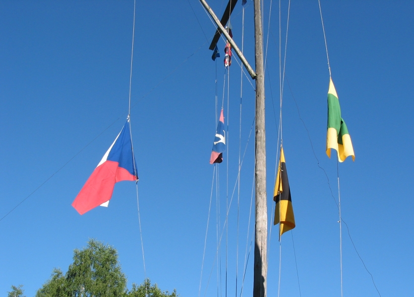

We done it for boy scouts every summer. It was little bit more complicated, since we were "Marine" scouts - it is a copy of a mast. But we used straight fraizer fir for it.

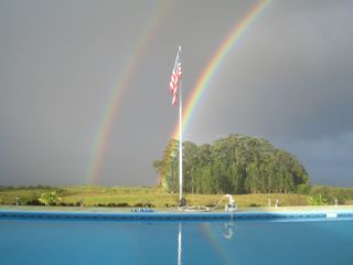

Not wood, but you might consider this for the Maine place.
I fly mine 24/7 (lighted) and like that fact that I can raise or lower according to wind conditions. It would also be very easy to remove when you aren't there.
