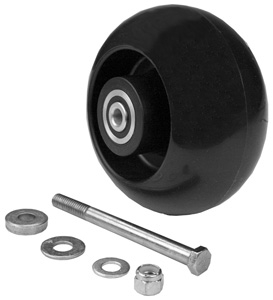

Regarding the hard plastic rear wheels.....what has been done to replace those with something that doesn't dig up the soft ground as much? Maybe rubber wheel that takes air?
Has anybody come up with a quicker way to adjust the rear wheel height? When I cut pasture I raise my deck to avoid hitting hidden rock or branches and while it's not a big time consuming task I wonder if somebody came up with a quicker way to do this?
/ A few finish mower questions #3
For the hard plastic wheels, you could look into the rounded type. E.g.
Or convert them to a caster wheel, which would be more costly and difficult, but could be done.

I just got my 10% off coupon from TSC and I'll be looking for wheels like that when I make my next trip. The caster wheel option crossed my mind but will the deck move properly since the front wheels are also casters?

Oops... missed your question about the deck moving properly with casters.... I think so. You could make the argument it would put less "stress" on the quick connect plate and lift arms if done correctly.
/ A few finish mower questions #7
Make sure there's enough room without the casters coming in contact with the front tires.
I replaced the plastic rear wheels on my 48" brushcutter with semi-pneumatic tires on metal hubs with grease zerks. Having upsized my PT's tires to 26x12x12, the rear wheels of the brushcutter will now occasionally contact the front tires when the brushcutter is lifted in the air. There's about 2" of clearance when the brushcutter is down on the ground... I don't consider the contact when lifted to be an issue, but I'm also not using swivel casters which take up more room.

Kevin, I like the look of that wheel...where did you find it? TSC had some nice rubber wheels that probably would be an upgrade but they were expensive at over $30 each.

I just did a quick search on google for "mower deck wheel" and looked at the results for the rounded ones. I don't recall how large the OEM PT wheels were, but I'd think you'd want to get a similar diameter to allow of the same amount of height adjustment. Probably doesn't need to be perfect. If you always mow at a certain height, you might be able to go a bit smaller and just move it down the bracket to make up for the size difference.
Might be able to find some cheap on ebay too. Lawn Mower Deck Wheels | eBay
/ A few finish mower questions #12
I was at Boeing surplus and found a pair of casters for $5, made of aluminum with a tire of some kind of plastic. They were rated for 500lb each and have needle bearings with grease fittings. They have lasted very well.

I got replacement wheels at Grainger.com. large assortment and they have roller bearings. 2 years now and work great.
