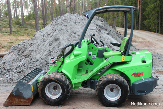

The problem is getting the power block out of sight. I'm installing on a pretty strange thing, there isn't any room in the cab or front of me. The monitor has got to be on the FOPS in front up high and the power connector has no place to go. kuormaajat-avant-1181395_b_a084fc24d210916a.jpg
All the power comes from the other side of the steering wheel. I'd like to make all the connections under the panel and run a single wire to the screen.

The problem is getting the power block out of sight. I'm installing on a pretty strange thing, there isn't any room in the cab or front of me. The monitor has got to be on the FOPS in front up high and the power connector has no place to go.View attachment 420085
Now I understand. Maybe try a locally owned Radio Shack. Or search online.

I think you should just look for some cable with the necessary number of conductors of appropriate gauge (most likely 22-24). Either splice into the existing harness, or look for the connectors on Digikey/Mouser/MCM and make an extension. From what I have seen of the connectors used in these cheap cameras and screens, they may not be typical stock items, so splicing into the existing harness might be the best bet.

Belden makes a wide assortment of multiconductor wire looms. Find a wholesale electric supplier and you'll find what you need.

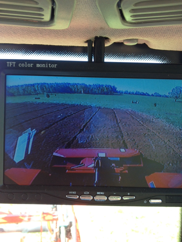

Here is a pic of the rear camera late in the evening, the cam is in the cab looking through the glass and gets a bit of glare when sun is shining just right into the camera. But over all think it's going to work out good. Will see how the front cam works with bucket and forks next day or so.
/ A backup camera for $50!!!!!!!!!!! #330
I definitely need the camera on the loader. Picking up something at ground-level with the forks, or even attaching most quick-attach attachments, is a pain in the ***.
