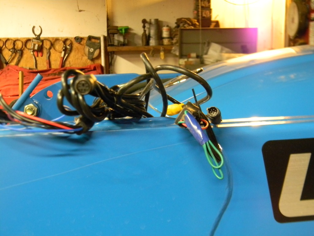

Anybody happen to have a busted Pyle PLMRM72B monitor? I managed to misplace the cable & need a replacement. It's the cable with the 8-10 pins that attaches to the pigtail off the monitor & goes out to the cable with the small barrel plugs on it for the cameras.
I wonder if it is an S video cable?

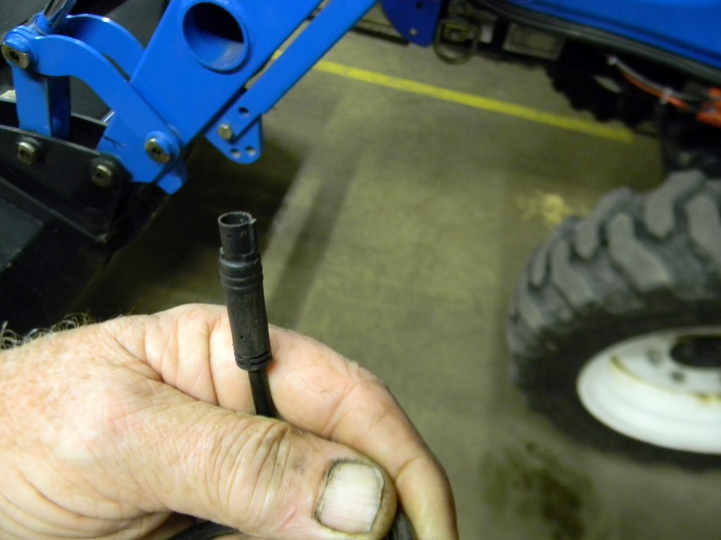

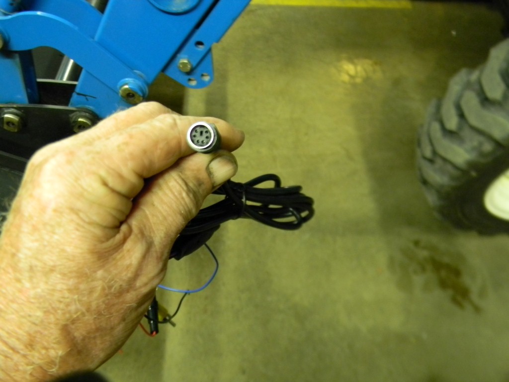

I've attached some pics of 2 cables I have. In the pic showing both cables the 1 on left has metal and the right is an all plastic plug with a notch on one side. Is yours like either one.
I don't think that's what I'm looking for, I see a Svideo connector there, which I don't have. I found the manual Pyle - PLMRM72B - Marine and Waterproof - Marine Video & the piece I need is labeled "Option 1". It has 3 4 pin plugs with a retaining nut on it (Pyle's webpage actually tells you to go get http://www.amazon.com/Waterproof-Fe...=1426525444&sr=8-7&keywords=4pin+camera+cable if you need to connect to those plugs, but I have that part, need the bit between it & the camera).
After doing some quick math (1 line for audio, 1 for video + 1 reverse sensing wire * 3) + 1 power + 1 ground = 13ish total pins in the plug that connects to the monitor.
I'll go try & grab a photo, but the plug is buried under the dash & not sure if I can get a decent photo without pulling it apart. I put a pull string on it so I can get to it by feel if I find the missing cable, or get a replacement. Not sure if I'll be able to get a photo though.

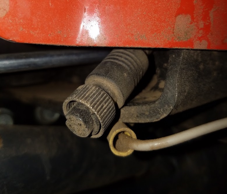

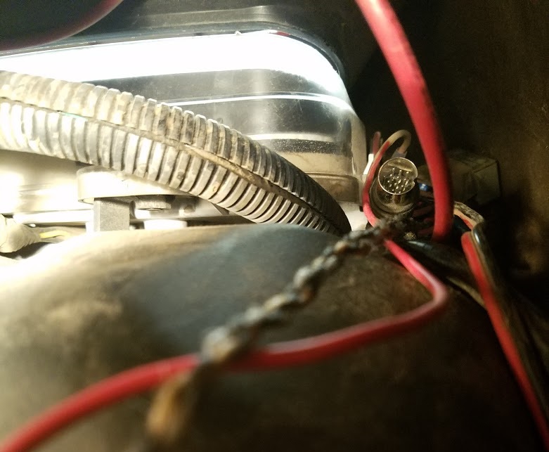

/ A backup camera for $50!!!!!!!!!!! #414
Ok, here are the 2 parts (4 if you count the spade connectors for power & ground) that I need to hook up to. The big one is around thumb sized, the small dusty 4 pin one is pinky sized.

I looked up the manual in the link you posted. The top of page 2 (option 1/2 page) shows it is a 7" TFT monitor. 7" TFT monitor is what I have. In fact, I have 2 TFT identical monitors and both came with different plugs on them that are not interchangeable. Yours is a 3rd different plug from the 2 I have. Sorry I couldn't help.
/ A backup camera for $50!!!!!!!!!!! #416
No worries, thanks for the help. I pinged Pyle on this too.
/ A backup camera for $50!!!!!!!!!!! #417
Midnight epiphany! I was using a different tool bag when I was troubleshooting what turned out to be a bad ground a while back. After looking for that dam cable for the past month, finally found it.
