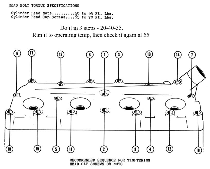

After cleaning them up, should 9N head bolts be installed dry, oiled, or anti siezed? Proper torque?
Thanks,
Knots
/ 9n Rebuild #2
I installed mine dry. This chart will show the torque setting and tightening sequence to use. After you put some hours on the engine, go back and check the setting for each head bolt
