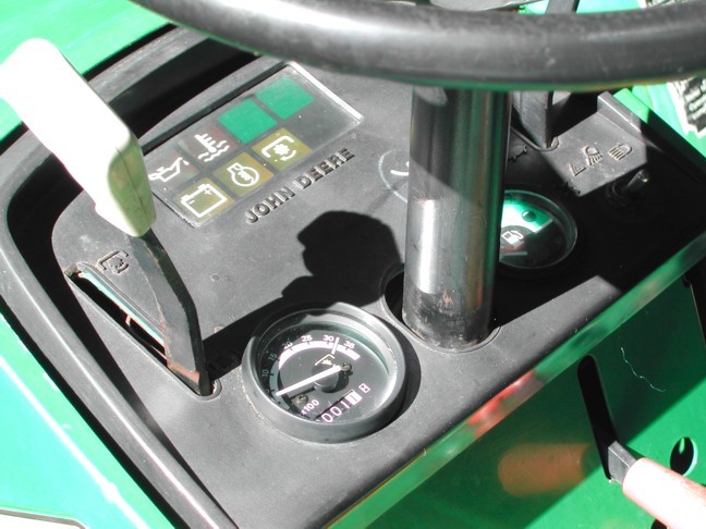

That's a very good question! I wish I knew.
I have had 4 955s, and 3 I extensively rebuilt. I never got the steering
wheels off, despite several attempts. I decided to work around the
attached wheels. On other tractors, like my JD 4300, it was no problem
getting the wheel off.
In this photo, you can see that the column goes thru the instrument
bezel and there are no good purchase points. The pullers I have did not
do the job....I did not want to damage the wheel.
If you get the wheel off, report it here. Good luck.
