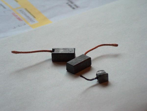

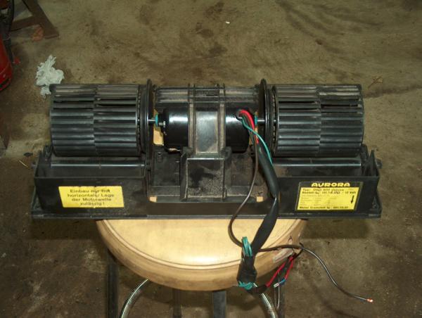

The fan that blows clean air into the cabin of my combine stopped. I phoned the dealer, could have a new one in two days, wise from earlier mistakes I asked the price, 900$ for a complete fan, it was not repairable, no rep set.
I am not that rich, so I took the old one apart, the brushes were worn out.
I bought new pair of standard brushes, had to adjust the seize with a sandpaper, and put the whole thing together, 886 dollars saved! It took me 4 hours, but still-

/ 900$ saved #2
Good Golly!
They must think you are not so smart! Good job on a cheap fix. Keep your $$ in your pocket where it belongs.

1948berg
Over on this side of the pond we have Automotive electrical repair shops that do starters and alternators they also do fans and and electric window repairs.
Alot of the regular repair shops pull the "odd" stuff off send it to these guys and they rebuild it.
An industrial motor shop could do it too but it is probibly a little small for them
but most likely cheeper than your new price.
usually they put new bearings in them too and clean up the communicator.
