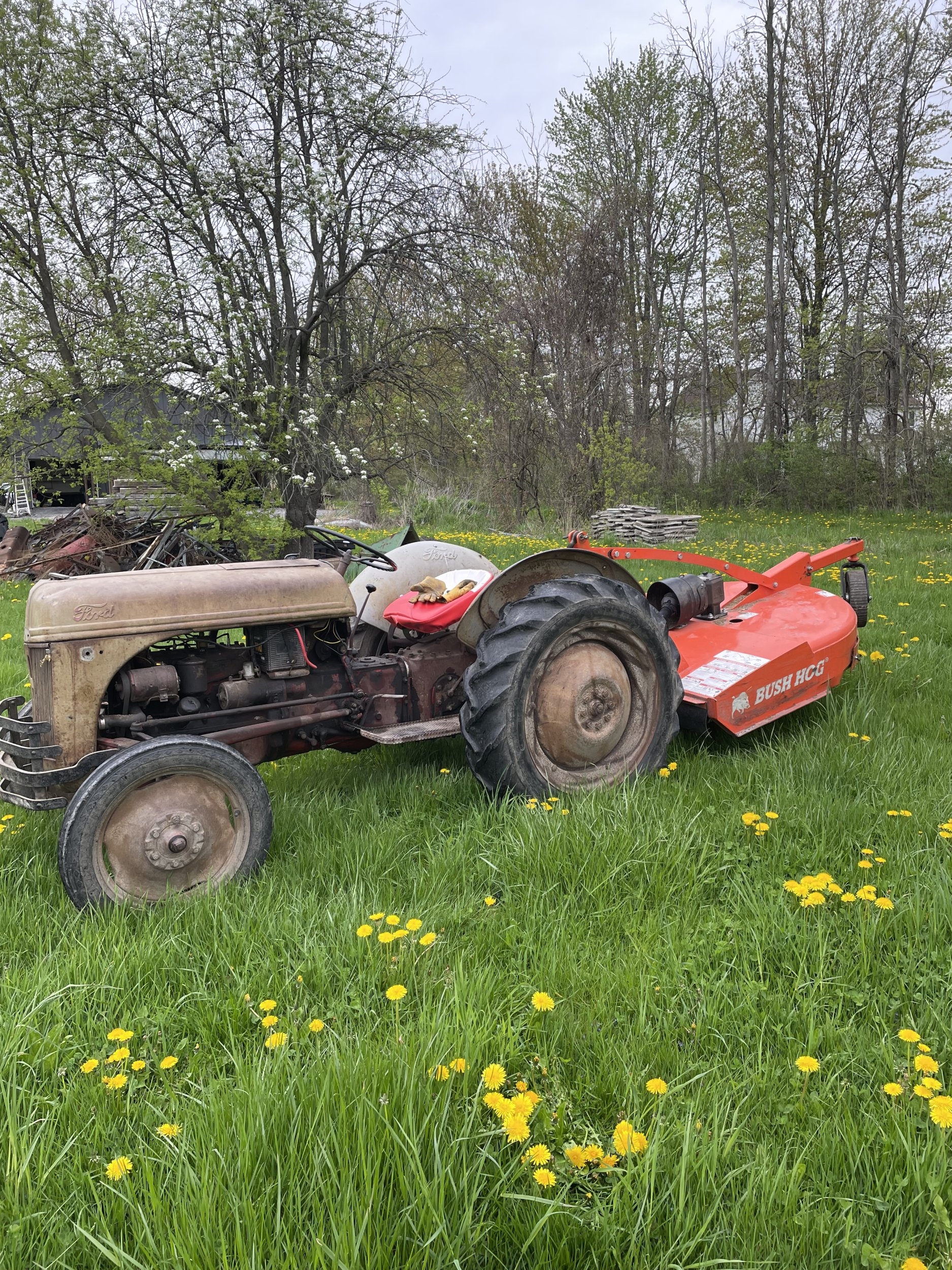

I’m with you there for sure. Also, now that gasoline is so much cheaper than diesel, the economy advantage once had by that fuel, is largely eliminated. I’m doing and planning to do a lot more work with my (2) antiques this year for that reason.
My favorite thing about that Cub, is that at fits in the 8 ft box of my 3/4 ton pickup. Soon, I will be hauling it over to my parents place, 20 miles away, so that it can take some of the load off of my dads little modern diesel CUT.
My Ford 8n can handle most of the work at our place. Maybe I’ll pick up an over running coupler for it so that I can use it on my 5 ft Bush hog. That way, I’d be free to unload my modern diesel if I wanted to.
The 8n couldn’t quite lift the light duty 6 ft Rhino rotary cutter that I had prior, but it has no trouble lifting the 5 ft medium duty Bush hog that I replaced that with after it wore out.

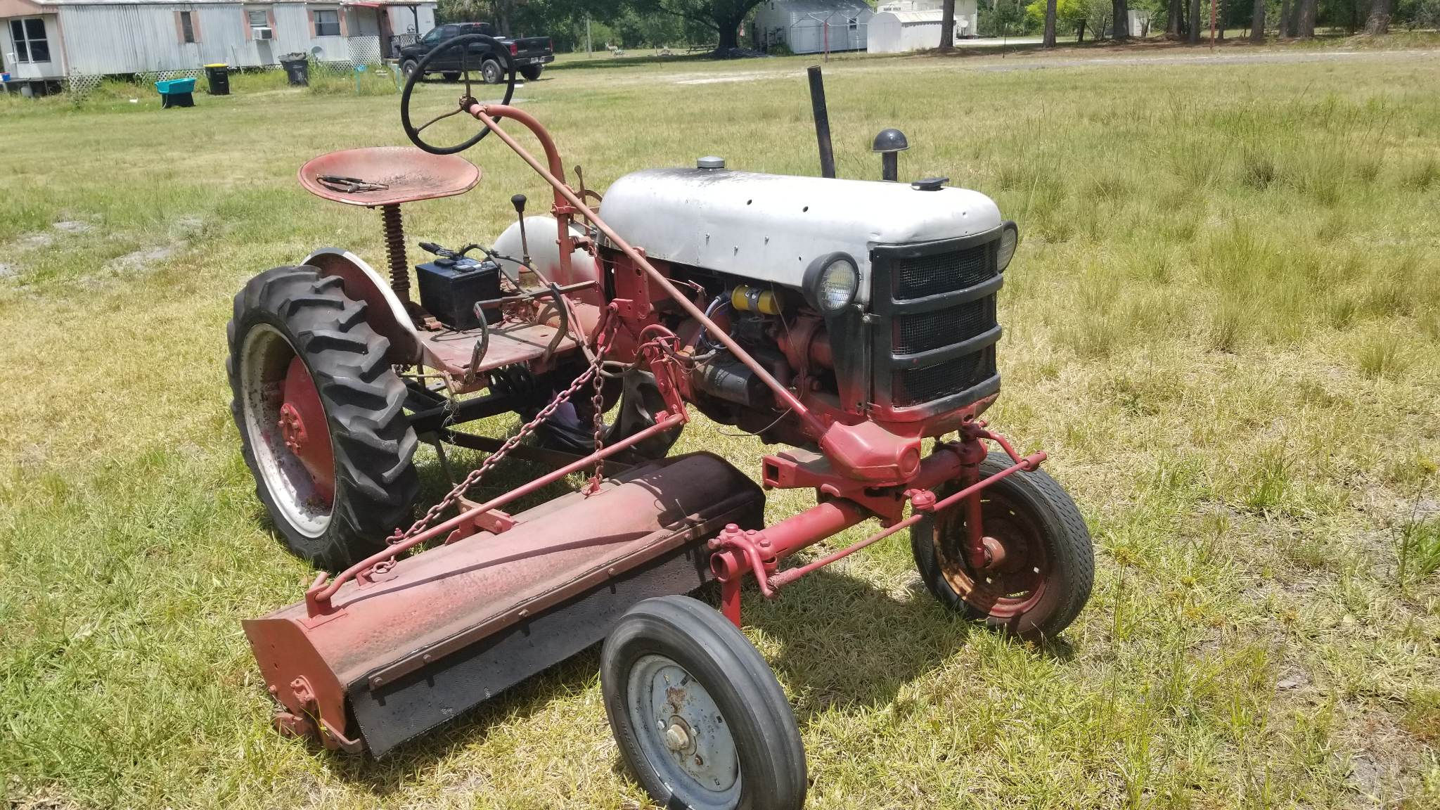

Love the farmall.
I would never use one, but I love how they look. I've been trying to find a dead one to use for decoration along my driveway but every time I see one it runs. My son just sold one with the mower deck under it. It is something to see. The mower is even more offset then the tractor. Yours is a lot nicer then his was lol

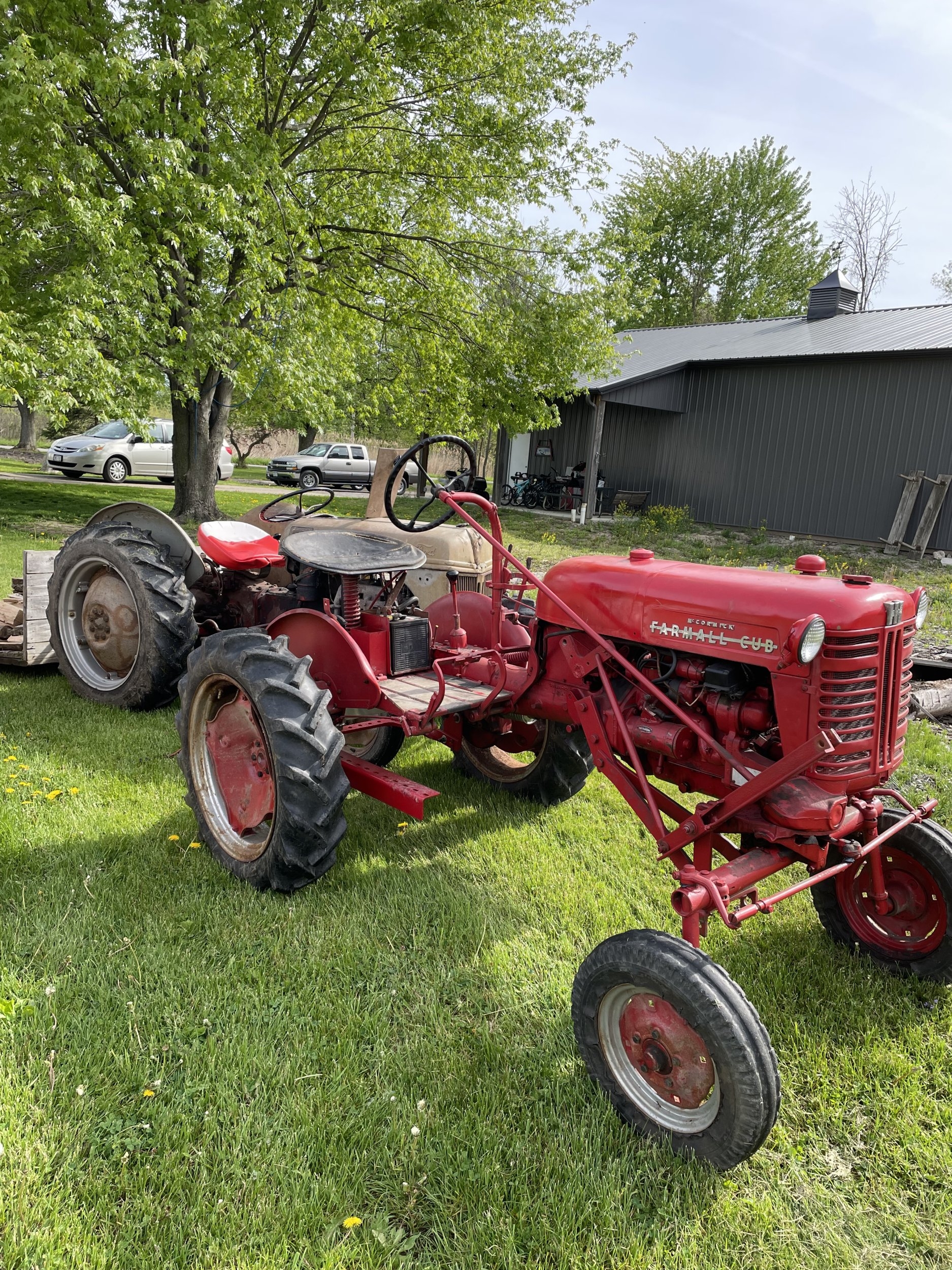

That’s the second Farmall Cub I have had. I swore I’d never buy another red tractor after all of the trouble I had with the first one. The main problem with the first one, was that it was well beyond completely worn out, when I got it.
The first one came with cultivators. I always thought the offset “cultivation” concept was neat, but I hated it after I had it. I had previously cultivated corn, with the single row unit mounted on my grandads John Deere model M.
That was the first tractor on our farm, which he bought new to replace a team of horses back in 1950. My dad moved to a larger farm, about 20 miles away, around 1990, and he took it with him.
I got a stiff neck, bending over while cultivating with the Cub, and I had to go much slower. With the JD, I could keep my head up, sight down the row, and open up the throttle.
I sold that first Cub about (5) years ago, and replaced it with a Dearborn 3-point 2-row cultivator that I use behind my Ford 8n. I traded a guy a Cub snowplow for that, that was given to me by my father in law.
I did miss snow plowing light snowfalls with the Cub. The offset engine “cultivision” was great for that. The one I have now sat in the back of the factory where I work, unused, for about 20 years. It had a snowplow with it. They had a silent auction for it last fall. I bid $ 783.17 for it and was high bid.
I dropped it off at my favorite Farmall mechanic’s shop on my way home (borrowed his trailer). He changed all the fluids, got it running like a watch, and charged me $ 450. I spent another $ 200 on a drawbar for it. It probably has less than 500 hours on it. Not bad for under $ 1500.

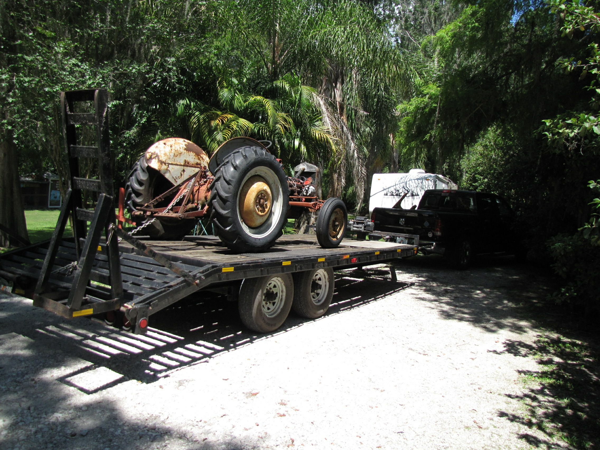

So. It happened. I went and got another one. Surprisingly it runs, but then it is an n model.
Hood's in the back of the truck. Had to clean the carb and replace the starter gear.
And now it purrs like a kitten.
Although the clutch is stuck to the flywheel so I'm gonna have to split it to break it loose. I always hear about ways to break them loose but I've never had much luck other then go ahead and take it apart.
Not sure what they got going on with the way the 3 pt is rigged up but it does still work.

Those are just bars to keep the three point lower arm’s from moving up or down to keep the draw bar in a fixed position.
We always used them to pull our hay rake.
Getting a center draw bar that mounts below the PTO / rear axle eliminates the need for those bars.
