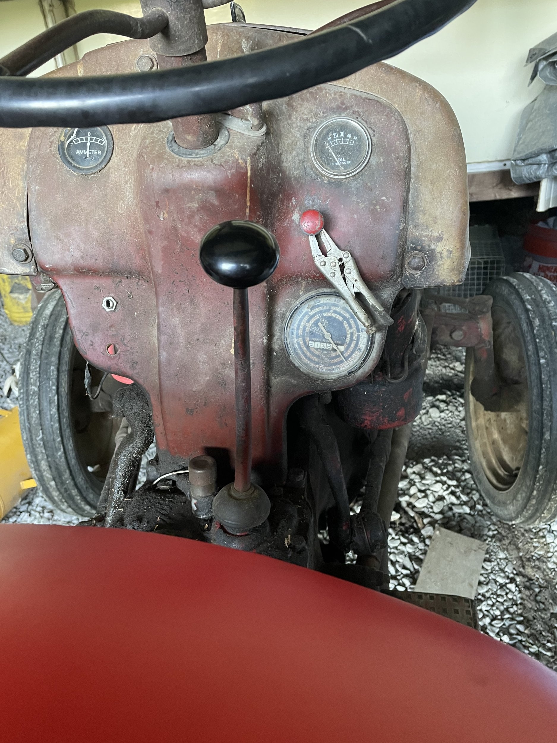

I had a little trouble with a valve on my 8n when I first bought it, back around 1989. I bought it from the widow of the original owner. It only had 1200 hours on it, but it didn’t have any compression on one cylinder, due to that broken valve.
After replacing just that one, it was ok for a couple years of relatively light usage. A couple years later, I wore out a few more valves, while digging a pond with a 3-point scoop.
The trouble was, those original valves didn’t hold up very well on unleaded gas. A very good mechanic buddy of mine did a complete valve job, with with all new parts, and that that tractor has ran great ever since. With 2200 hours on it now, it still has enough compression to start good on just 5 volts. That’s all I can get the 18 year old 6 volt battery, that’s in it now, charged up to.
The original proof meter cable snapped on it at about 1800 hours, and I put a few hours on it before I got it replaced.
The hanging needle nose vise grip holds the choke slightly closed. It’s needed that, ever since I replaced the original carb with an aftermarket one.
I replaced a few other parts on it over the years including the gas tank (original had a slow leak), the radiator (I put a branch thru that while snow plowing), the distributor (I didn’t oil that every 10 hours like it calls for on the manual), and a rear rim (calcium rusted that thru 2 years ago). The tires and paint are original.

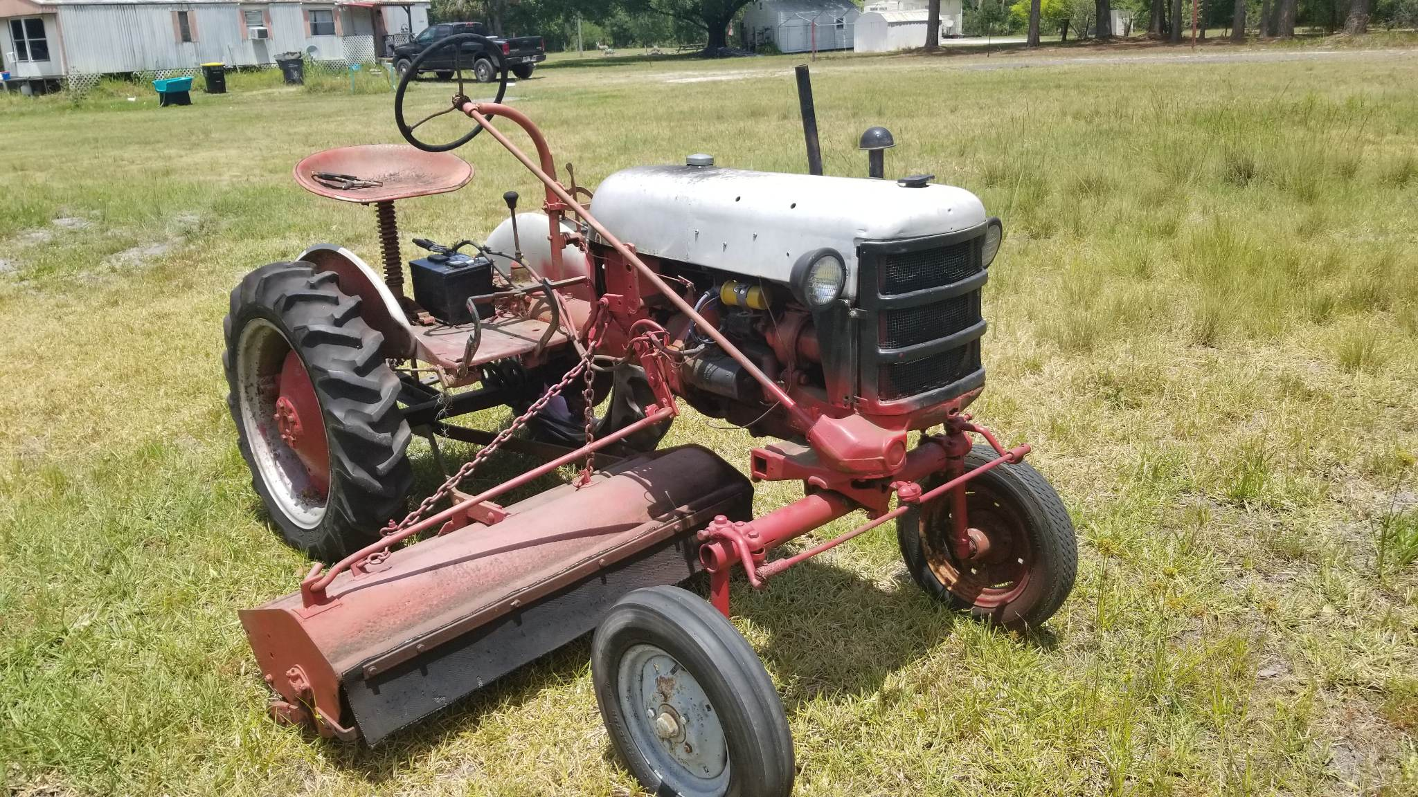

Here's the 2 I actually consider my tractors. The rest are just passing through.
The red one is my go to. It's a to30. It's knocked and smoked for years but bit just doesn't quit. The battery in it is a tiny old battery that came out of my wifes wheel chair the last time I replaced the batteries in it. It's been in there 3 years and still starts it. It only has enough charge to turn it about 5 times but it never turns over more then once or twice, It's got no hood and theres a hole in the top of the radiator, but as long as I put water in it before using it, it does just fine. I need to fix the radiator. It's brand new. I put it in and a week later I poked a hole in it while pushing brush. I really need to put something in front of it to protect it because I'm not going to quit misusing it. The backhoe rides sideways because a tree fell on it and bent the bers that come out from the 3pt but it works fine. When the outriggers are down it sits level.
This one is weird with gas. It will run perfect till its out and when it's out it is completely out. It wont even try till you put more gas in it.
It's old and delapidated but its a really tough tractor that just keeps going

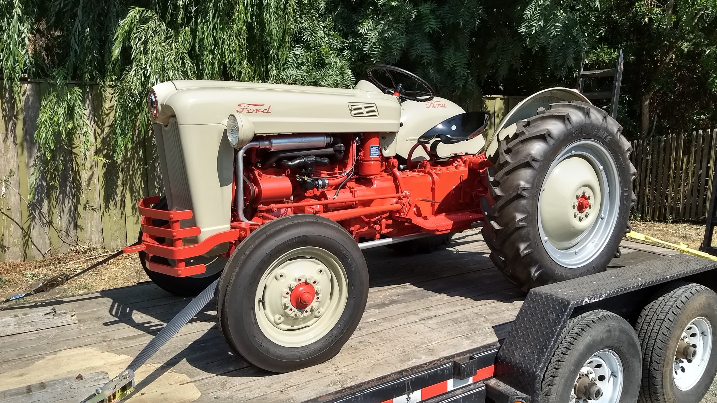

Jubilee before and after
4500 before and after. This one needed a starter, riiiggghhht. Every time someone says it needs a starter this one comes to mind, and often needs a starter means the motors froze up
Another 8n, but just an after pic
And that's all the pics I could find

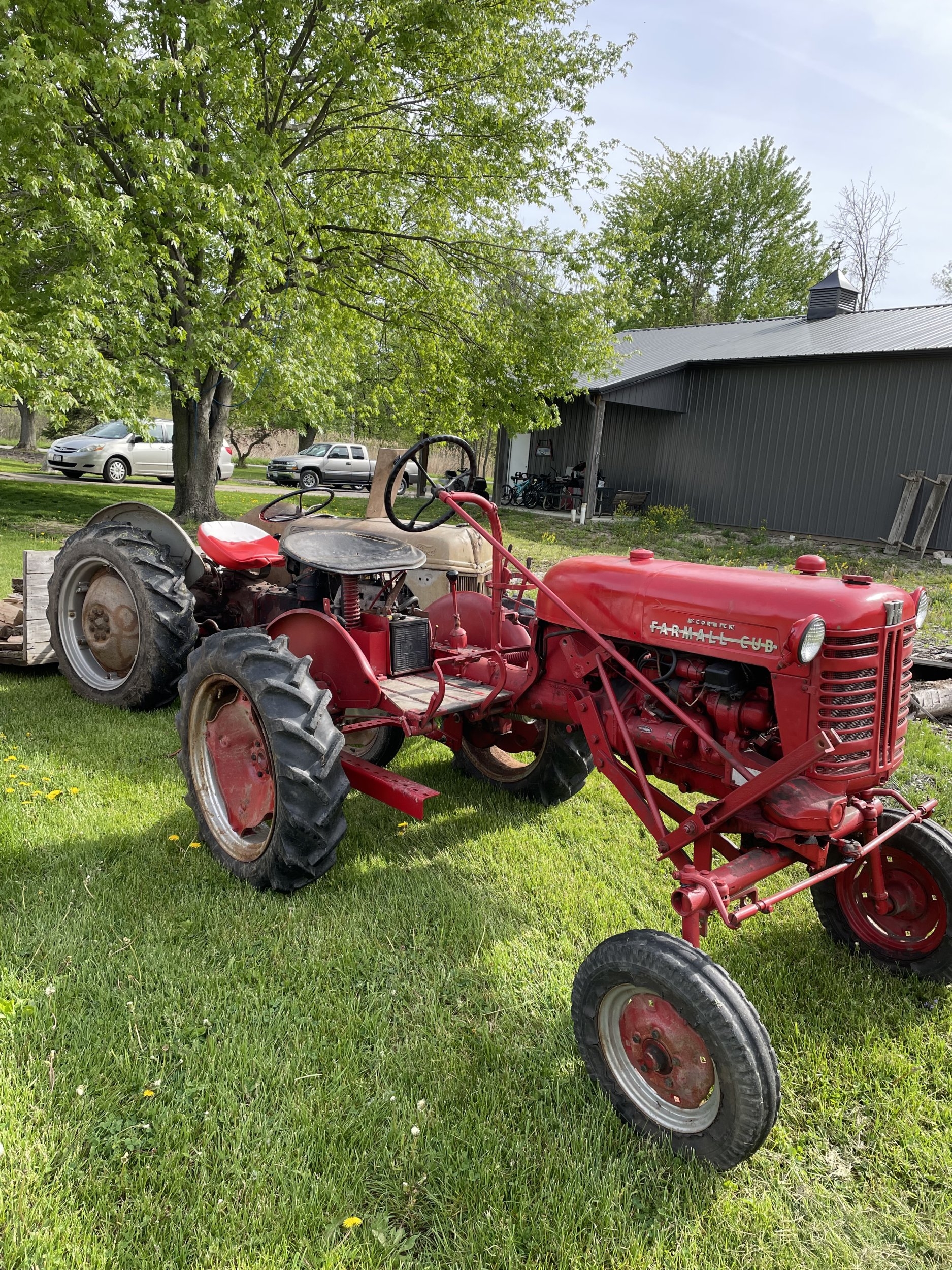

I’m with you there for sure. Also, now that gasoline is so much cheaper than diesel, the economy advantage once had by that fuel, is largely eliminated. I’m doing and planning to do a lot more work with my (2) antiques this year for that reason.
My favorite thing about that Cub, is that at fits in the 8 ft box of my 3/4 ton pickup. Soon, I will be hauling it over to my parents place, 20 miles away, so that it can take some of the load off of my dads little modern diesel CUT.
My Ford 8n can handle most of the work at our place. Maybe I’ll pick up an over running coupler for it so that I can use it on my 5 ft Bush hog. That way, I’d be free to unload my modern diesel if I wanted to.
The 8n couldn’t quite lift the light duty 6 ft Rhino rotary cutter that I had prior, but it has no trouble lifting the 5 ft medium duty Bush hog that I replaced that with after it wore out.

That’s the second Farmall Cub I have had. I swore I’d never buy another red tractor after all of the trouble I had with the first one. The main problem with the first one, was that it was well beyond completely worn out, when I got it.
The first one came with cultivators. I always thought the offset “cultivation” concept was neat, but I hated it after I had it. I had previously cultivated corn, with the single row unit mounted on my grandads John Deere model M.
That was the first tractor on our farm, which he bought new to replace a team of horses back in 1950. My dad moved to a larger farm, about 20 miles away, around 1990, and he took it with him.
I got a stiff neck, bending over while cultivating with the Cub, and I had to go much slower. With the JD, I could keep my head up, sight down the row, and open up the throttle.
I sold that first Cub about (5) years ago, and replaced it with a Dearborn 3-point 2-row cultivator that I use behind my Ford 8n. I traded a guy a Cub snowplow for that, that was given to me by my father in law.
I did miss snow plowing light snowfalls with the Cub. The offset engine “cultivision” was great for that. The one I have now sat in the back of the factory where I work, unused, for about 20 years. It had a snowplow with it. They had a silent auction for it last fall. I bid $ 783.17 for it and was high bid.
I dropped it off at my favorite Farmall mechanic’s shop on my way home (borrowed his trailer). He changed all the fluids, got it running like a watch, and charged me $ 450. I spent another $ 200 on a drawbar for it. It probably has less than 500 hours on it. Not bad for under $ 1500.

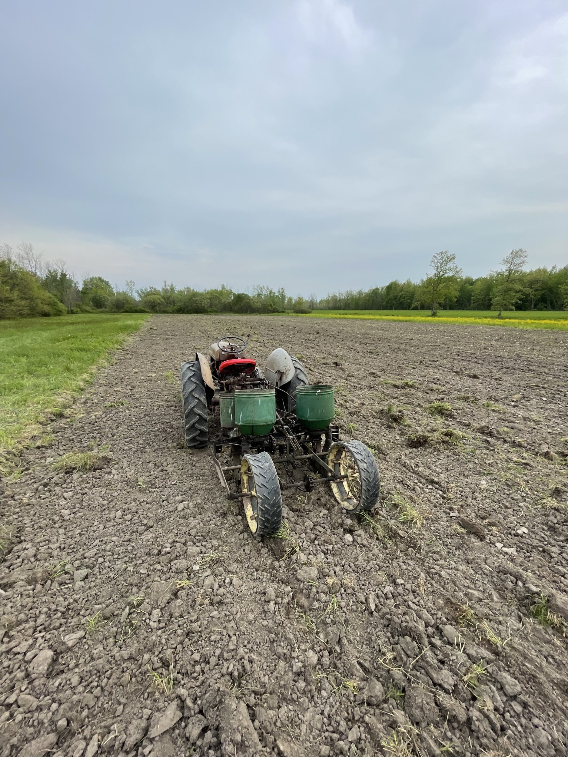

That is a very big part of the reason, why there is no modern tractor that I would rather have on my 2-row corn planter, than my 1951 Ford 8n.
That old planter is a little temperamental, and prone to throwing a chain now and then. I can easily hear that happen, over the quiet purr of the little flat head 4 cylinder gas engine.
It’s a different story, when it’s hooked on the back of my modern, turbo-charged 4wd diesel tractor. I use hearing protection, whenever I run that one above low idle, and I can’t recognize any equipment noise over the sound of that engine even when it’s at low idle.
Another huge advantage of the N, is the low operator platform and ease of getting on or off, from either side. I plant several varieties of sweetcorn, and am usually dealing with small quantities of rather expensive seed. It’s great not to have one side of the platform blocked by a loader joystick. With the N, it’s real easy to hop on or off and add seed to the hoppers. Not so with any other tractor I’ve had that planter on.
I’m my humble opinion, every step taken since 1952, when it comes to the 3 point hitch ease of use, has been a step backwards. Harry Ferguson and Henry Ford teamed up to make it profitable back in 1939. They had it perfected in 1948. “Others” have been screwing it up ever since.

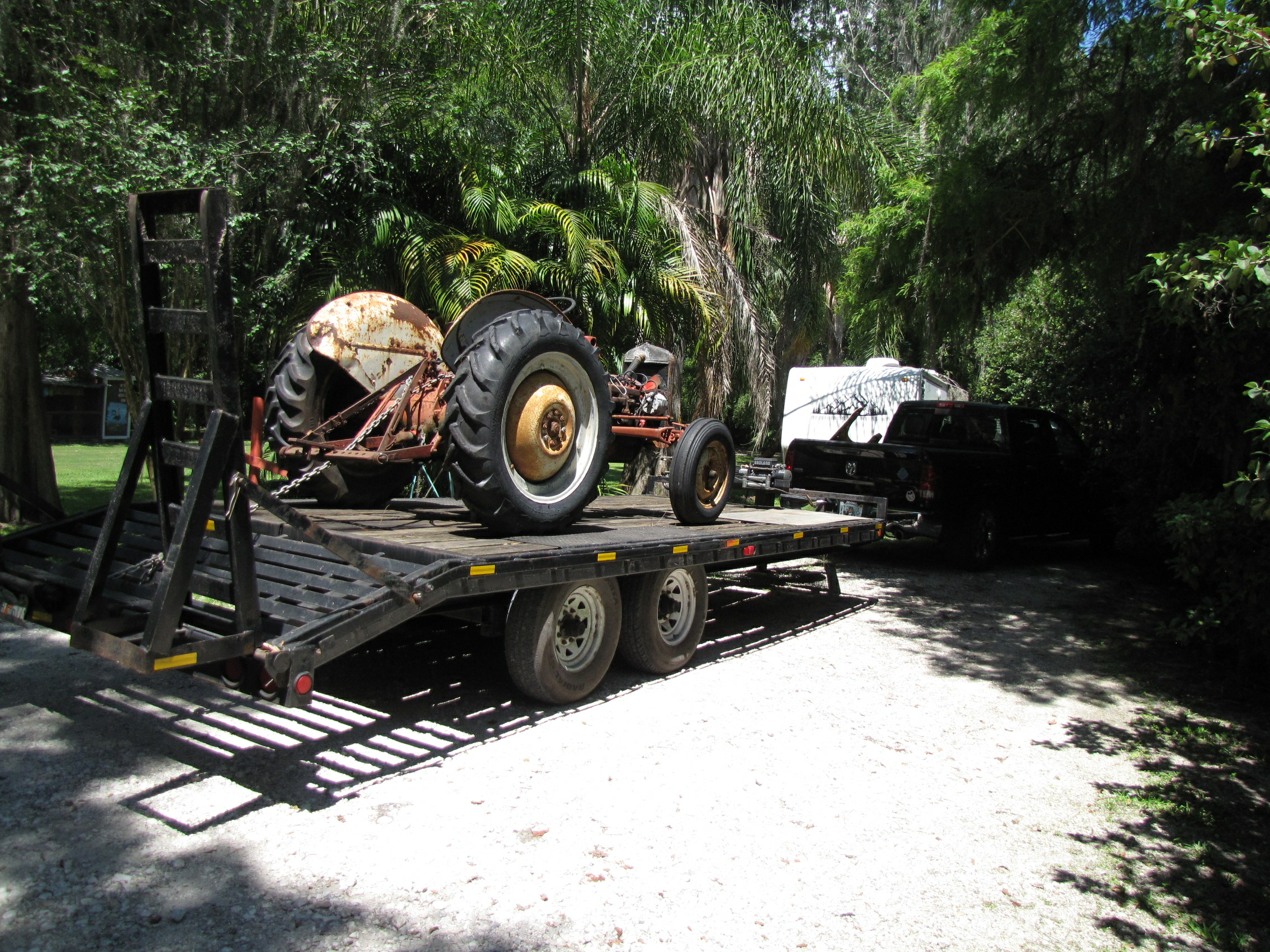

So. It happened. I went and got another one. Surprisingly it runs, but then it is an n model.
Hood's in the back of the truck. Had to clean the carb and replace the starter gear.
And now it purrs like a kitten.
Although the clutch is stuck to the flywheel so I'm gonna have to split it to break it loose. I always hear about ways to break them loose but I've never had much luck other then go ahead and take it apart.
Not sure what they got going on with the way the 3 pt is rigged up but it does still work.

Those are just bars to keep the three point lower arm’s from moving up or down to keep the draw bar in a fixed position.
We always used them to pull our hay rake.
Getting a center draw bar that mounts below the PTO / rear axle eliminates the need for those bars.
