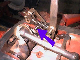

Once you get the cover off, replacing the piston/cylinder and cam follower pin are often the only parts you need to replace. Look for any other parts that look broken or not right. The former owner clearly abused the draft control system, so you may find some linkage damage. After that, it comes down to making the proper adjustments for both the draft and position control functions. That's why I pointed out the jig for this. You can buy it, use it, and then sell it on eBay and get most of your money back. I have a variation of this jig that I got years ago from Zane Sherman. I've attached the instructions for it because they have some good inside-baseball tips for this task.

I got the top cover off today, and got a good look at the internals. I disassembled the cylinder/piston, following Rachel’s video and the Ford Tractor mechanic instructions. My piston and cylinder are both very badly scoured and will need to be replaced. I didn’t see any obviously bent or broken linkages, and the cam follower pin, while worn, wasn’t as bad as I thought it would be. I’ve attached some photos below- maybe I missed something. I’ve never had an 8N apart before, so I’m learning as I go.
I tried to remove the draft control spring, but I don’t think my little handheld plumbing torch could get it hot enough to free up. I stopped trying for fear of breaking something. It’s currently soaking in some penetrating oil. Do I need to remove the spring to be sure the linkages are intact?
I’ll plan to order a master rebuild kit, along with a cam follower pin and the adjuster jig from Just8Ns.

Update: got my top cover reassembled yesterday, and everything is working like it should. I now have 32” of lift height at the end of the arms. Thanks again for sharing the Ford Tractor mechanic instructions, Ed.
