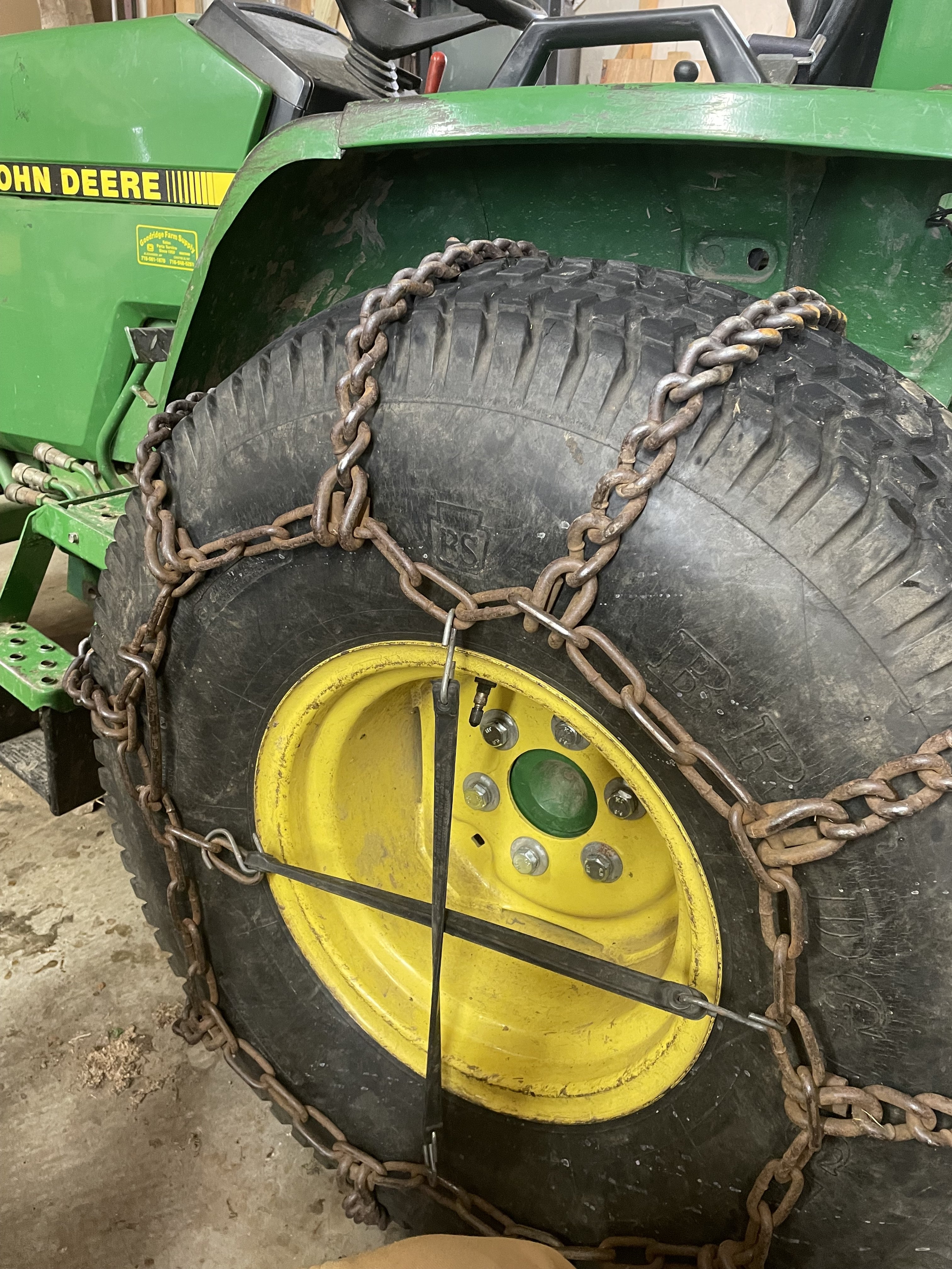

   / 80" of snow this week. #59
Nice tractor. Would he mind if you put 1"-2" spacers on the back wheels to keep the chains from rubbing ?

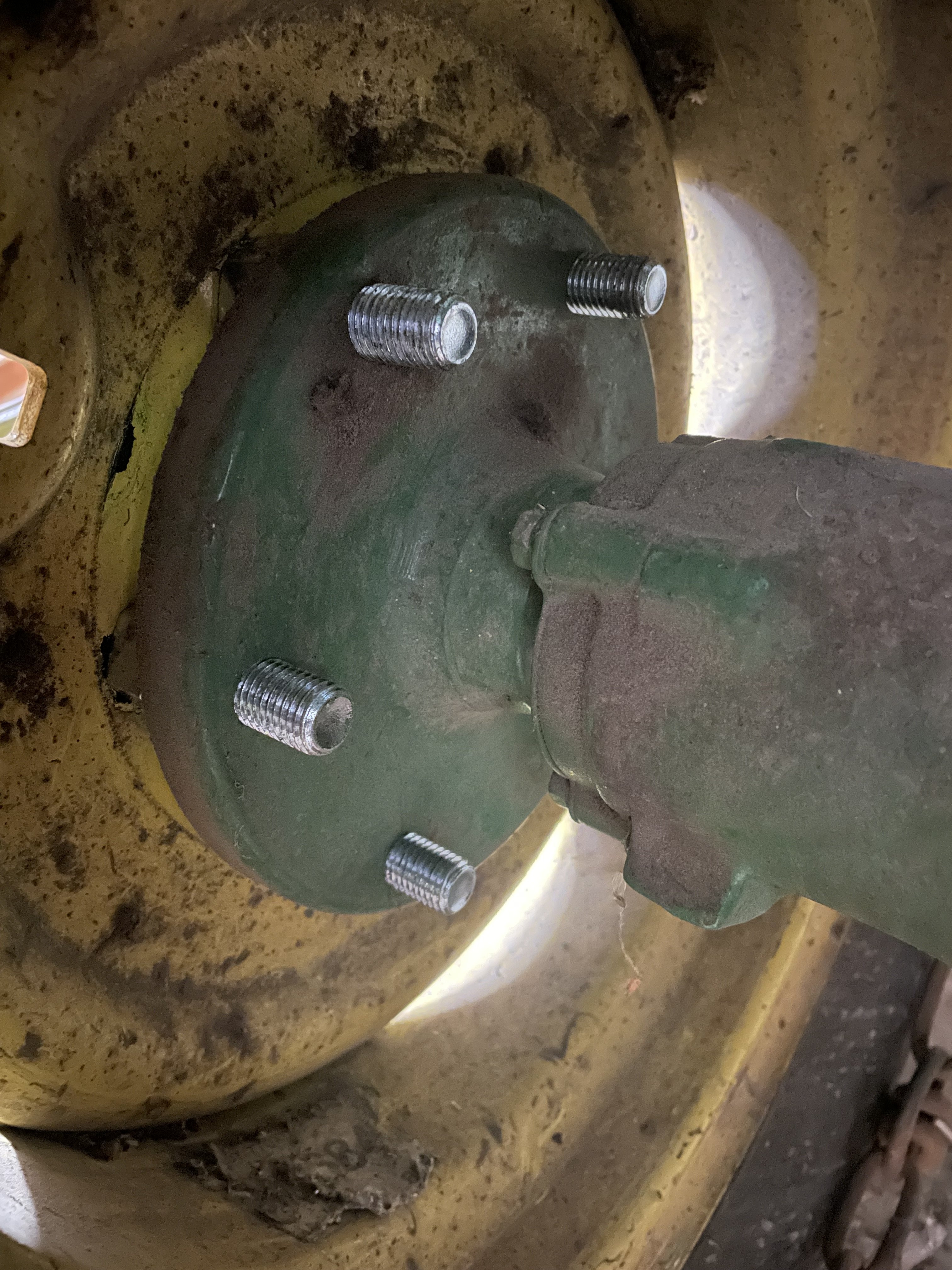

It took me a while, but I finally got the wheel spacers on dad’s JD 770 today. The lug bolt size was 16 mm x 2 mm. The shortest ones they had at the store I checked were 70 mm lg. I paid about $ 40 for 12 of those.
I used std 3/4” hex nuts as spacers, which are about 5/8” thick. That was plenty to stop the tire chain from rubbing the fender on one side and to stop the rear plow from hooking the tire chain on the opposite side. I also reused the original 16 mm lock washers and added a std 3/4” flat washer on each bolt to take up the excess non threaded length.
It was a little more than I wanted to spend but my dad gave me $ 20 towards it (that’s what I told him the bolts cost) so it wasn’t too bad. His tractor is an inch and a quarter wider now, and no more annoying chain rubbing on the fender or plow blade hooking.
I saved the original lug bolts, which were only about 25 mm long and had slightly larger hexes on the heads. The new 70 mm bolts are long enough, so that I could have fit a second 5/8” thick spacer nut on each, had I needed it. I doubt I’ll ever take them off again.

Wolc,
Does the rim sit on the pilot at all with those nuts as spacers? I would be worried about the rim moving on the bolts if not engaged on the pilot and potentially wallowing out the holes in the rim.
