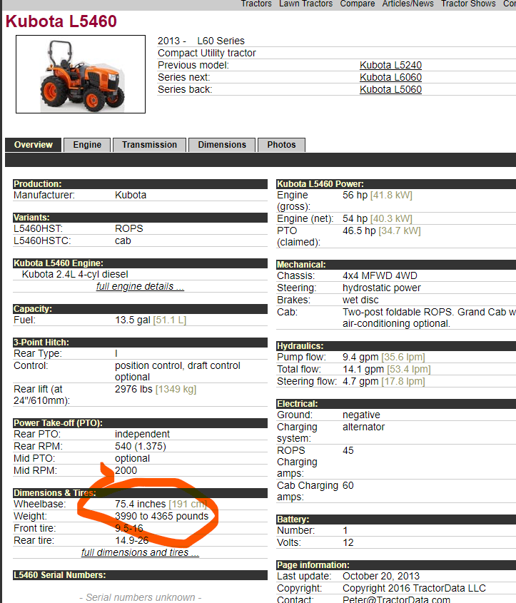

Way back at the beginning of this thread the OP stated that the 8' disc in question weighs 2,000 Lbs. That is not a light weight 8' disc.

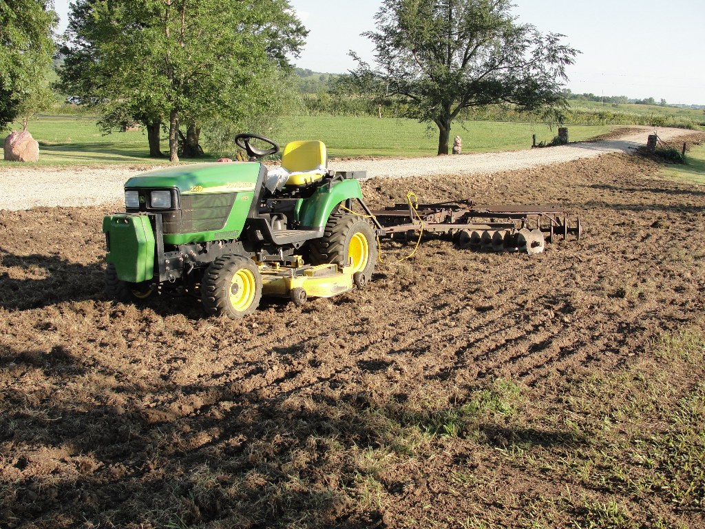

Ok here is a link to some videos I made today disking a area of my yard we're trying to reclaim.

I am dubious an open-station L5460 has enough weight to pull an 8' pull-type, 22" pans x 24 pans coming in right about 2000lbs more than one pass through a sandy field. However, all my experience has been with TPH mounted Tandem Disc Harrows.

My L3560 and your L5460 are close in bare tractor weight. I have air in L3560 rear tires, not liquid.

One thing obvious in your video and that is, you don't have the gangs splayed out at all. Crank the angle out and then report back. Discs don't disc when running parallel, they disc properly when they are angled out the more, the better.
I bet with the gangs splayed out correctly, you don't have enough arse to pull it anyway.
/ 8' pull-type disk behind L5460, possible? #55
Here's another video of my 4520 jd pulling the same disk in the same spot . Obviously the JD is about 10 more horsepower but it's also a gear drive tractor.
B range 4th gear.
