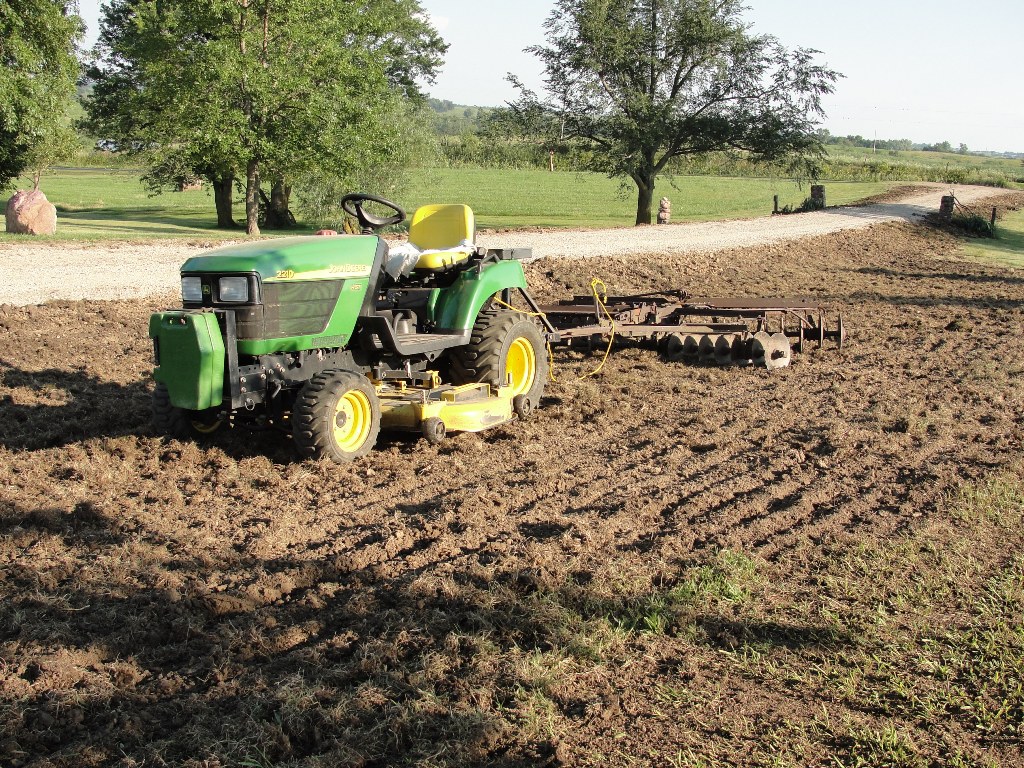

/ 8' pull-type disk behind L5460, possible? #33
Nothing wrong with it but the tires are not loaded.
SDT
That would explain a lot. Never had a tractor on the farm without loaded tires. Even my little JD in the pic has loaded rears.
